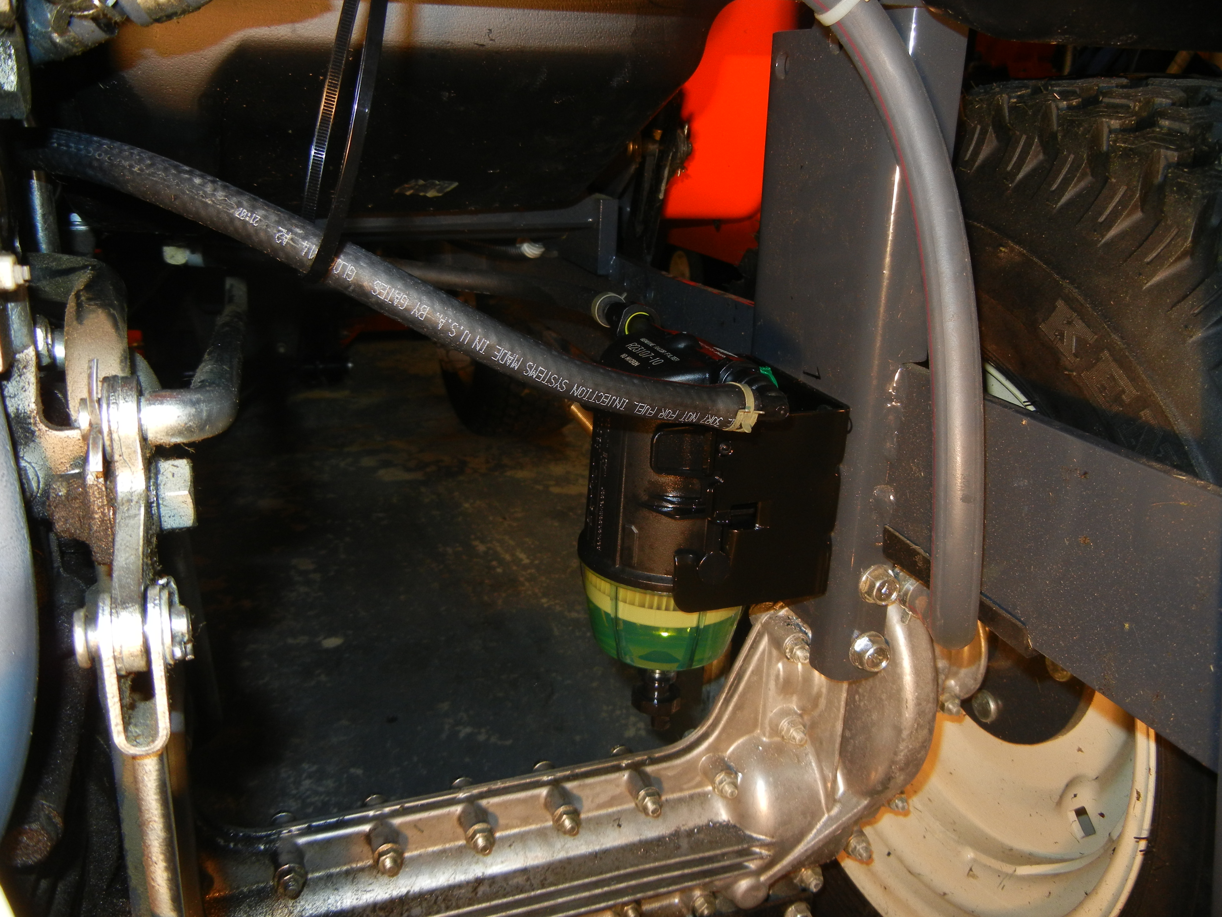

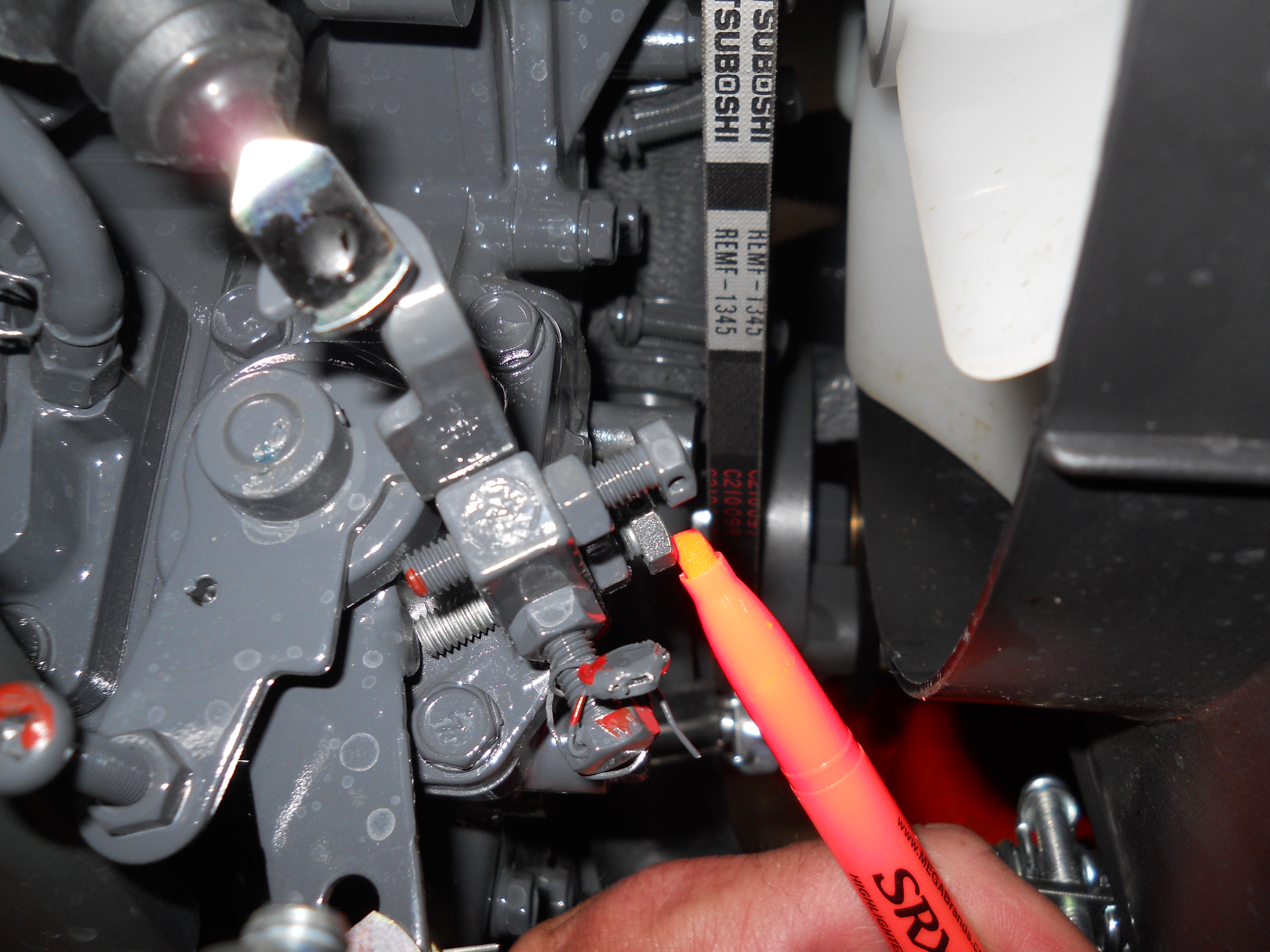

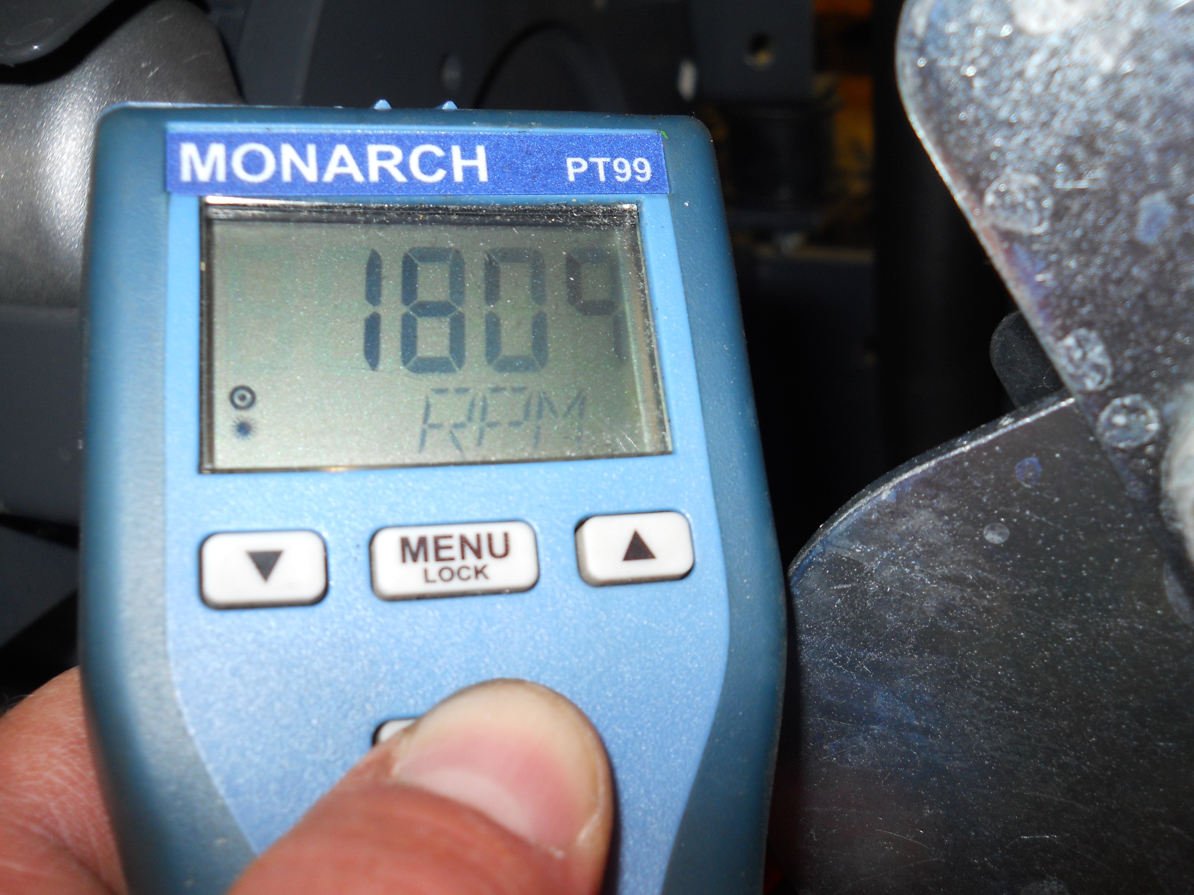

I bought a GR2120 in June 2013, I also did not like the low rpm vibration from the 3 cylinder engine. I got a reflective tape surface read tachometer and made the adjustments. Factory low idle was 1283 rpm. Factory high idle is 3182 rpm. See the screw by the orange highlighter in the pic? Loosen nut and adjust screw to 1800 low idle rpm. I also added a Racor water separator and filter, but that is another post. Philip.
