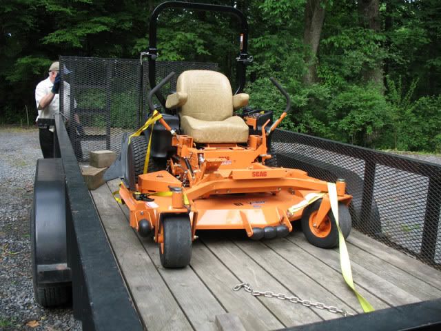

Just today picked up our Scag Wildcat 61". Its the 27hp aircooled if i remember correctly.
This is a BEAST, but have two questions.
When you choke it to start it, it smoked, ALOT. Grayish white smoke.
When you are done mowing and turn it off, its backfires about 5 seconds after the engine has been turned off.
Mower has 1 hour on it, purchased new from our local (25miles) Deere/Scag dealership.
