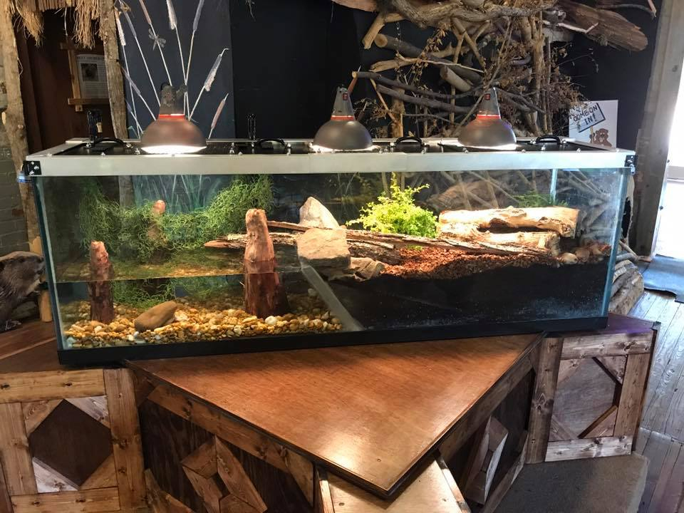

Not quite rural living but I was hoping to get some suggestions/solutions about an issue I'm having at work.
Backstory is that I work at a municipal environmental education center that focuses on an maintains a collection of animal species native to northwest GA. It's a pretty awesome gig because I get to wear a ton of different hats on any day of the week (zoo keeper, janitor, manager, educator, career counselor, etc). The only downside is that working for the government, especially a smaller municipality, means that we don't exactly have a lot of funding. Most of what we build and create is done using as little cash and as much "creative acquisition" as possible.

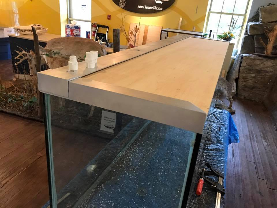

Whenever we get a new snake specimen I get to construct locking, slide top lid enclosures such as the one below that houses our resident cottonmouths. Everything in the build process is pretty dialed in and quick at this point except for priming the plywood lids for finish painting. Even with good wood surface prep brushing on and subsequently sanding down primer to achieve a smooth base coat takes more time than the entire rest of the build. (Finish coat is rattlecan satin black)
To that end I have been considering investing in some type of cheap, small capacity spray system to improve the priming part of the process. The concerns are:
- This literally would be a single purpose tool that would get used about 4 times a year for coating about 4-6sq foot at a time
- We have at our disposal a 6 gallon pancake compressor (exact specs unknown)
- Did I mention affordable?
- Other than cleaning the paint sprayer my old boss used for painting houses 20ish years ago when I was an apprentice, I have absolutely no frame of reference for sprayer technology.
Any thoughts or ideas would be appreciated. Understand I have no problem researching things on my own.... but given paint sprayers have been a bit out my wheelhouse I'm lacking on where to start.

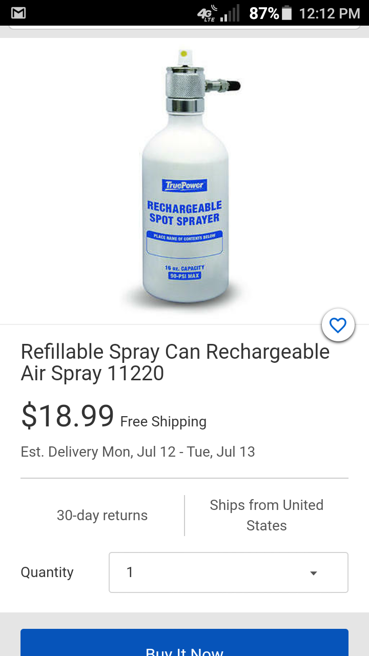

   / Solutions For Spray Priming Plywood #10
Would something like this work?
