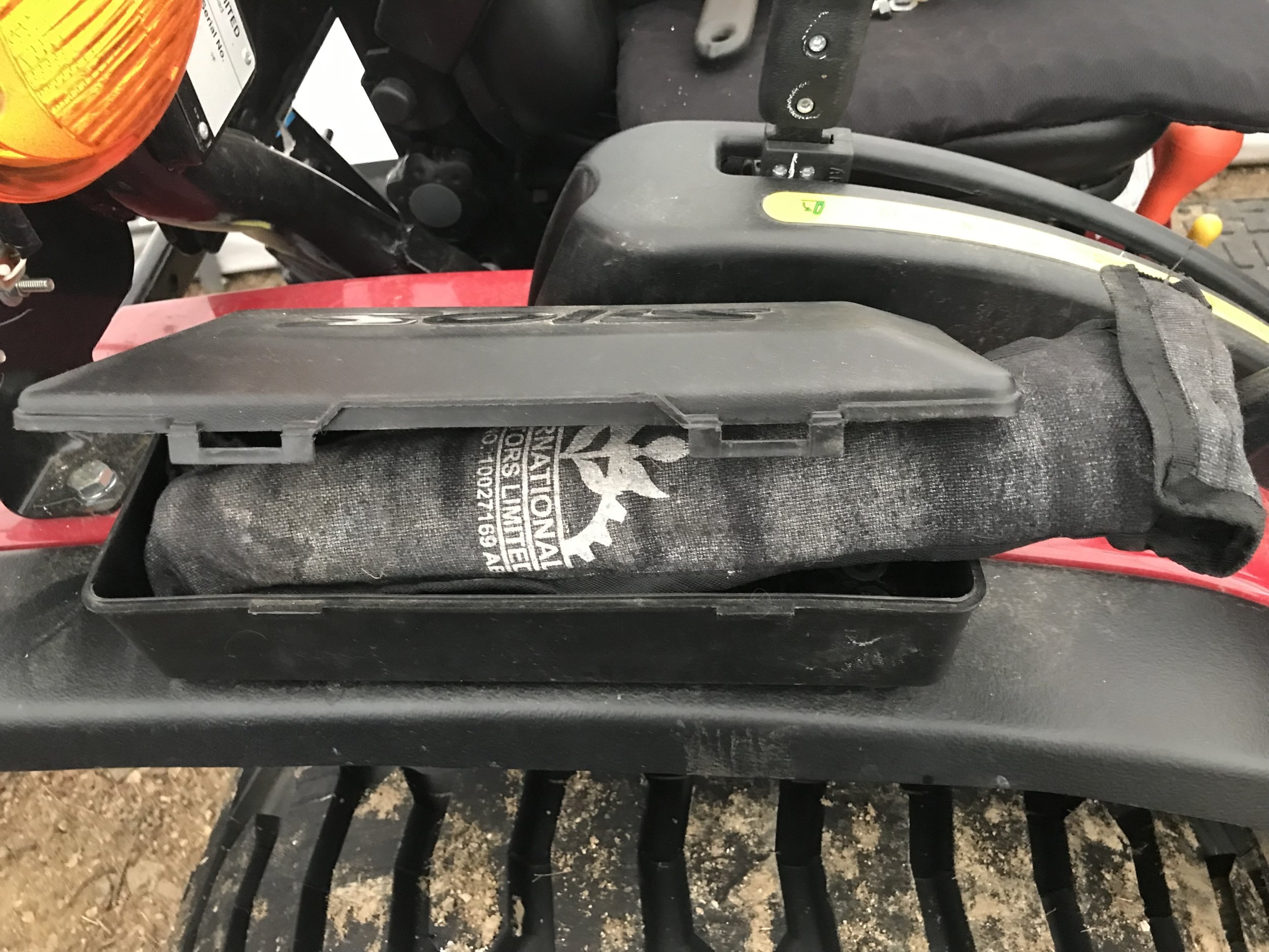

1) The tool kit that comes with the tractor is really nice, there's a nice assortment that ought to cover any "field repairs" and light maintenance. But the tool box that's installed on the left rear fender is way too small to house the tool kit... IMG_2471.JPG

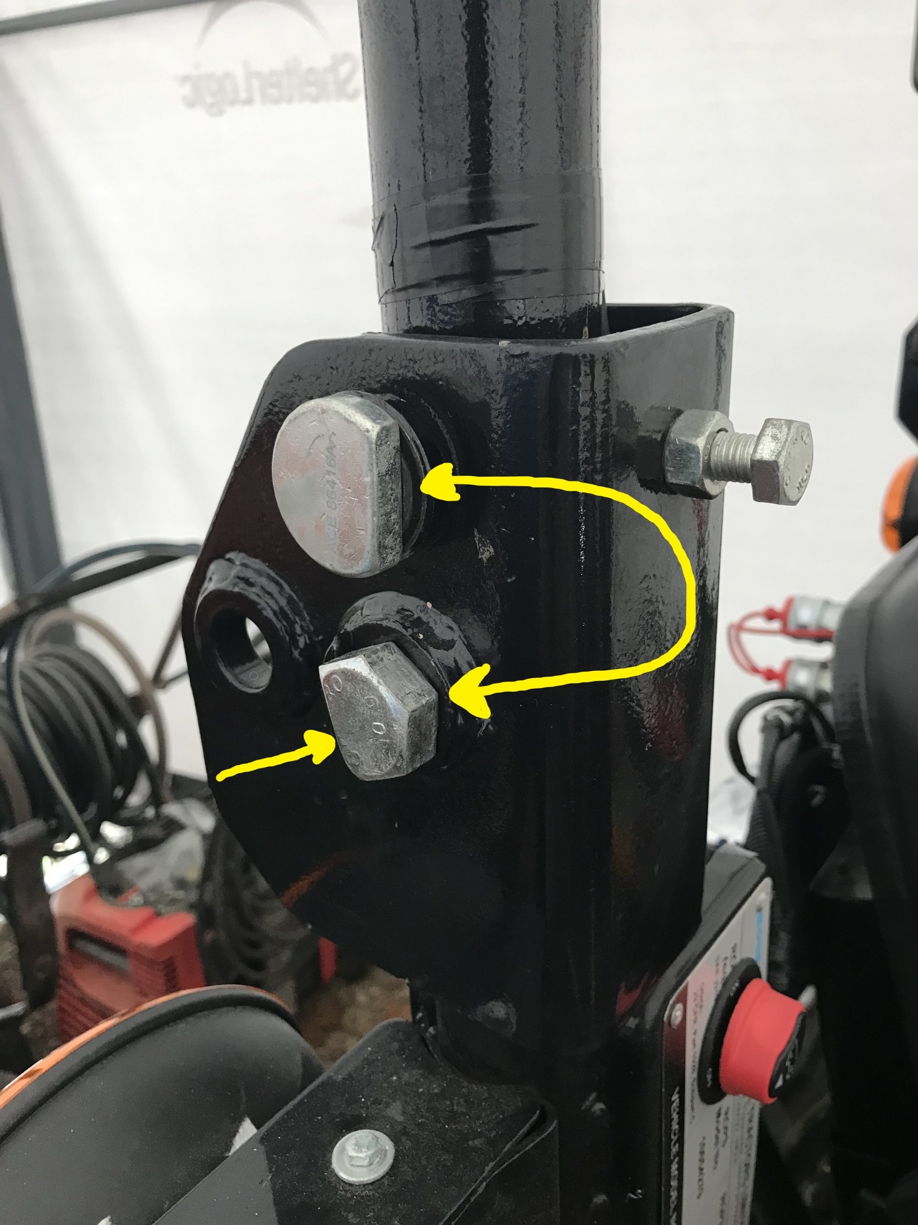

2) The ROPs is foldable, which is really nice. The concept is that you can pull two pins, store those pins in lower holes, and the upper bar will hinge back on two bolts. Easy peasy. But the bolts and pins are installed backwards from the factory, so pulling the pins doesn't do anything. It's easy to swap the bolts and pins, but the bolts need to have flats ground on the heads so they will fit in the lower holes. Once that's done it works well.
