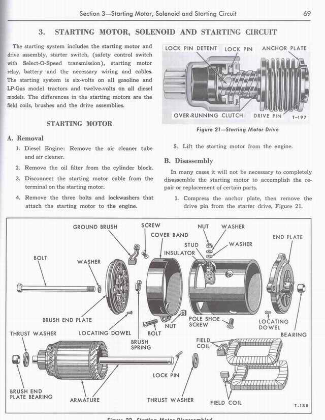

Kirt, my service manual says to remove the oil filter, electrical cable, and the three bolts and lockwashers from the starter where it attaches to the bell housing flange. It then says to lift the starter motor from the engine. That's all the instructions it gives. As you know, it may not be that easy. /forums/images/graemlins/crazy.gif
Hopefully by the time you read this post you will have your Service Manual on order. If not, the part number is: 40060090. I think that's a New Holland number. There are five pages in the manual that describe testing and disassembly/reassembly of the starter, brushes, bearings, and bendix drive. If you can't get the manual, I can send you these pages. If I were doing it, I think I'd just try to get it rebuilt at a starter shop, but that's just me. You might want all the "fun" for yourself. /forums/images/graemlins/grin.gif

Kirt, I think my manual was around $50, but that was almost 10 years ago. I'm attaching the first page out of the Starter Motor section which shows the complete assembly/disassembly. There are special tools for driving out bushings and I think a starter/generator shop would have these punches. If your starter is dragging, it might be bearings or it just might need new brushes and the commutator dressed.
I think you will like having that Service Manual. There are lots of pages about the Select-O-Speed transmission /forums/images/graemlins/tongue.gif, but the rest of the manual is pretty good. /forums/images/graemlins/cool.gif
