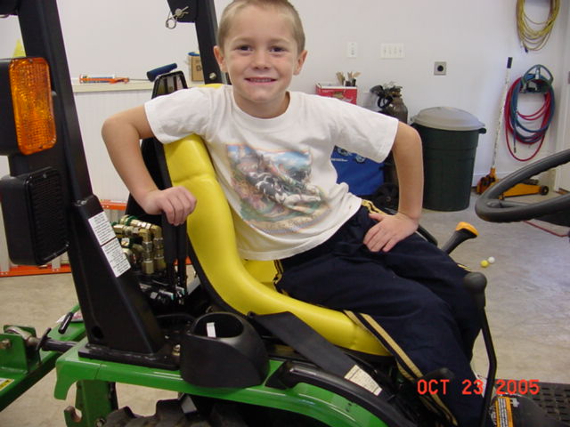

With that said, you can still mount a regular spool valve on the fender and mount the QD's just like you are talking about doing with the manifold.
