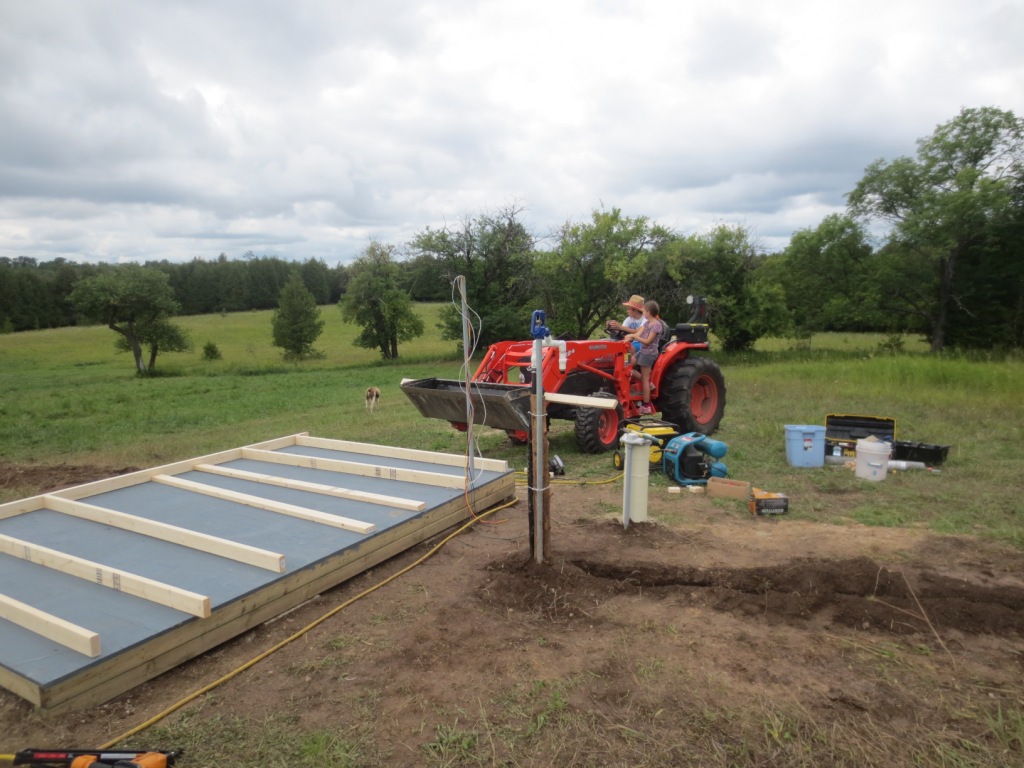

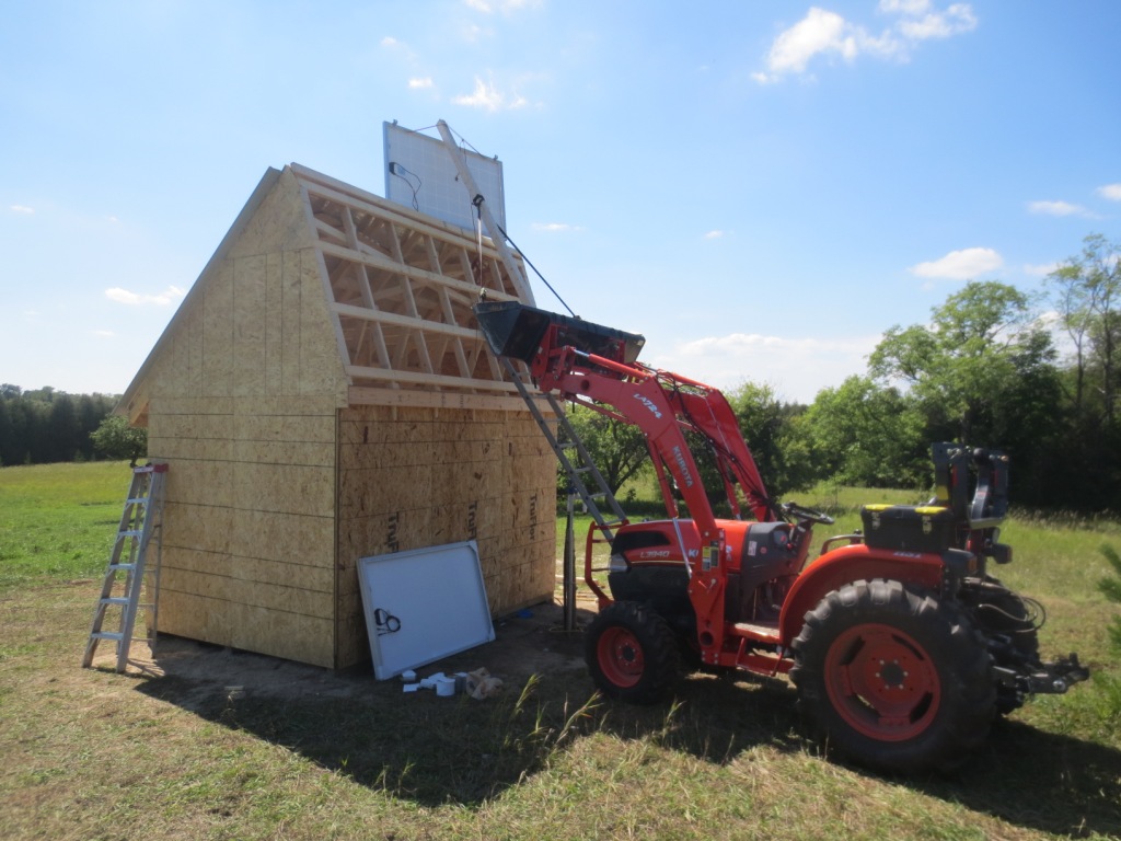

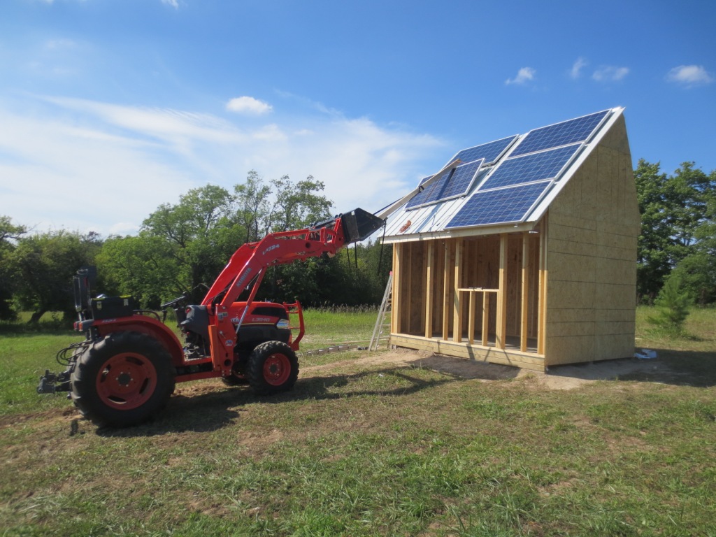

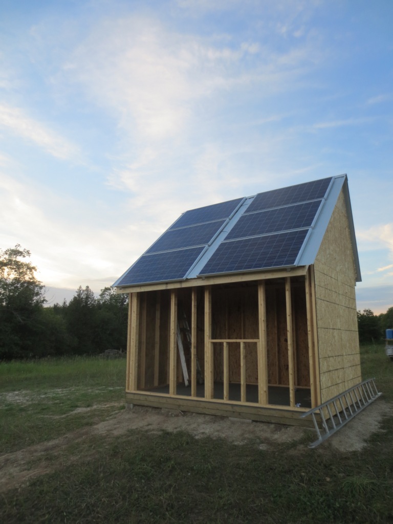

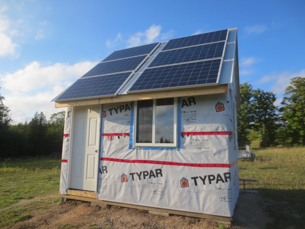

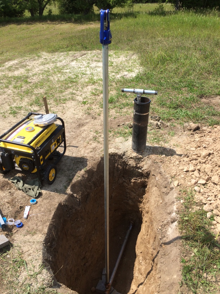

As I mentioned in one of my previous post, we installed a water well last month. Because we are off the grid and no budget to bring the hydro on the property, we decide to install a solar pump. We choose a Groundfous pump 16SQF-10; a quite expensive pump but worth every penny so far. To drive this pump I bought 6x 255W panels which I connected in 2 parallel strings of 3 panels in series. As a result, the total power delivery in full sun is 106V at 16A. The panels are connected directly to the pump using the pump controller but this will be changed once the house will be build and water will be required during the night, so CC, inverter and batteries will complete the system.
I installed all piping as can be seen in one of the pictures. It was quite challenging as took me almost a day to dug the 4ft big hole manually. Now we have water to fill up the pond, for garden and when the house will be ready I can connect it to the well.
To keep the solar panels in full sun, I build a small shed 8'x12'=96sqft(no permit required) and I installed the PVs on the roof. Quite tricky to bring those panels on the roof because of size and weight (50lbs at 3'x5'-6") but with my friend Kubota everything is possible. I attached some picture for reference. What is left, is to install the siding. I'll post the final pictures.:)

Those pitless adapter pits are pitiless. :laughing: Years ago I had to dig one up that was below a house trailer. What fun. I don't know why the original owner thought it was a great idea to park the trailer over the well head.
