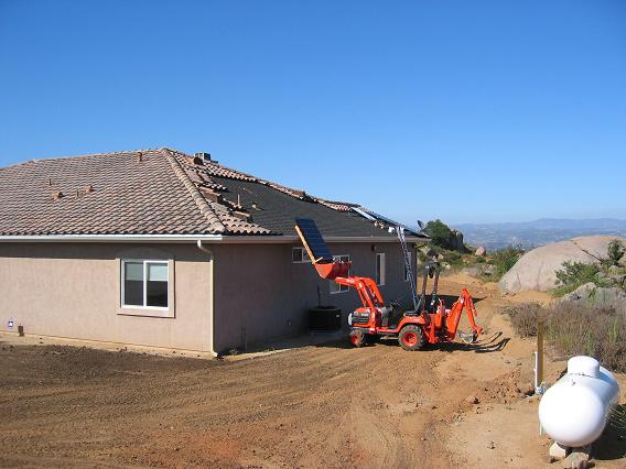

Well after reading all the 'project' posts for the last 2 months, I thought I should contribute...
I'm putting a 5kW solar system on my new house. Unfortunately I'm doing it all by my self. One of the hardest tasks is to get all 30 panels up onto the roof. They are about 40x50 inches, weigh 45lbs (awkward), and very expensive.
So I built some forks for my new BX-23 and can now safely raise the panels up to the roof.

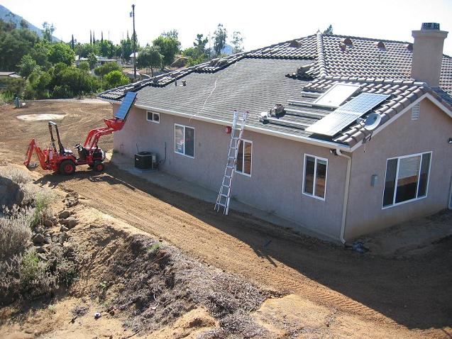

another angle...
