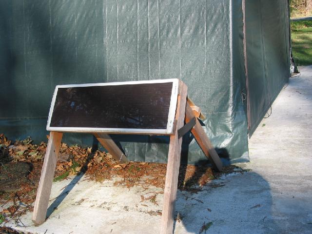

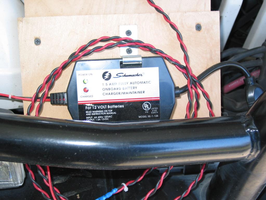

I've got an ICP Global Pro 115 solar panel connected to an ICP Global 7 amp charge controller that I use to maintain the battery on my Jeep. I only use the Jeep occasionally and the clock, stereo, car alarm etc. is a fairly heavy constant draw so a charge maintainer of some sort is a neccessity if I'm not going to drive it for about 2 weeks. I've found that the solar charger is only really useful for about 9 months out of the year, the other 3 months are too cloudy and the days are too short for it to keep up with the rate of discharge. I use one of the permanent mount 120v plug in style charge maintainers for the dark cloudy months.
As for installation:

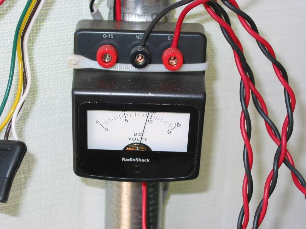

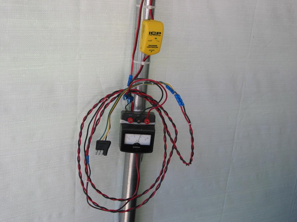

I made a saw horse type wooden stand to mount the panel and have it facing due south. The saw horse sits outside the Cover-it shelter that I use for Jeep storage. I ran the two wires from the solar panel to a cheap Radio Shack 12v DC meter and then from the meter to the 7 amp charge controller. I wired a standard flat four male trailer harness plug to the two wires that connect from the charge controller to the battery in the Jeep. I then wired a standard flat four female trailer plug directly to the battery, be sure that you keep your polarity correct or the magic smoke might be released from something. I also wired a male flat four connector to the battery leads for the 120v charge controll unit. The trailer connects give me a simple sturdy quick connect system.
I bought the solar stuff from Cabela's web site, just do a search on "solar panels". The approximate cost for the setup I have is about $150.00

This is the panel and saw horse stand.

This is the charge controller and meter.

This is a close up of the meter.

This is my winter time charger, it's one of the permanent mount 120v plug in units that I've mounted on a piece of plywood instead of on the fenderwell as the manufacturer intends.
