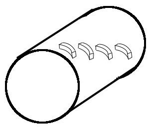

Ok, attached is a (very poorly drawn) mock-up of my idea for the drum. I'm thinking that it is probably better to take sections of the 2" square bar stock and cut pieces about 4" long, bend them slightly to match the contour of the drum and lay them out in rows as shown in the image. (Only one row of many is shown in the image.) If necessary I can bevel the edges of each "foot".
Does adding feet like this really contribute anything useful to the design or would I be better served leaving the drum flat? (I'm going to primarily be using this drum during the construction of a pond and dam. I will be pulling it either with the Montana 4340C or our Mitsubishi BD2G dozer.)

Brent- Certainly anything that you put on the circumferance of the drum is going to to add PSI to the roller as you reduce surface contact. But wouldn't you be better off putting, say 1/4"x2" bar stock across it from right to left, and then weld your 2x2x3" feet to that? That way you could put a bar across every 6" or so with feet sticking out every 6"? and use as many cross bar as you need to go around the roller. If you carefully attach the ends of the bars to each end of the roller, they could be removed for a 'lawn' roller in the future. Also, welding a 2x2x3" foot to the 'skin' of the tank, seems tricky! Whatever you do, the key to compaction would be lots of compaction 'sessions', in 'small' 3"-4" (6"?) "lifts" ! Just thinkin':confused::rolleyes: ~Scotty

Brent thats a good I dea Bobcats skid steer drum is set up like yours with a tube like piece bent that way. And it does help tremendously when packing soil it kneads out air pockets. I back filled a water treatment plant under ground tank one time that was 65 feet deap and 150 feet across well the tank was 100 that left 25 on ech side to work around. I ran a dozer between the tank and the bank and would spread 8 inch lifts of soil all the way around then drive a 70 hp tractor down there and ride in circles for 10 minutes and the compactor would be tip toeing.
This is an intriguing idea... I suppose I could get some angle iron and put some "ears" on each end so I could bolt them to the tank and then have the "feet" attached to the angle iron. Might not have to bend them to fit the tank's curve that way. Would have to weld the "studs" to the tank since I don't know how to make a bolt hole waterproof, and I'll probably be filling the tank with water.
I was planning on bending the feet with a tubing bender slightly modified to handle the square stock.
