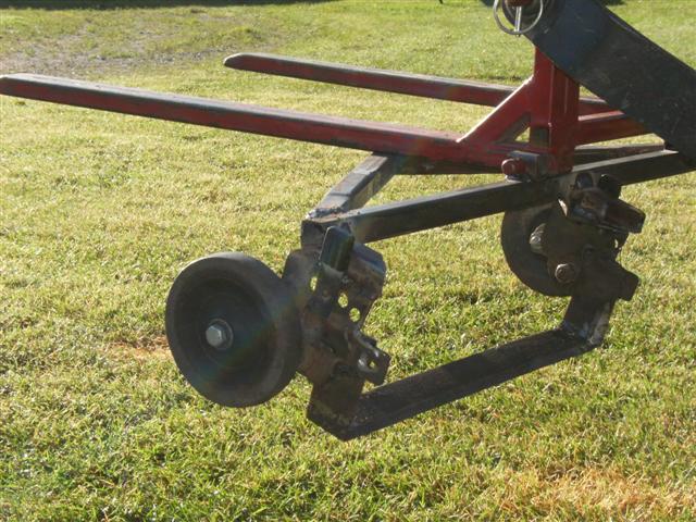

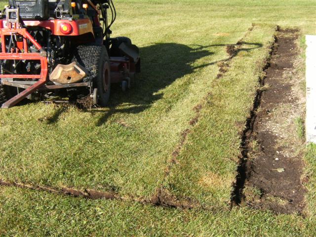

made this to pull behind my 4 wheeler but works as well or better behind my ttractor.
it is made from 1/4 X4" flat stock. Leading edges of front have 1/8"stock welded on and sharpend like a machette to cut. It works well if you go slow enough not to kick the person standing on the top ears off. It is a ballancing game for the rider, but once you figure it out it cuts perfect 1' wide by 4" thick sod. Maybe a bit thick, but you get all the roots for a better piece of sod.

would love to see any variatons.

The saftey police will not like it but i think it looks great. If you were to build a three point hitch you could replace the rider with some weights.( I think!)

Here's pictures of one I saved from member's post here on TBN. I can't find the original post but I did keep pictures of the sod cutter just in case I needed it for future reference. He attached it to his 3ph folks. No helper required.

Are those wheels salvaged from a push mower? Sweet.
/ Sod Cutter #6
I should have clarified. That sod cutter is not my build. It was build by another TBN member. I looked but could not find the original post. They certainly look like wheels from a push mower.

I built one 7-8 yrs ago that bolts on to my box blade. The weight of the box blade ensured the knife would penetrate and stay in the ground and it prevented the knife from going too deep. I guess that was the first "implement"/tractor project I built. The knife is shaped like the one in the pics posted by Luremaker. Made from 3/8" X (can't remember") and sharpened on the leading edge of the sides and bottom.
