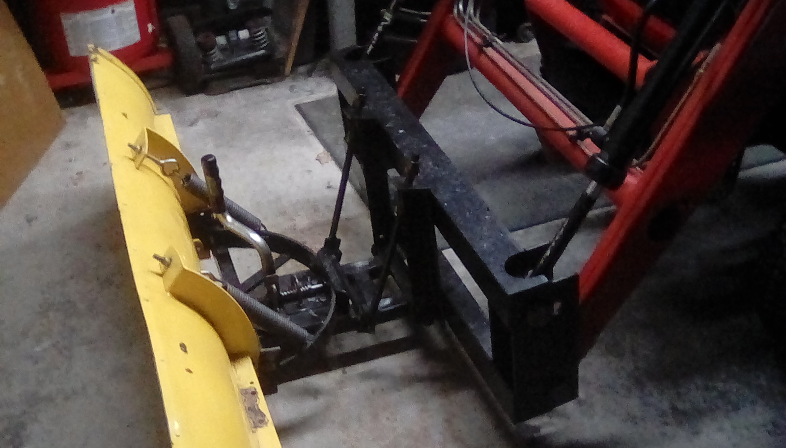

I bought a 54" ATV plow at auction for 50$. Added 4" to each side. Made an adapter to fit the loader. I had to reinvent a little here and there but works great.
I think brand name was Moose.

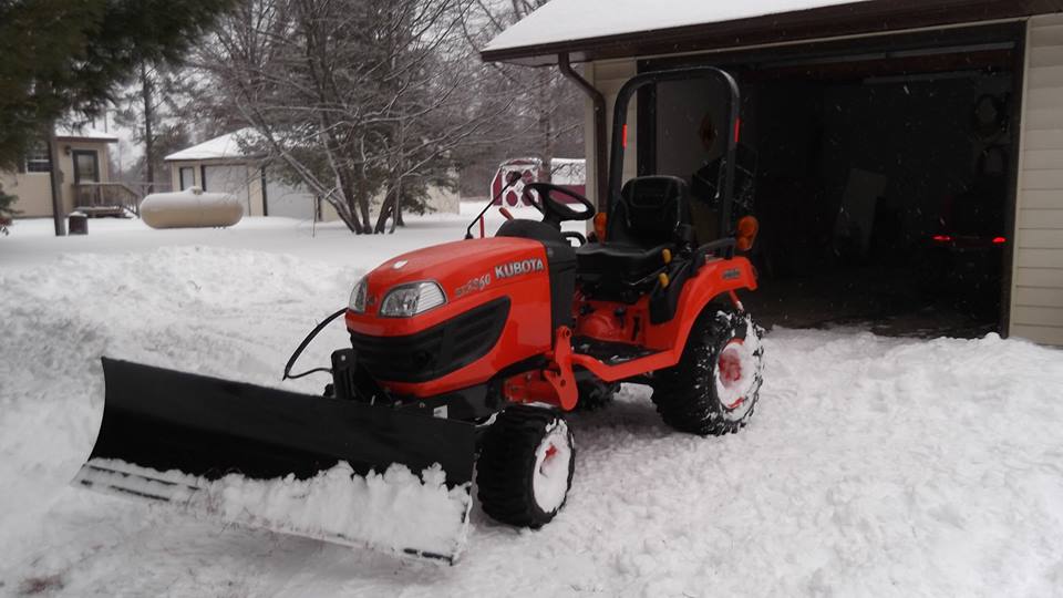

I "split the difference" as my old pappy used to say. LOL
My first BX, we had just moved north and the snow talked about was true, so I splurged for the top grade, Kubota 60" heavy steel dozer blade, lift and tilt hydraulics, front QH mount, etc. That was $2200 back then. It was positively awesome, if a bit over kill really for snow.
Roll the clock forward 6 years or so and I bought another BX. I just didn't want to drop that much money again and had a different plan. I did have to buy that expensive QH front frame mount but saved a few bucks by finding one at a dealer who wanted a NOS piece gone. Then, I found a Kubota 54" blade at a dealer and again, in a dusty, 7 year old box and he wanted it gone. The 54 is lighter built, but plenty good enough, although it only comes with two functions, up and down. Manual tilt. Not for long. We strengthen the blade by splitting a piece of black pipe, beat it onto the cutting edge and tack welded. Then, my machinist neighbor custom tabbed up the second cylinder, tabbed and welded the brackets, etc. Perfect. Bottom line is the whole deal saved me around $750 which is no small change.
