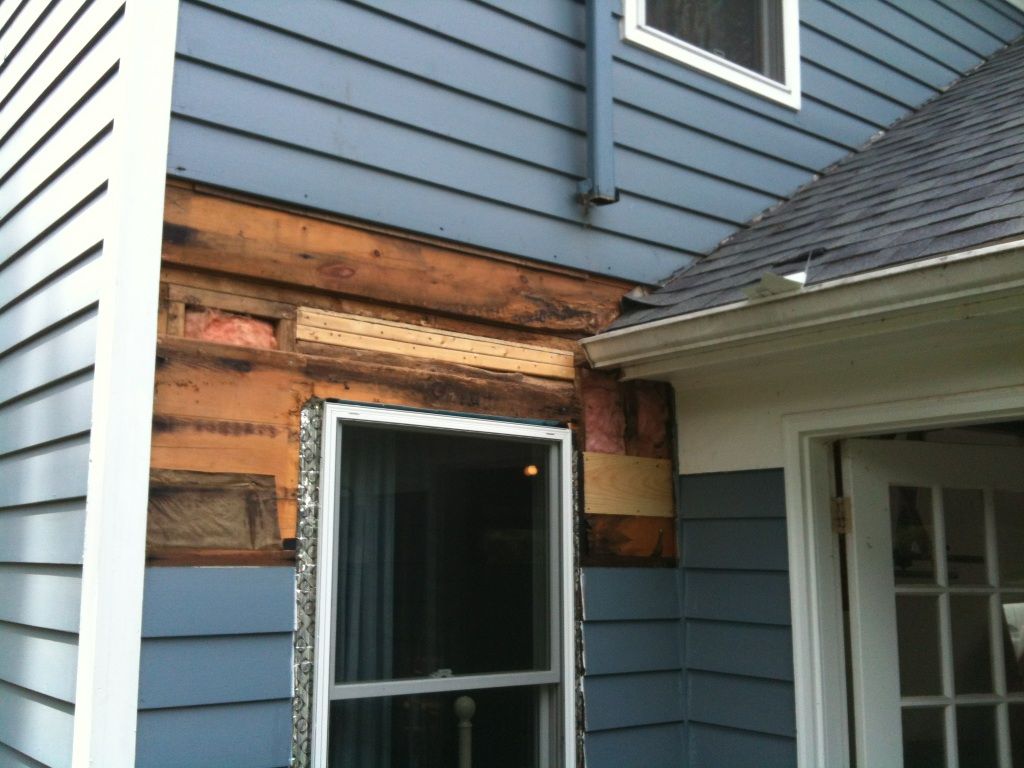

When we purchased this house I failed to see water damage at the end of a gutter, it was covered with a piece of duct tape. I pulled the tape off a year ago or so and found a small hole, not being able to do the repair at that time, I filled with some foam, and put the repair on the list. I replaced the windows in the house a month ago, and found more water damage / dampness around the window in the picture and kicked myself for not taking care of this last year. A trip to the lumber yard for replacement siding and waiting for a day without rain, and some motivation and I was ready. Saturday was the day..
Forgot to take a before pic, but this is what I found after removing a couple of siding boards, yuck....
The insulation in those two sections was crumbled and full of decayed wood. I ran a shop vac hose down the wall and sucked everything out, and replaced the insulation.

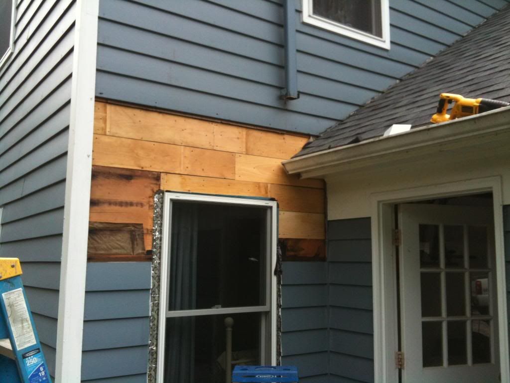

Removed more of the siding, and found the boards under the siding, tongue and groove white pine needed to be replaced as well, removed all the damaged boards and had to do some repair to the window header.
Replaced with new pine boards.

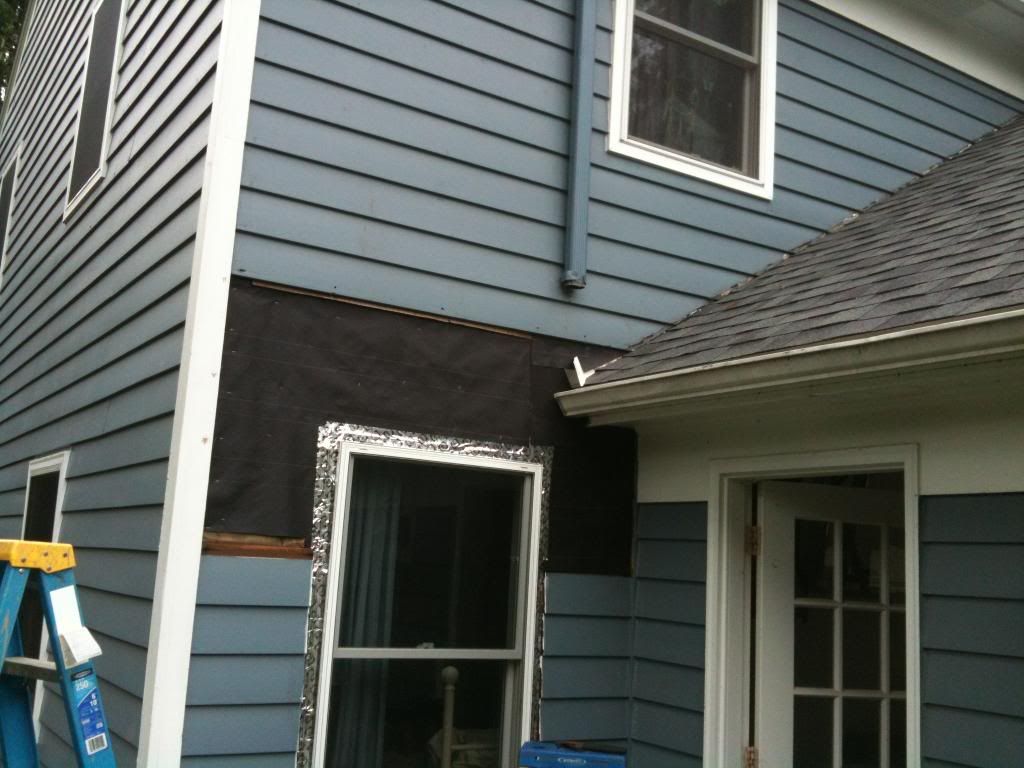

put new tar paper on, I'm planning to replace all the siding in the next couple of years, but wanted to be sure this issue did not return.

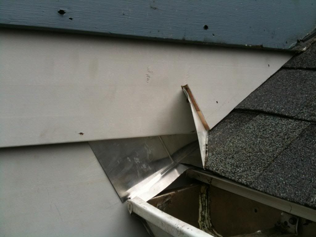

I also replaced some step flashing and installed a diverter, put ice and water on the wall, really went overkill on this.

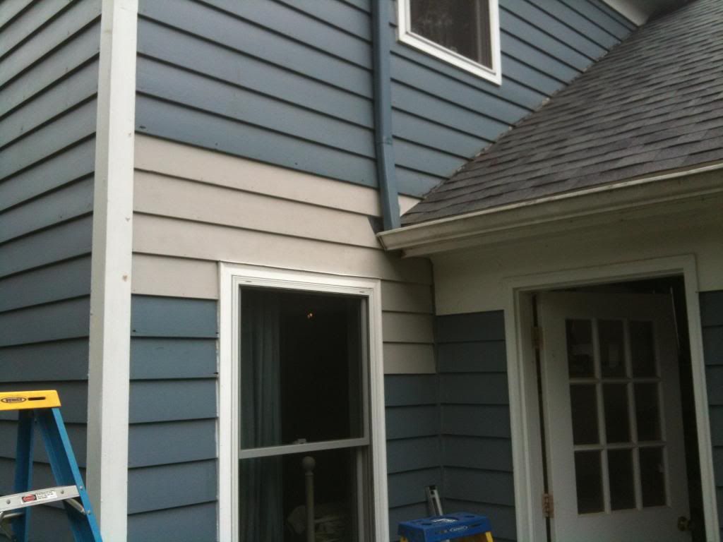

Finished except for a coat of paint..
Here is an example of the destruction carpenter ants can do... I should not have put this project off.

Sorry to say this but it looks more like termite damage to me.
   / So there is a small hole in your siding..... #3
Nope, that's what carpenter ants do too.

You need to move that upper down spout it is dumping into a small gutter trough and will put water back where you fixed it, that problem is from the gutters then because it was moist the insects, any mold in that wall?

What you have done to repair the issue is "ok" but it's a big no, no to have the clapboards right down on the shingles. The ends will suck the water up like a wick. The kickout flashing you put in at the bottom is a step in the right direction but I would take the advice above and move the upper downspout so you don't have the same issue again in the near future.

I wonder if adding an elbow on the end of the downspout so that the water flows out into the gutter further along rather than splashing straight down right at the wall might help reduce future damage. Have you had a chance to watch what it actually does in a heavy downpour?

I can't see in the pictures if it's there, but where siding meets a roof there should be step flashing under every shingle. It's probably not worth retrofitting but where you're replacing siding you should add it.
