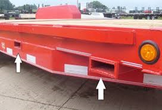

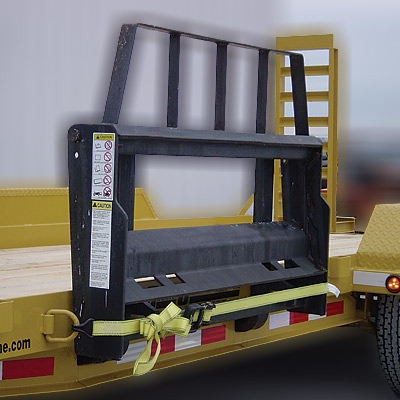

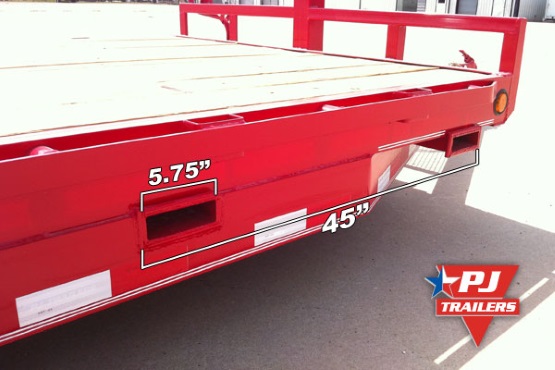

I would like the following options: fork pockets, spare tire, lockable chain/binder basket.
For those not familiar with fork pockets on a trailer:

They allow you to carry or store your forks on the trailer and not take up deck space.
