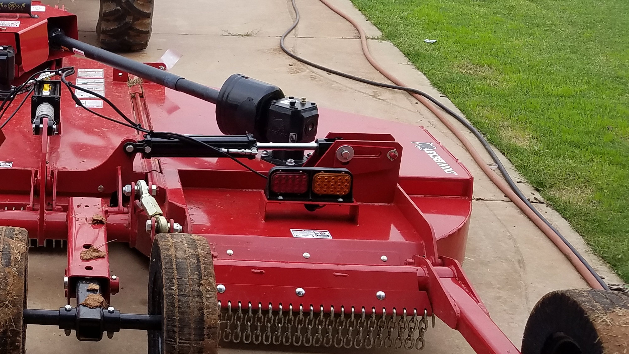

Without the wings being able to float I don't know how well your going to like the cut. When in float they can follow the contour of the land. If not, they will be rigid. Can you post some pics? When you push your scv lever forward it would lock in place?
Brett
   / So I just bought a bush hog 1812
Brett
They can float. the attachment point for the wing cylinders has a long slot. after the wings are lowered they have XX ( cant remember the number) degrees of movement up and down. The problem I see is if I get a wing so high that it uses up the slot. Then they will be in a bind because the cylinder is full of oil 20171004_132327[1].jpg. I do not have the type of hydraulic controls you talk about. They are centered and no oil flows unless I move the lever one way or the other.

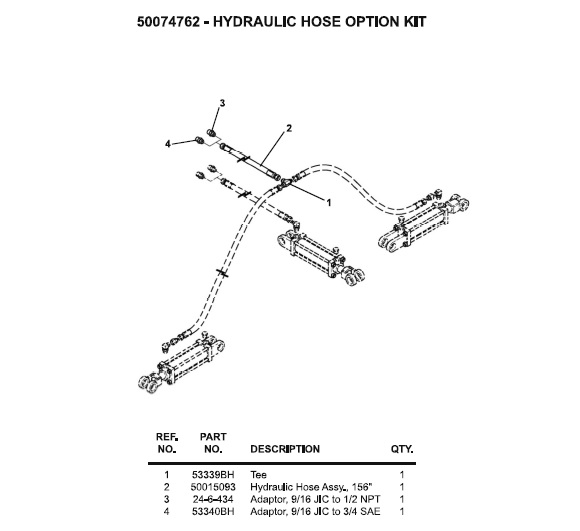

Here's what's in the manual - it's an optional kit from BH. Mine was equipped with it when I bought it and works fine.
HP
  • 2 remote hyd hookup.pdf
HP
Thats the way mine was set up. Did not work well with my tractor. Perhaps my hydraulic control valves are not correct for this application. I have changed it to work off of two seperate remotes. Works the way i expect it to now.

That is supposed to be connected to two sets of remotes, one hose to each remote, not both hoses to both sides of one remote.
Aaron Z
#9
Aaron Z
I dont see how that could work. I can understand raising the wings or the unit itself but upon trying to lower the unit my remotes will pressure up against the side that does not have a hose attached and squeals and makes all kinds of noises. The Kubota dealer sells these everyday and they hooked it up to my tractor, both hoses in the same remote

Yes, it squeals because you are hitting the pressure relief, but you are only doing it for 30 seconds or so, it won't hurt anything to do that, just drop the engine to an idle to reduce how much flow is going through the pressure relief.
