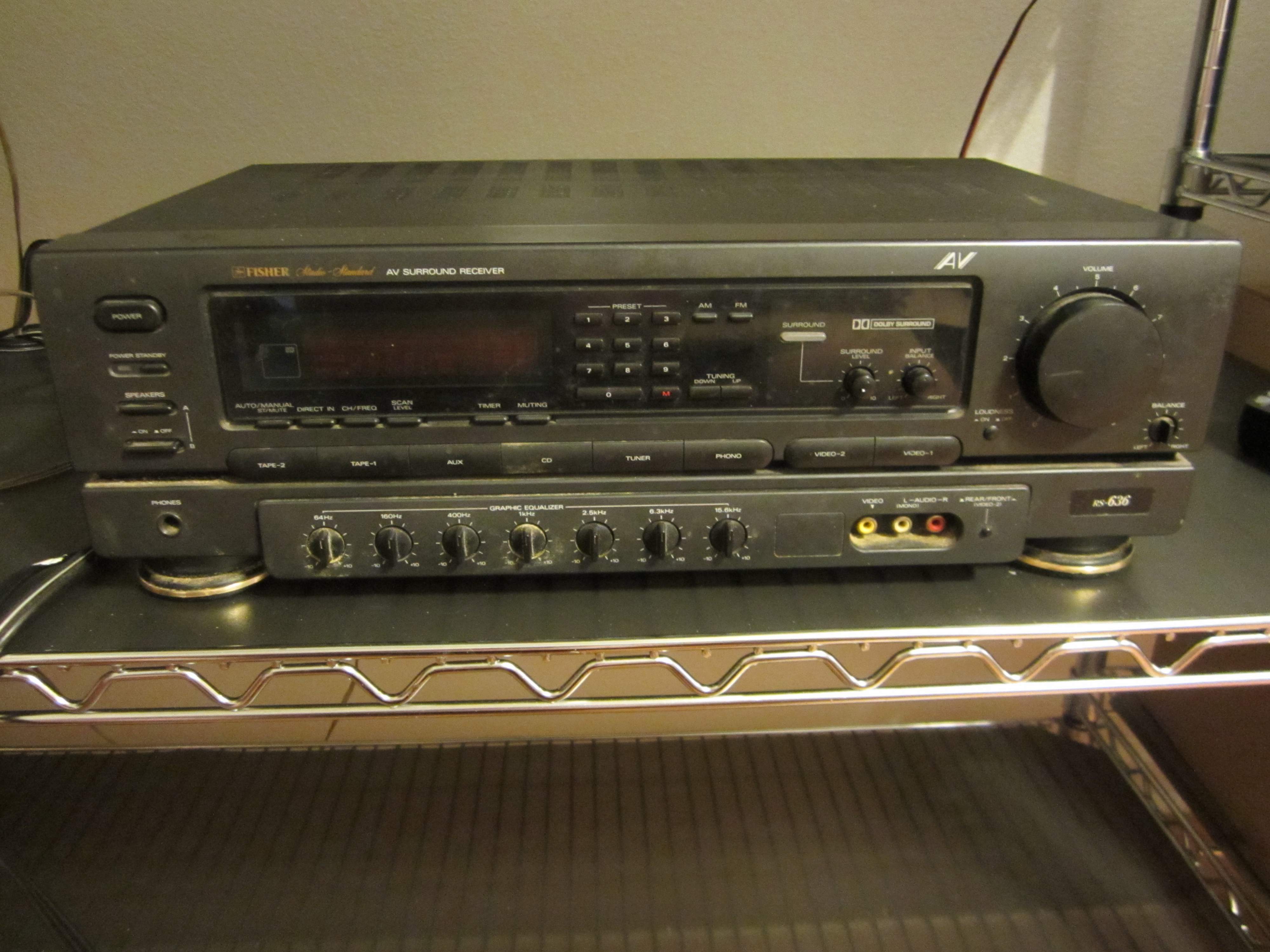

It is a six channel surround sound system, but when I hooked it up, there was static and the right left balance wasn't equal. Most of the sound came out of the right speakers. Playing around with it, I found out if you turned off the surround and had straight stereo, the sound was fine, and the balance worked right. It is rated for 220 total watts, so you could say 100 watts per channel in stereo with 8 ohms impedance. I could just use to 8 ohm speakers and call it done, but I was wanting to rig up more than one on each channel. The problem of coarse is if you go too low with your impedance, you will burn up the amp in the receiver. {two 8 ohm speakers hooked in parallel is 4 ohms. They would put out more sound, but it could hurt your amp} If you go too high, you don't get the volume of sound. {two 8 ohm speakers hooked in series are 16 ohms. Sound output will not be as much, but should be safe for your amp} There is a way to hook up four speakers to each channel and keep the impedance at 8 ohms. It uses both parallel and series. So it halves it, then doubles it. But eight speakers take up a lot of space.

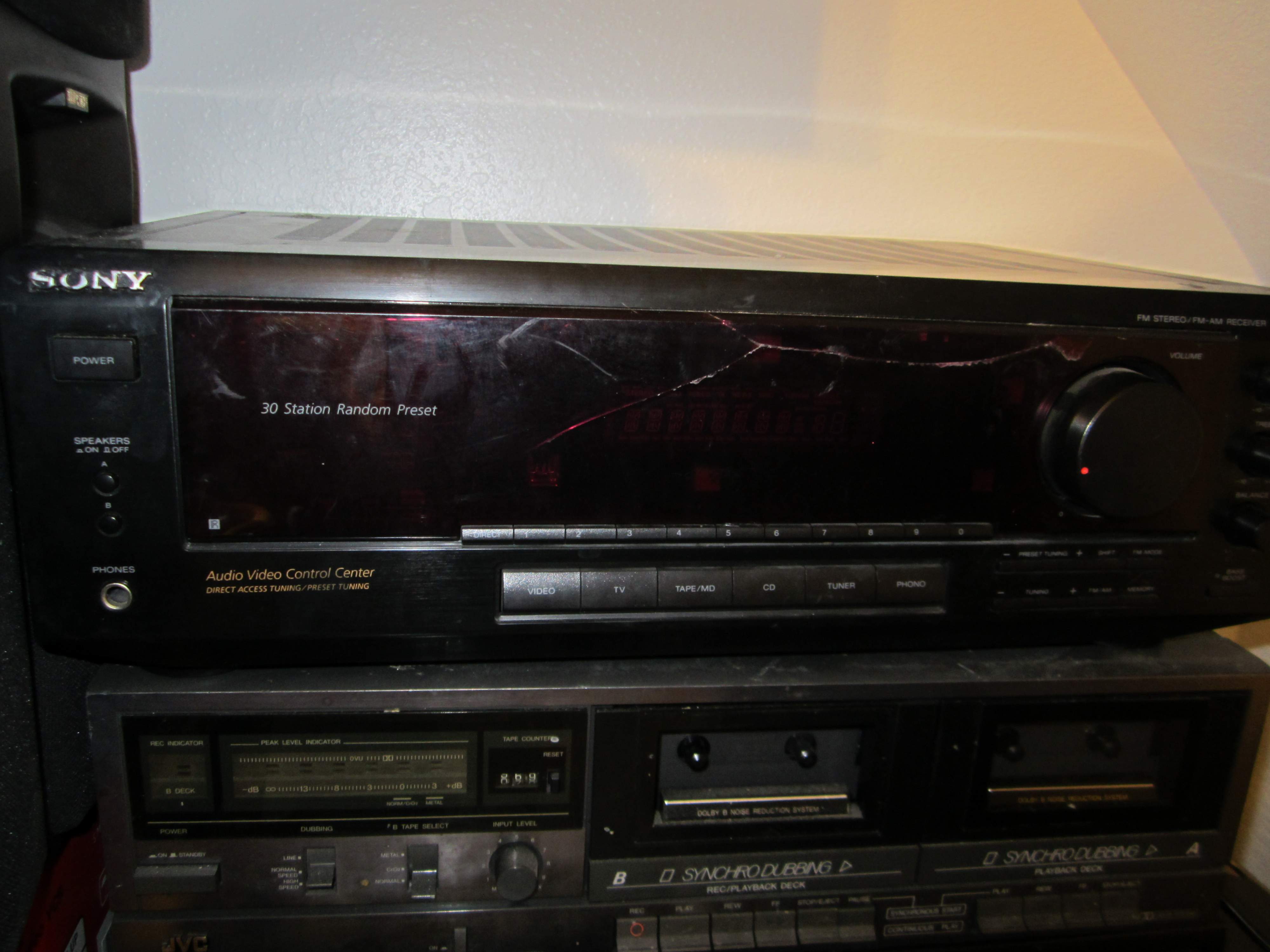

This is the 'new' Fisher, the cause of me trying to figure out what to do. Here is a brief outline of what is where.

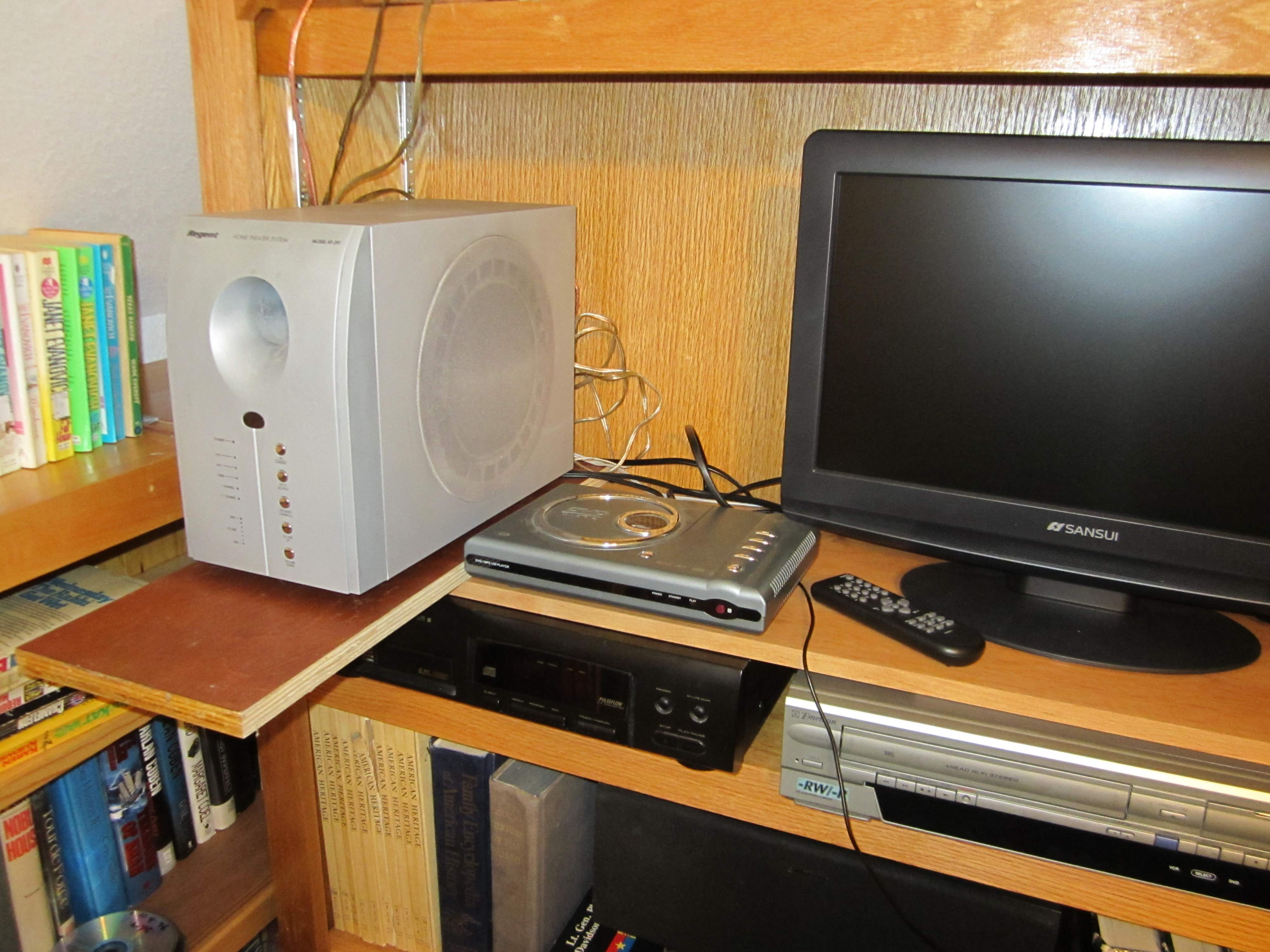

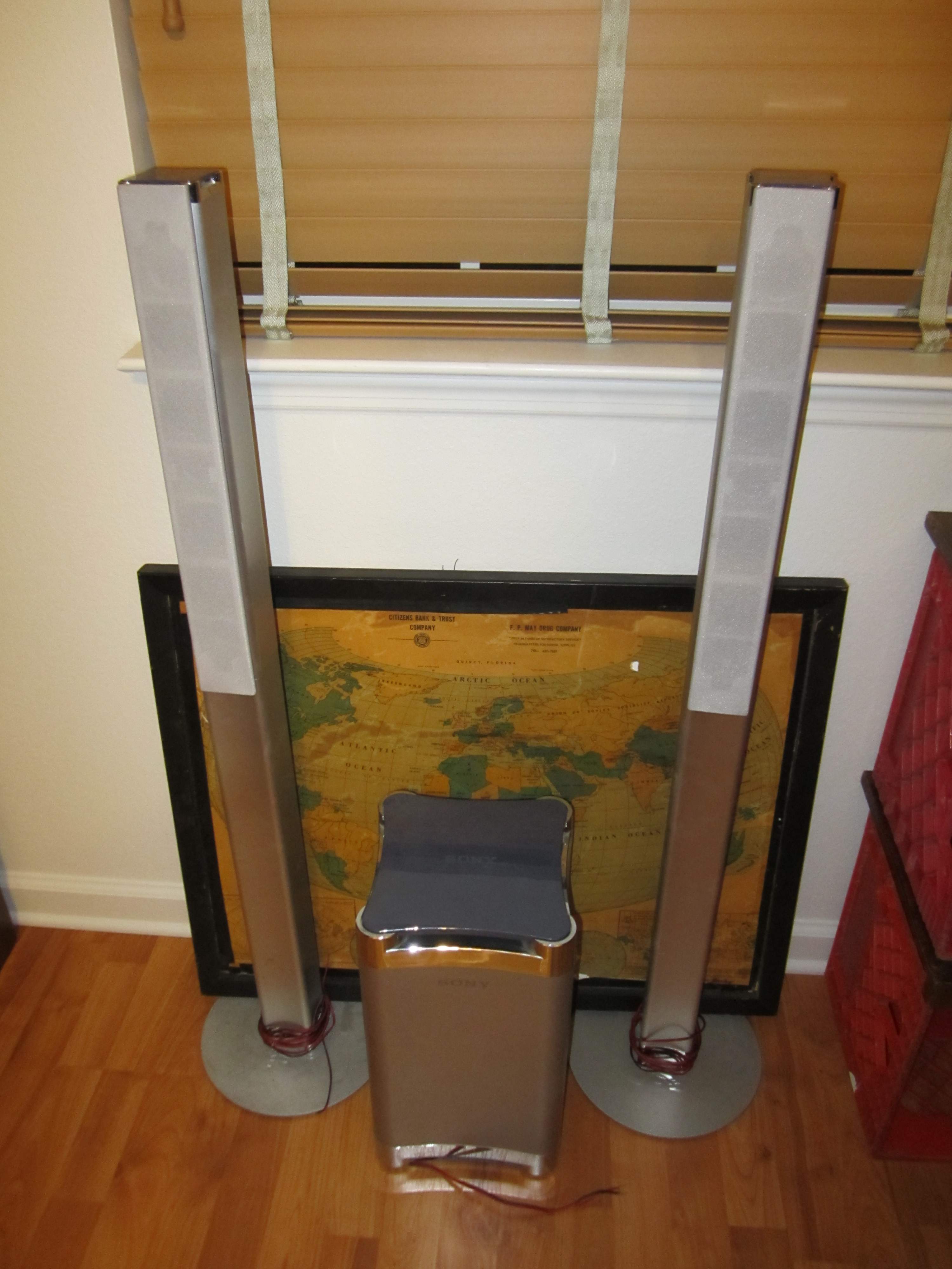

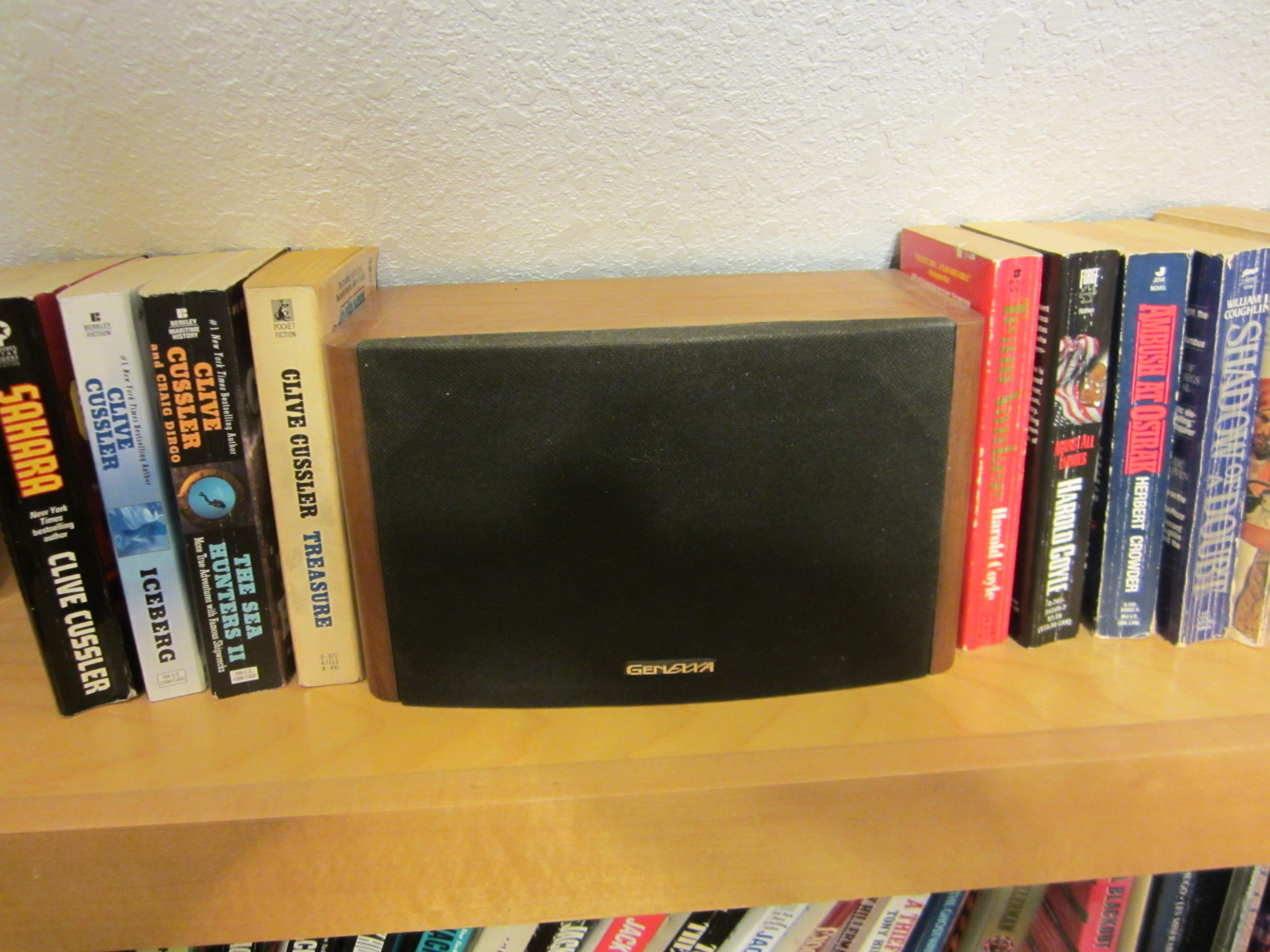

I had this Sony in the library, but it has a short. {maybe the broken glass should have been a clue} I traded an old receiver and a pair of speakers to a friend to fix it, but it's still got the short. Sometimes it will play for hours, and sounds great, but when it don't, it's a PITA. So I changed it with this home theater system. It sounds pretty good, but only has three inputs. It does have five speakers, as well as the sub woofer built into the amp. I kept the same four bookshelf speakers from the Sony, but had to add a fifth one. As you can see, space is an issue here.

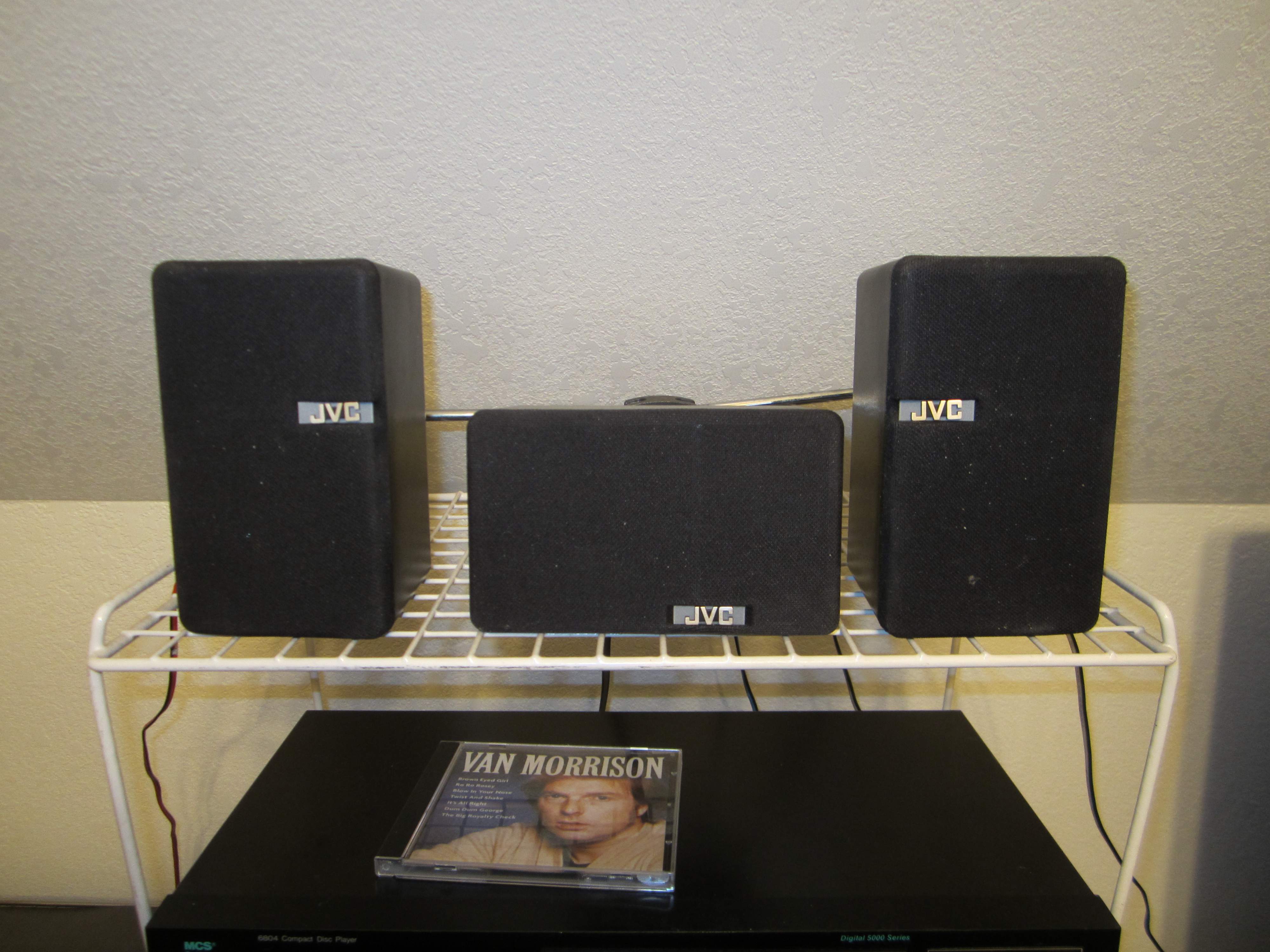

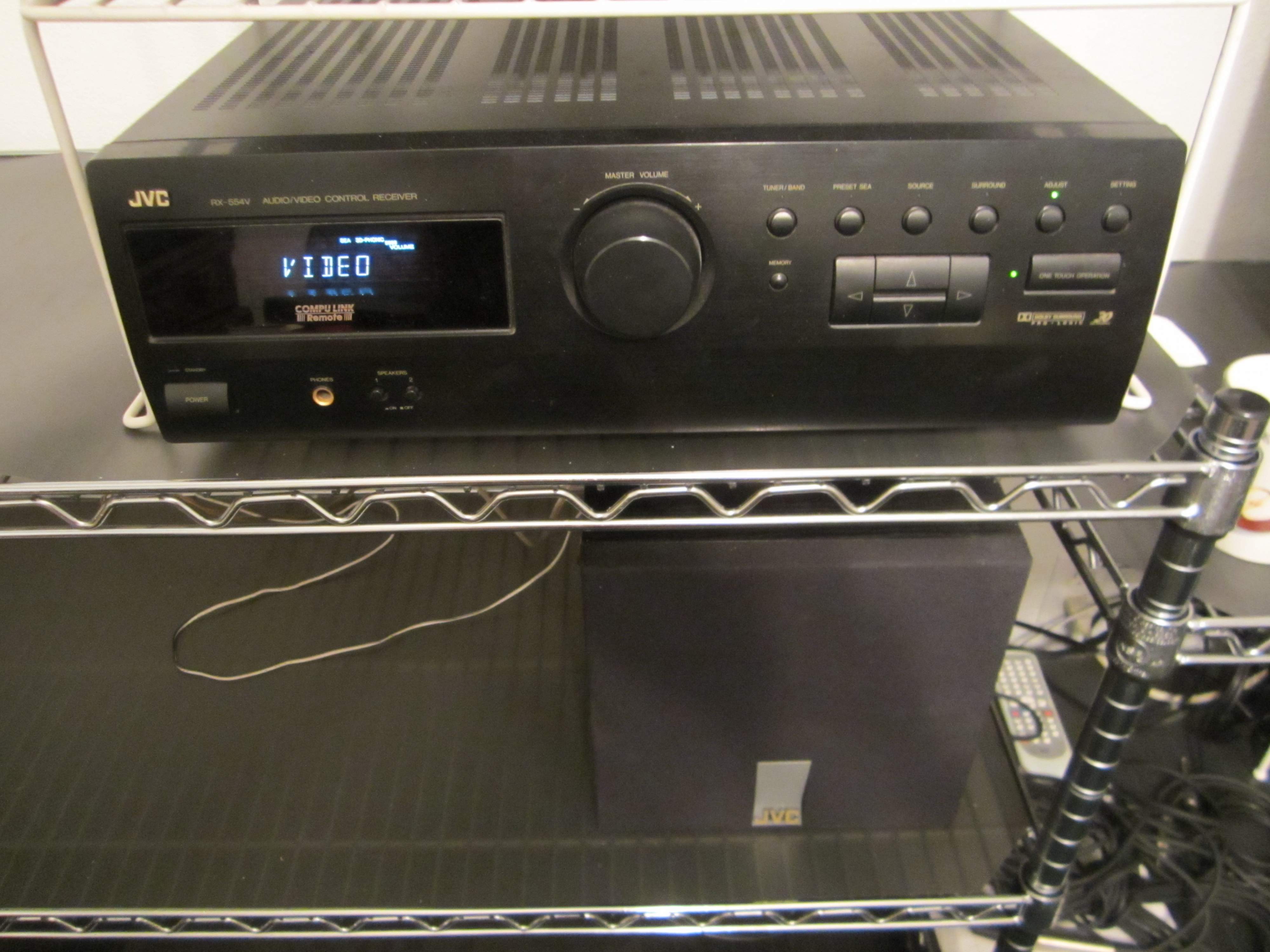

I have this JVC 5.1 system in the media room {where I do most of my music recording on DVD's} It is a newer system and has small speakers. I was thinking of putting it in the library, putting the Fisher in the media room and the home theater system in the storage room. Then I could use the bookshelf speakers in the media room with the Fisher.
I had this older JVC and speakers in the storage room before I got the Fisher. It works fine, but is really big. The same for the speakers.

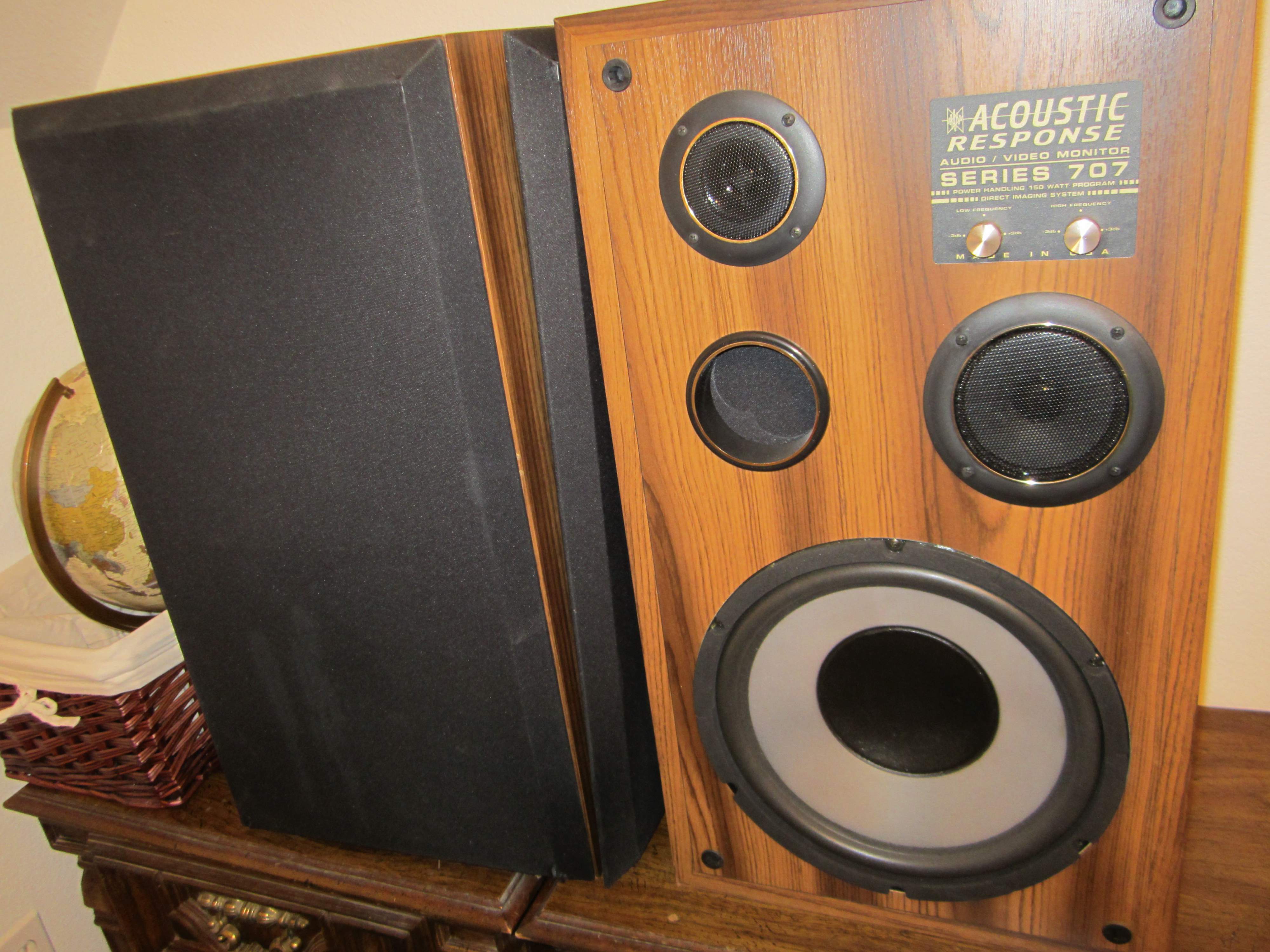

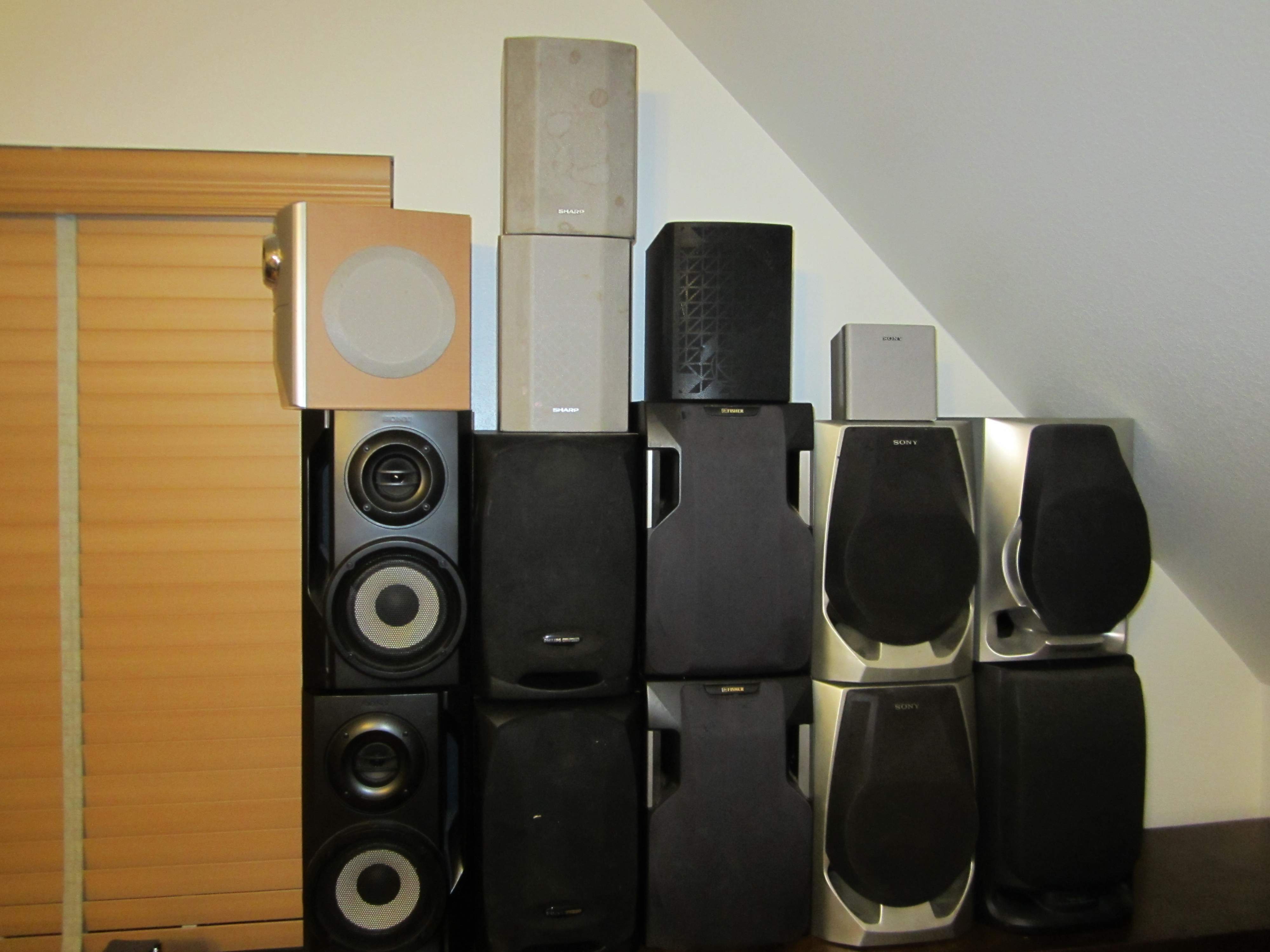

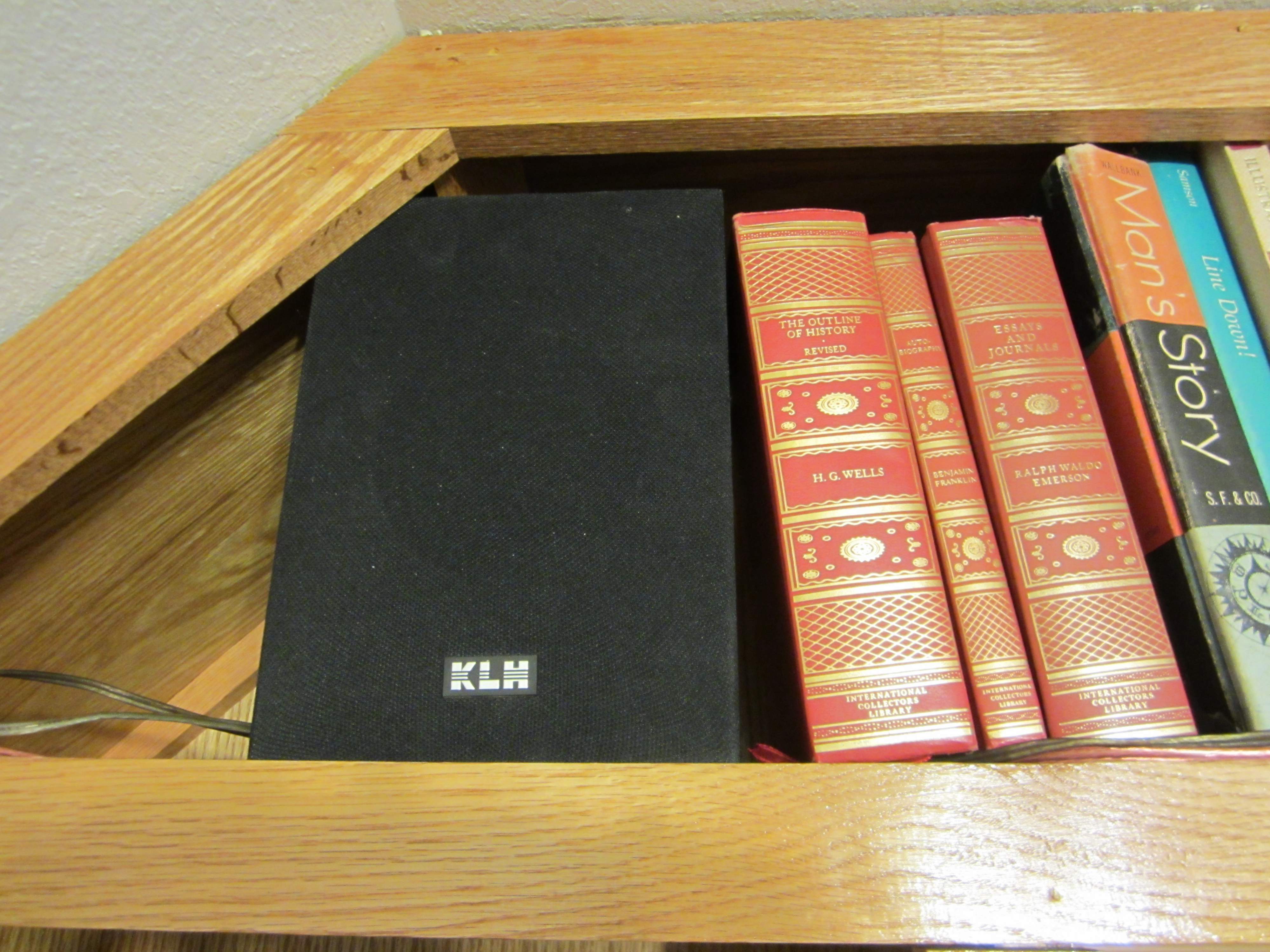

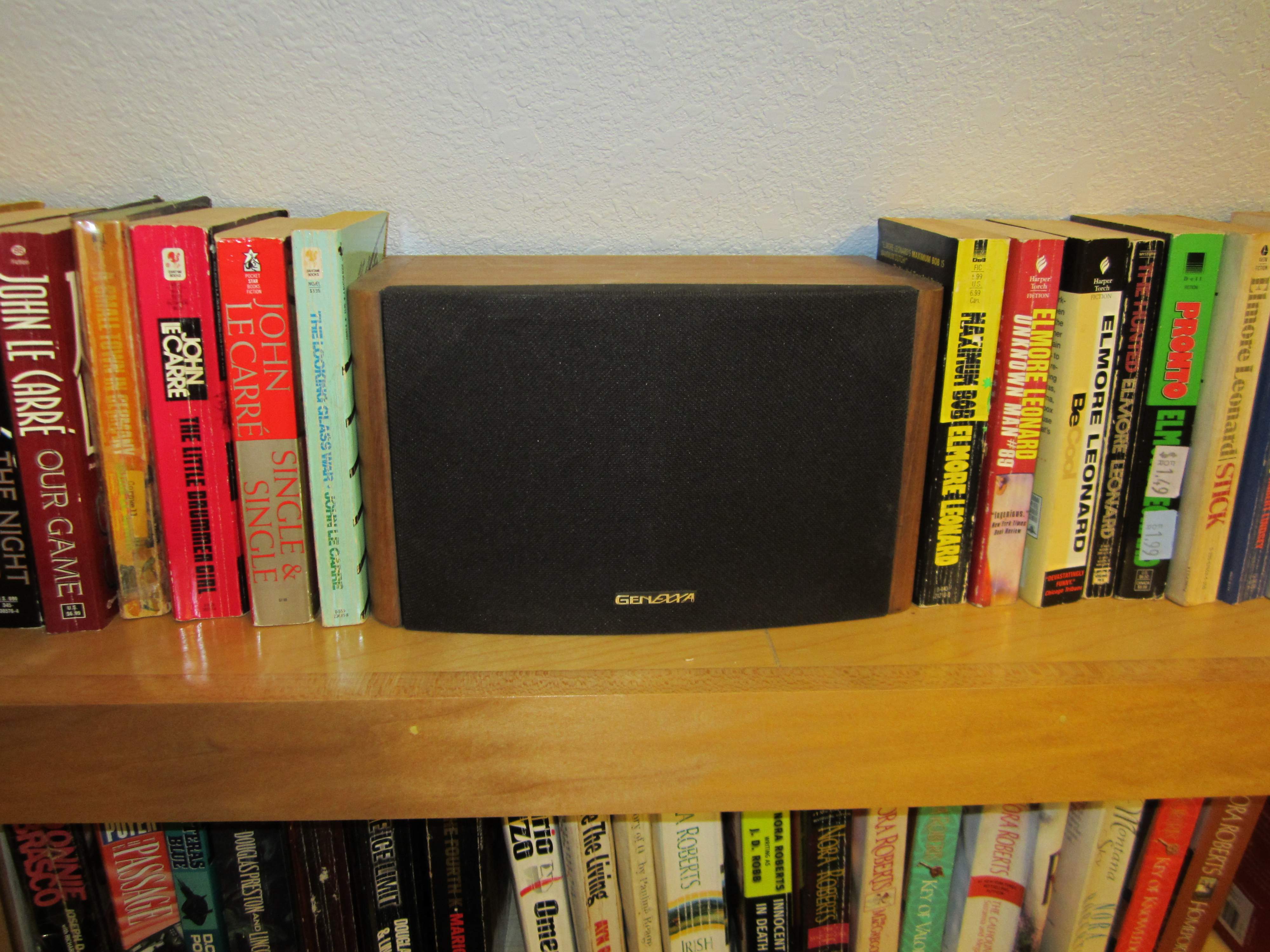

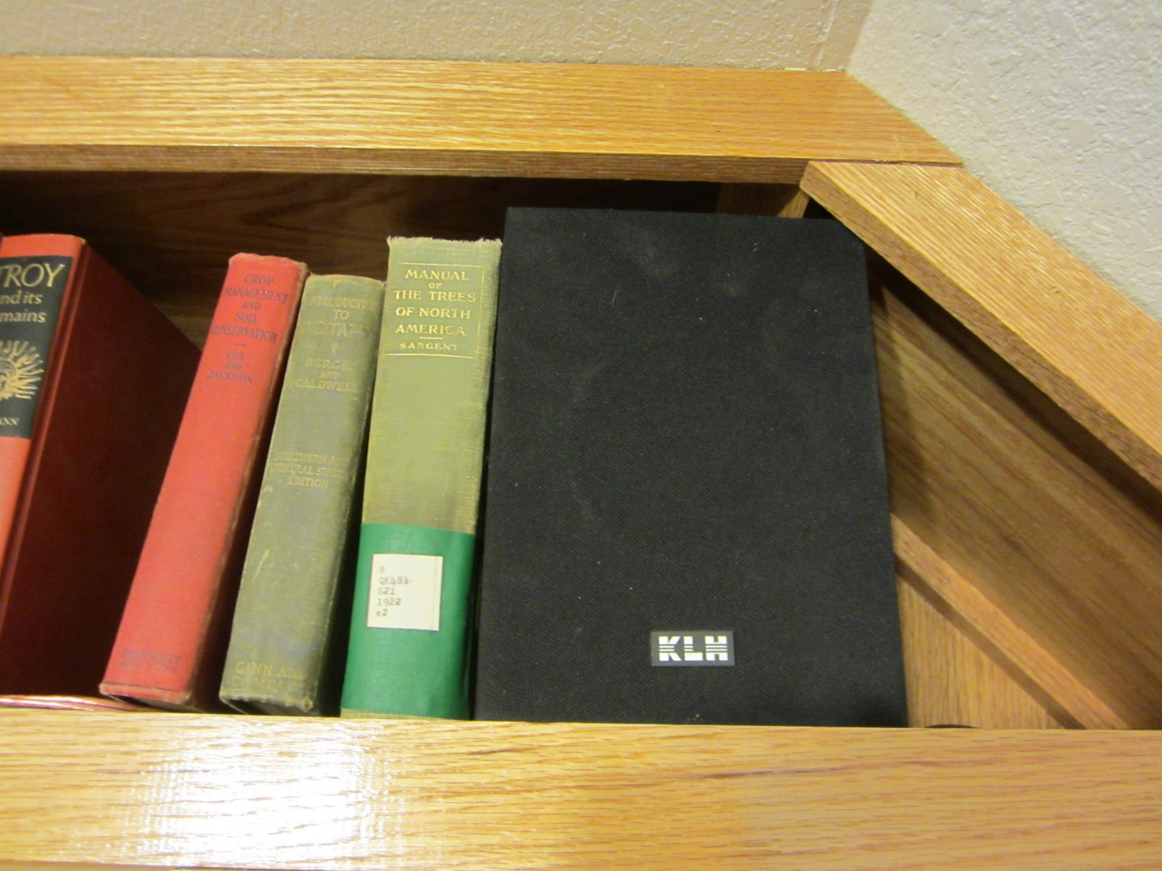

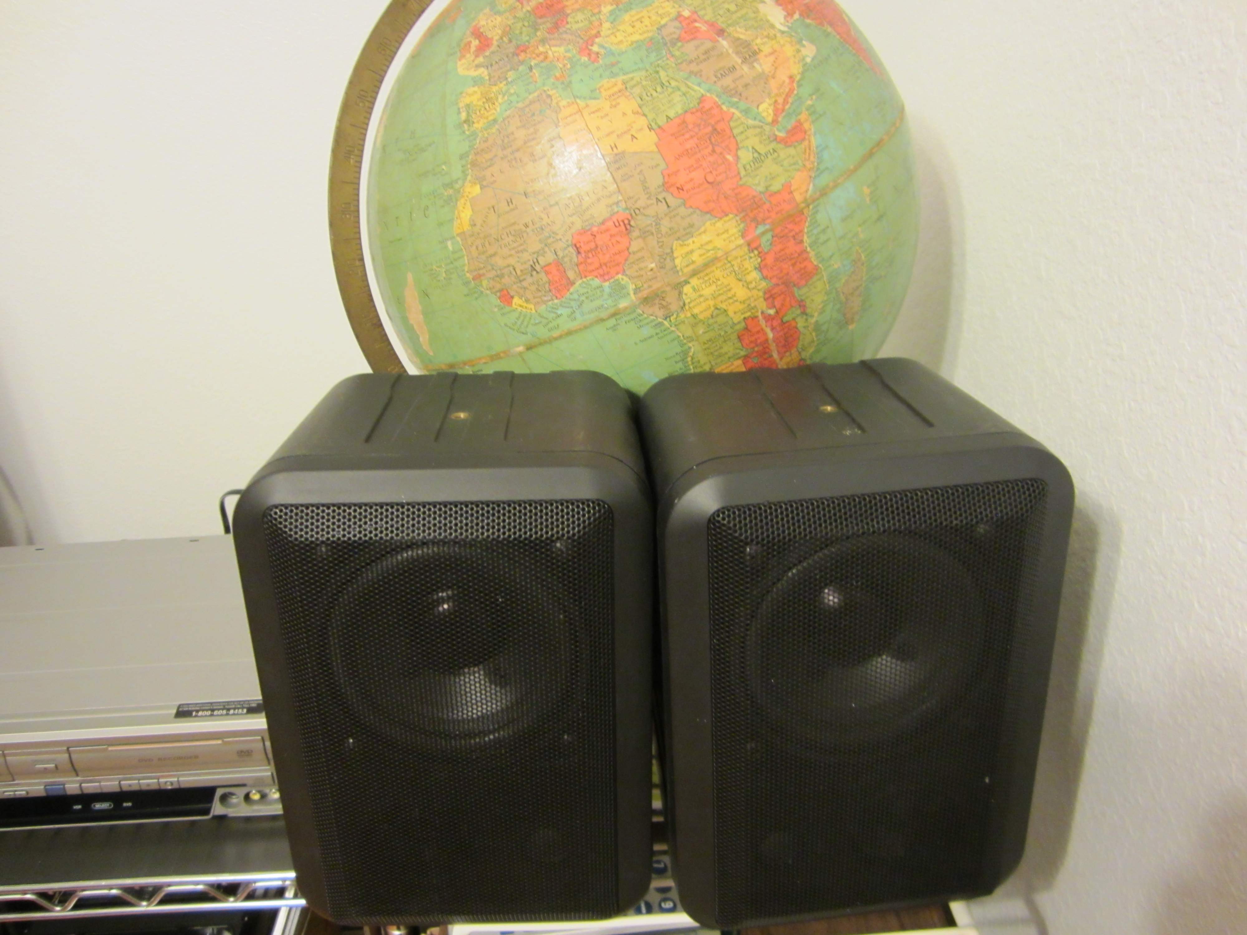

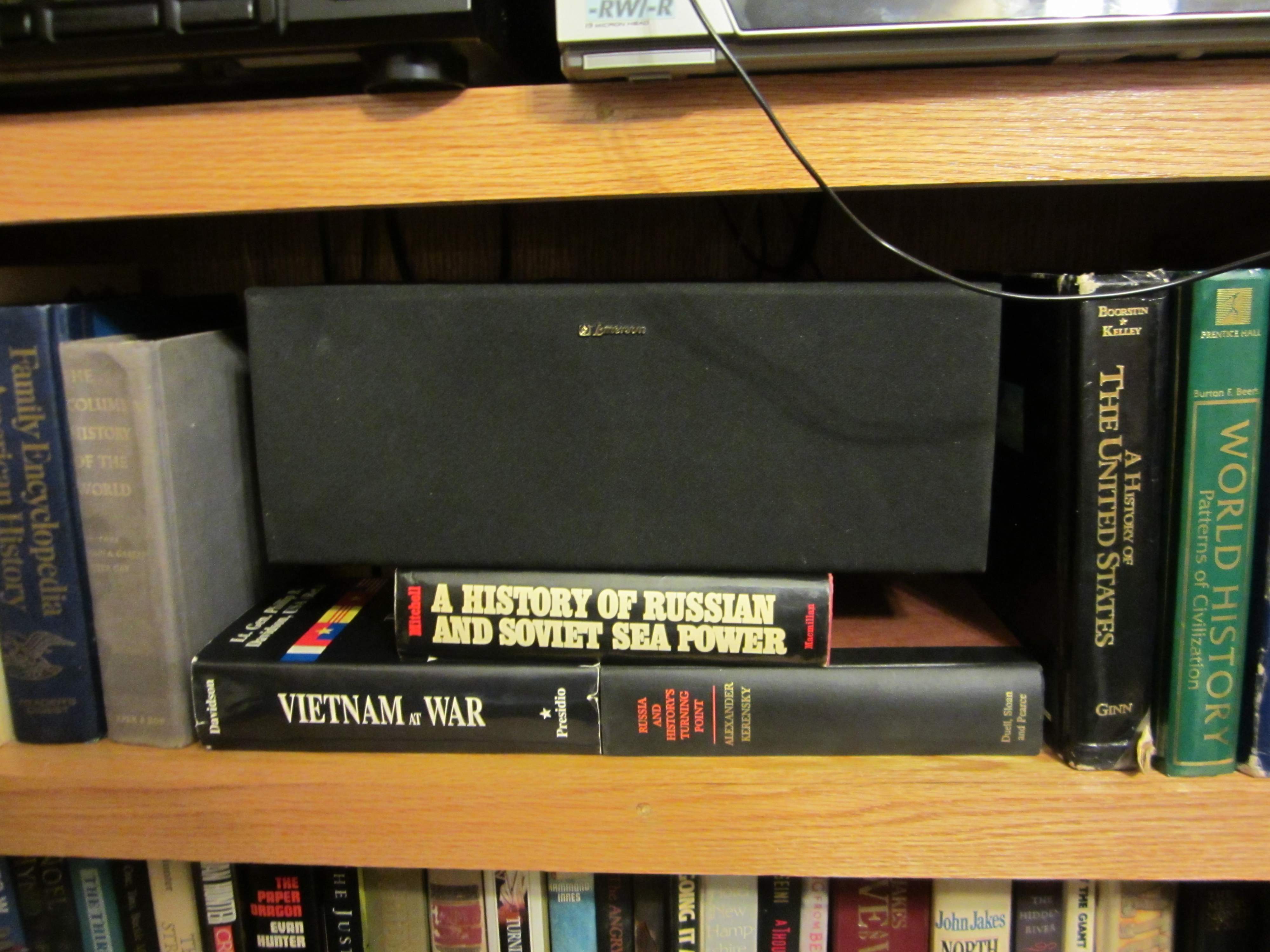

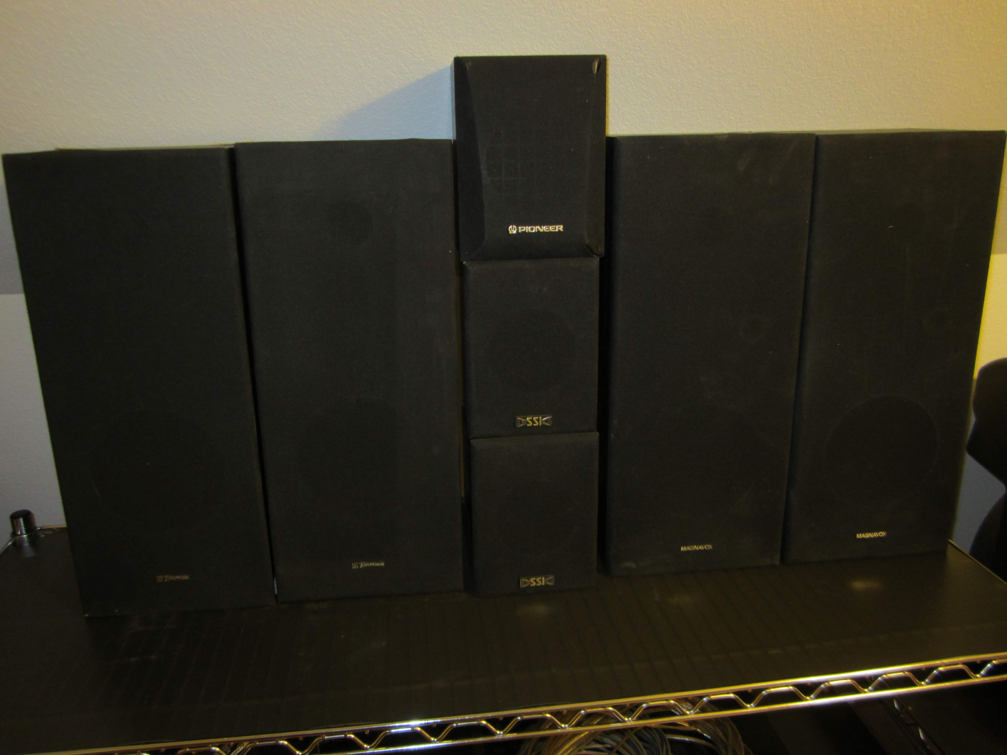

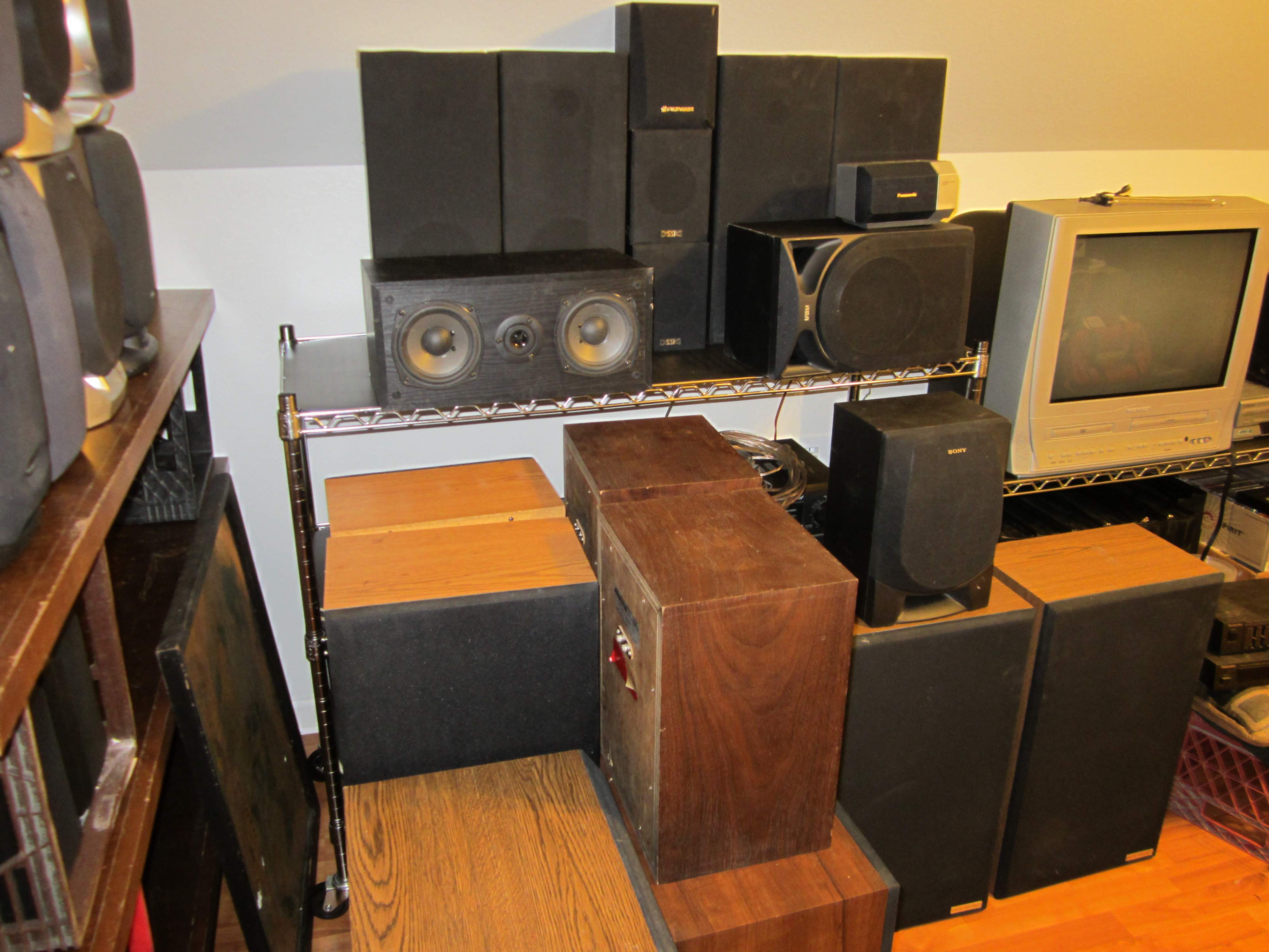

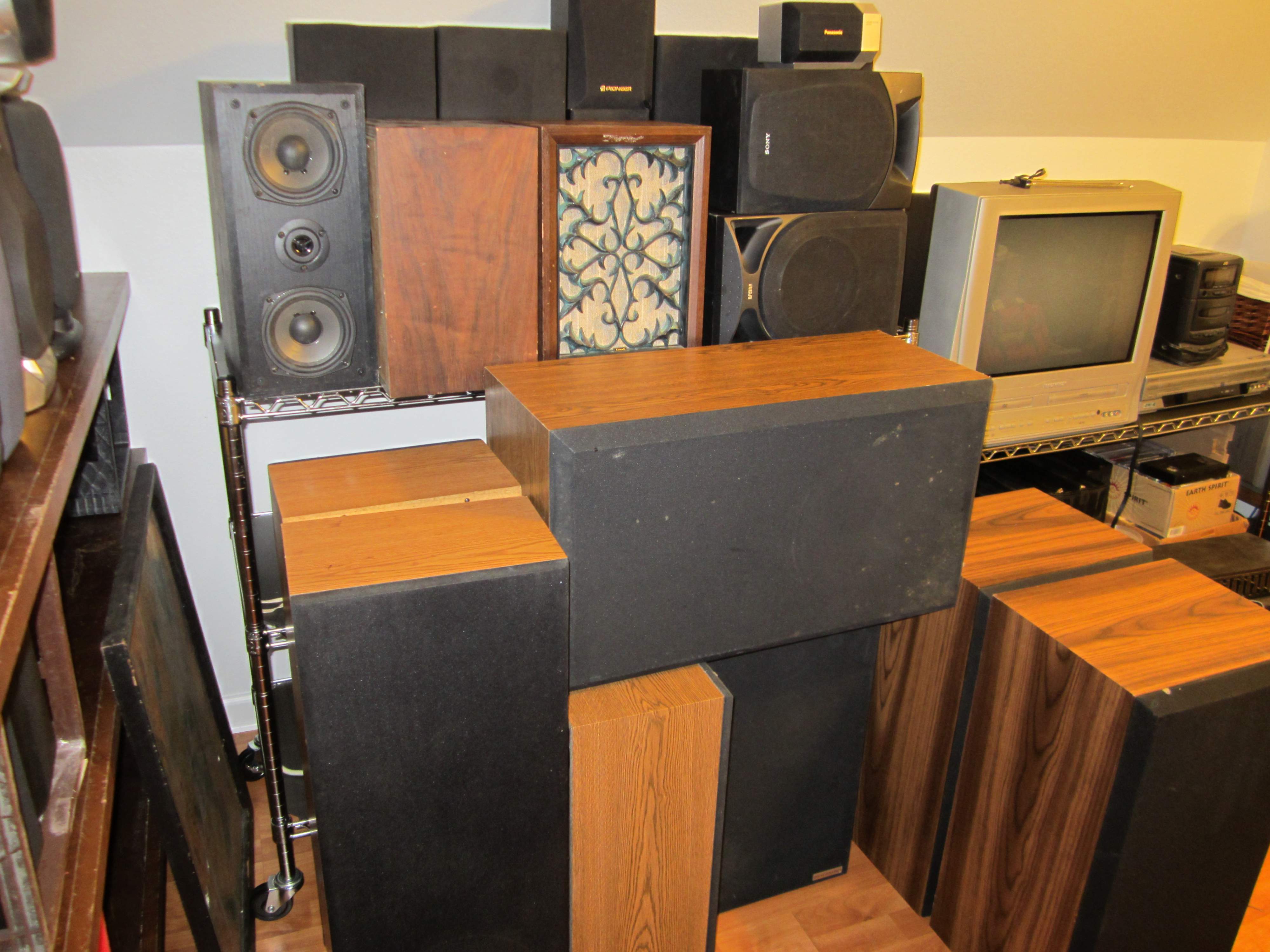

So here are some of the smaller 8 ohm speakers I unpacked tonight.
And with the bigger ones added. They would sound better, but the smaller ones will fit better.
The 6 ohm speakers are all smaller. Some of them are pretty good, too.
Only one set of 4 ohm in storage. I have six or eight of them hooked to another home theater system out in the barn. Trading them out for some of the 6 ohm might be the way to go.
And one good set of 3 ohm. I do have some cheaper ones that I didn't unpack.
As you can see, I have the speakers to do whatever I decide. It's just the deciding I'm having trouble with.

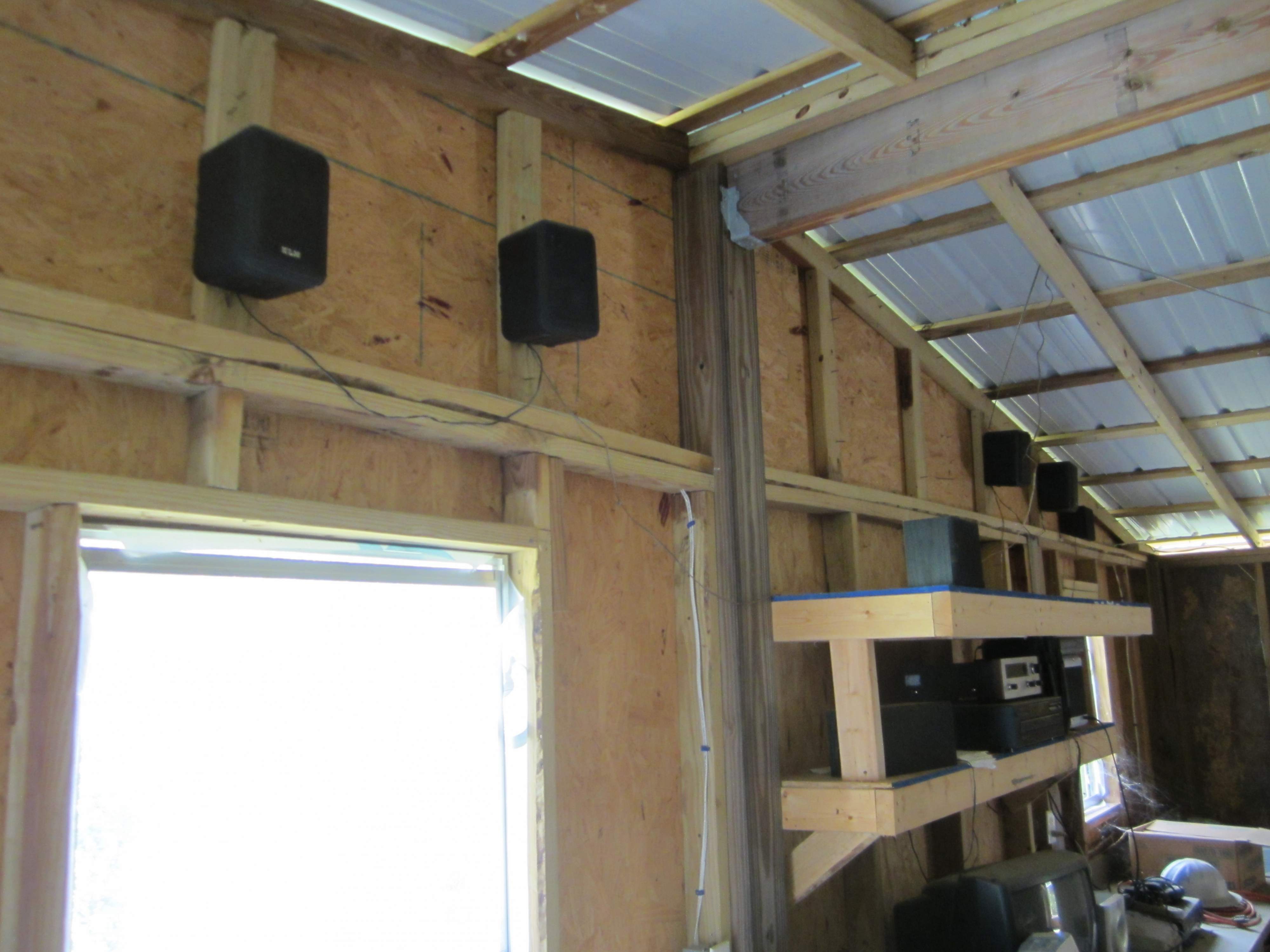

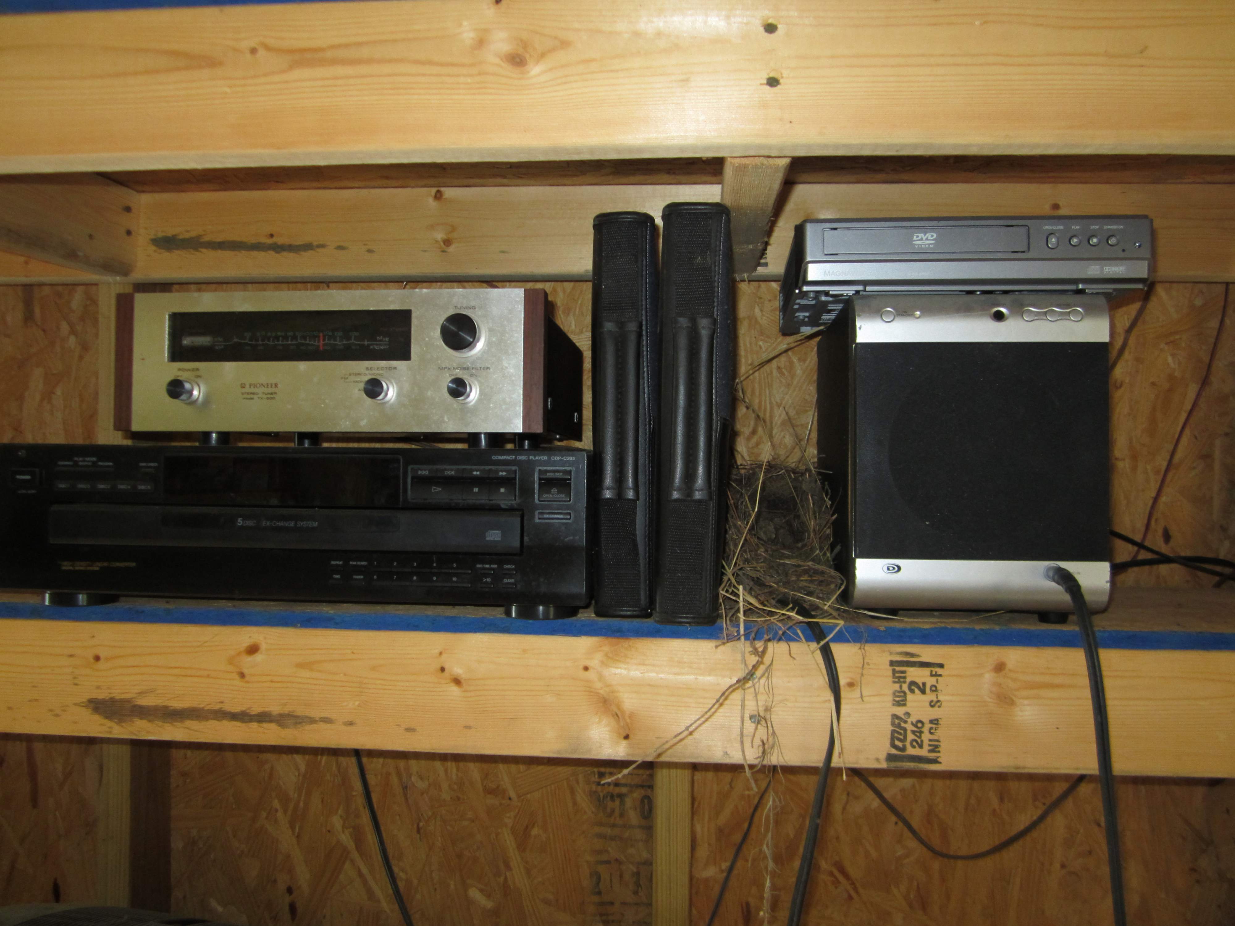

I went out to the barn yesterday to count 4 ohm speakers. I think all seven of them are 4's but I didn't take them down to make sure. I could replace them with 6 ohm and still have good sound out there. The indoor/outdoor speakers are rated at 50 watts, {if they are the same as the ones in the house} but I doubt the little surround speakers can handle that much. Judging by the bird nest, I haven't been using the system very much this summer.

Static is not usually a symptom of component failure. It is more likely an oxidized contact somewhere, like in the wiper of a potentiometer. You might try buying a can of contact cleaner from Ray D. o'Shack and spray all the pots in the system, especially those in the surround circuit. Make sure the contact cleaner is the kind that has lubrication in it. That way you can hook up four 8 ohm speakers and put the receiver into four channel mode instead of surround mode.
   / So I bought a 20 year old Fisher RS636 Receiver at Goodwill yesterday.....
I will give that a try, Troutsqueezer. We have a little shop like a radio shack in Blountstown. I'll run by there on my way to work tomorrow. It would make it simpler if at least four of the channels would work right. Since the balance is right on 2 channels, but not on 4 or 6, it may be in the surround circuit. I will give it all a good cleaning. The RCA jacks on the back had to be cleaned, {I used head cleaner on a Q-tip, then a light touch with sandpaper} so the insides are likely in the same shape.
