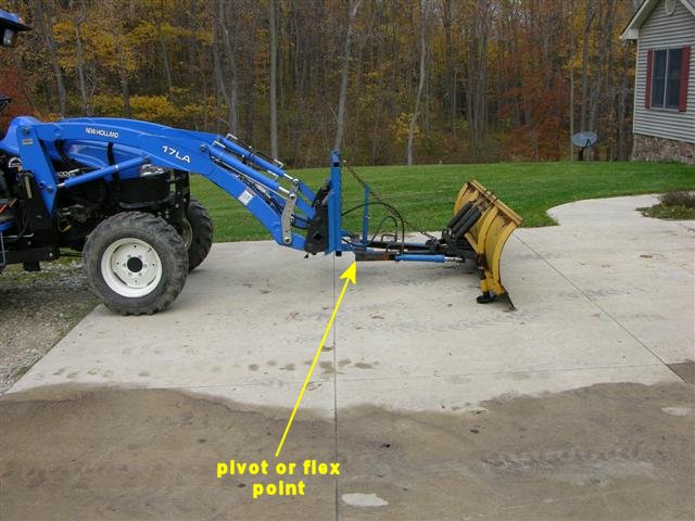

Think I may have been misunderstood.
Here is what we said:
I think that if you use the float position you'll find a loss of steering. I'm thinking some flex between the plow and the loader would be best, then you can lower the plow to contact the drive and steering wouldn't be an issue. That way the plow can follow the contour of your drive.
If you look at the picture that we posted you will see that the blade does indeed flex on the plow mount/loader allowing up and down movement of the snowplow to follow the contour of the drive without loss of steering.
Here is what we meant:
If the loader is placed into float and the loader arms are allowed to contact the ground then steering loss will be an issue.

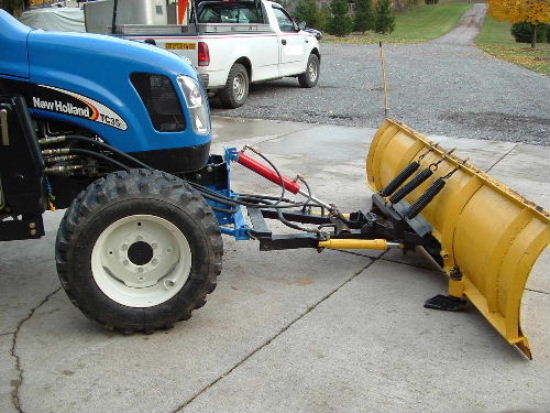

I had my plow mounted on my FEL and I decided to make a mount to hook it directly to the tractor because it was hard getting around my place with the rear blade and the snowblade on the FEL. I decided to put a slip clevis on the plow frame in order to give me 3 inches of float on the plow. Now I can raise and lower the blade and have 3 inches of blade floating.(I hope thats enough float ??) Thanks for all the input. If it doesn't work i'll have to modify it as i go.

Bernie neat looking setup. I'm not understanding how the blade moves up and down on irregular ground with the lift cylinder however. Would think the cylinder might restrict any free up and down movement. Am I confused? /forums/images/graemlins/confused.gif

Here's a closeup of the part I made for the end of the cylinder to slide back and forth. When I let the plow down the cylinder has about 3 inches to float up and down, and if I want all down pressure I can extend the cylinder all the way down. I figure if this works I can have pressure down ,and I can make the plow float.I won't know until it snows.

A one-way ram would have worked as well (at least for plowing snow), but your slip clevis is a good idea too.
To me, looks like your push arms are too high on the 'push' end, and the A-frame of the plow should (I was told) be parallel with the ground.

Now that I see your close-up it's a bit clearer. Please let me know how it works our for you once you have given it the acid test.
I'm also curious how long does it actually take to connect to the tractor?

I have a rear blade to do my grading with. I wanted my front plow closer to the tractor so I could see at night better with the tractor lights and it 's so much easier to get this around driveways to plow snow. The height should be ok, I plowed with my truck before and it had oversize tires and it was the same height as the bracket on my tractor. Only time will tell.
