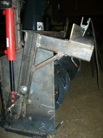

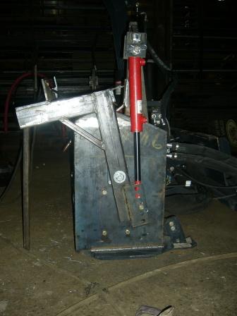

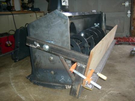

Shovelling may not totally be for me so here is the prototype:
Two cylinders will power it up and down. It will have a poly urethane cutting edge and a plastic blade to keep the snow in.
Should be finished in a few days.

/ Snowblowing
Dsb
Thanks for the reply. Here are some more pics. I'm on my way to the dealer this morning to get his help with the hydraulics. He said it would be no problem to run the cylinders from one of the extra switches behind the joystick.
There are 3 of them in a row. The first 2 will run the chute on the blower. Up / down and rotate. the Third switch will raise /lower the back drag.
Still left to do:
install poly cutting edge
plastic gliders
poly blade to hold deep snow in
hydraulics
paint

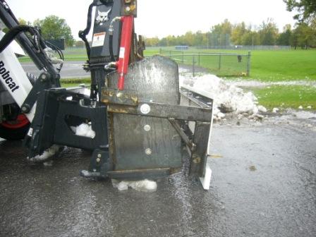

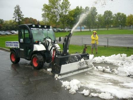

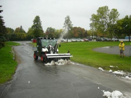

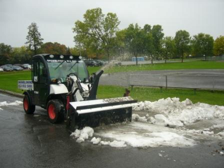

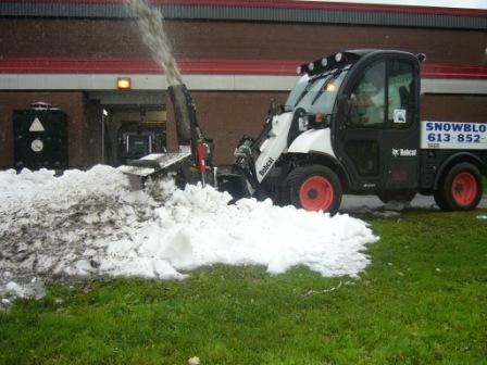

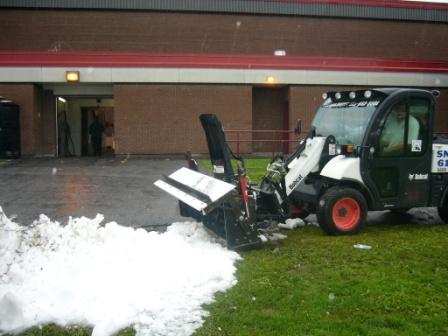

/ Snowblowing
The hydraulics are finished. It works really good.
We went over to the local hockey rink and found some snow to blow!
Just the detail work now like paint and touchups.
