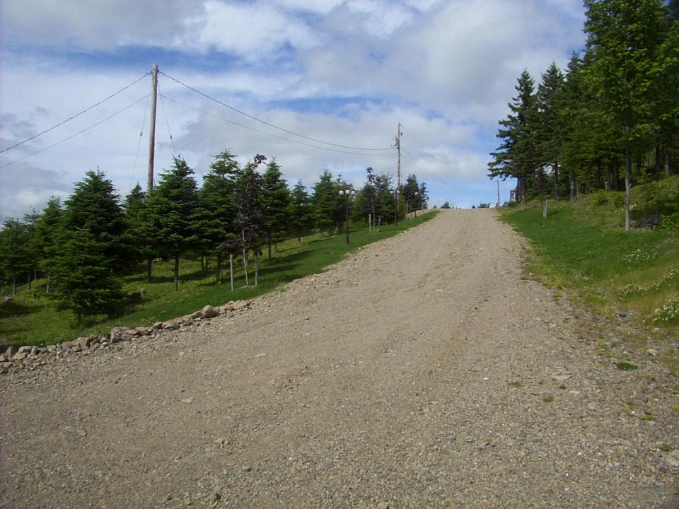

That good unless you have a sloped driveway. :)

Unless your driveway is paved; or you are in a relatively warm or sunny location; I can't see how you are going to get down to bare driveway with a plow either. You'd have to try to set plow so low that you'd scrape all your gravel off. In cold conditions hard packed snow is actually quite grippy; it's when it's a bit above freezing that it's slippy. Our gravel drives (Muskoka area of Ontario, lots of snow) are snow covered year round. There's a few days when chains on the hills are advisable (esp. with 2WD but 2WD with chains is better than 4WD) for cars/trucks and I use them on tractor all winter. Highly recommend the diamond chains for cars - very easy to put on/off.
