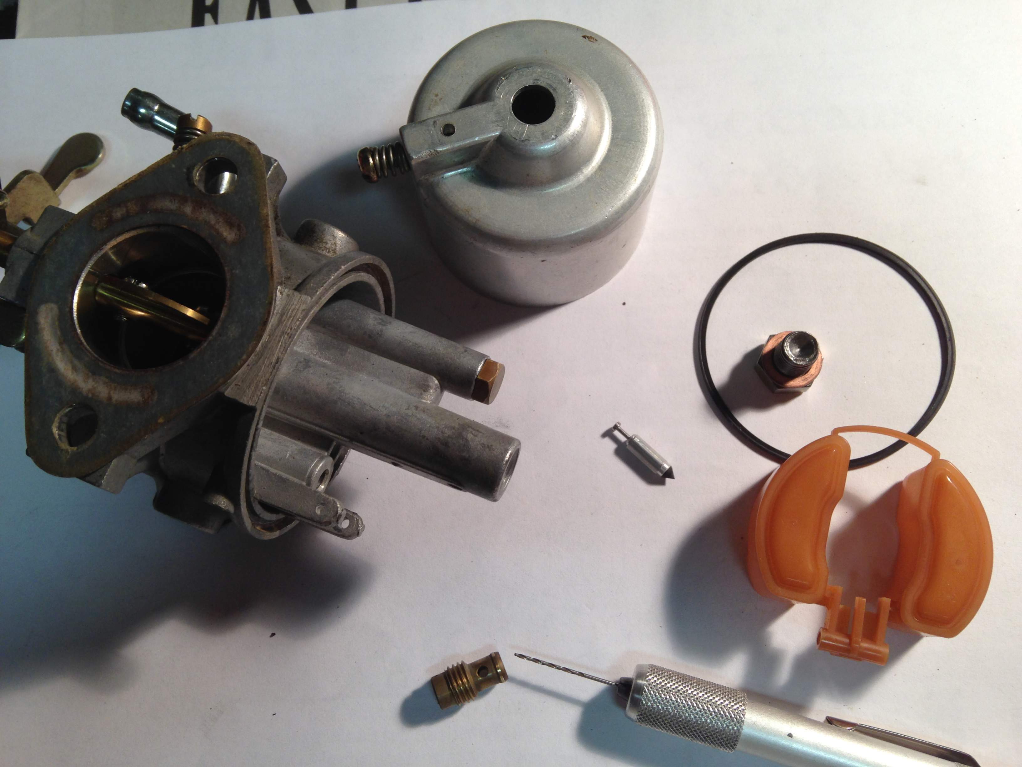

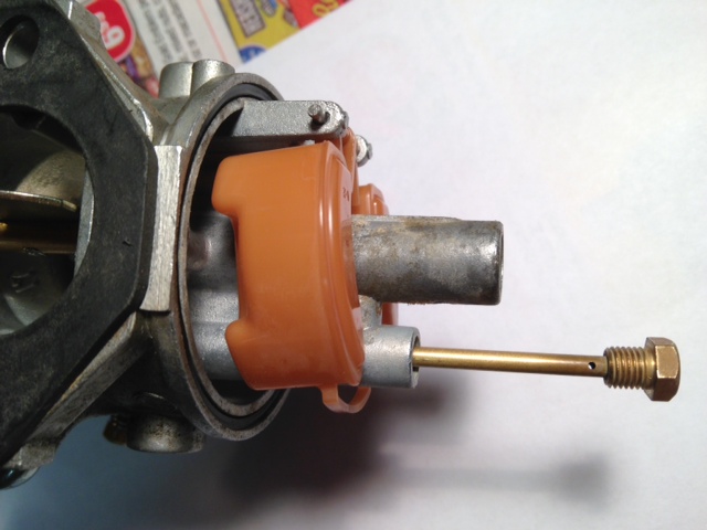

I am making progress. There was a jet I missed in my first cleaning. This Yamaha carb is different than the ones I saw on the YouTube videos. It has a 2 inch long tube that threads in the bottom of the carb and is not part of the bowl bolt. After I cleaned that long tube, it idled just fine. I included a picture in case someone else has this model.
I still have a problem with lunging at full throttle. It seems like the engine stumbles and the governor opens the throttle. If I go to half choke it runs OK. I cleaned the main (center jet) so I am not sure it is a fuel issue. I will clean the plug next.

Sounds to me like there is still a blockage somewhere. When it runs okay with partial choke, that pretty much tells me it's starving for fuel. I'd remove the carb and take it all apart and clean it again, then blow out all the passages and the parts. Spraying the carb with carb cleaner loosens the dirt, but you need to move it out of there with air pressure, otherwise it will just find another place to rest. Remove the float and needle valve (no air pressure on the float tho) spray the float with cleaner (unless it's cork, which it does not appear to be) and just let it air-dry on it's own, wipe down the needle valve with a clean shop towel, then blow it off using your breath. You could use air pressure, but chances are it's gonna blow out of your hand and you'll never find it. There's no reason to remove the needle's "seat", but air blow that too. Be very careful not to disturb the float setting-tab or you'll need to re-adjust that height.
In your picture, it's hard to tell if the carb body (inboard of the "O" ring) is dirty or it's just stained. If its dirt, get rid of it - it will eventually cause problems. That tower looking thingy (technical term) between the float looks dirty too, clean that as well. Take your time, you're getting there.

I can't see a breakdown of your carb online but I can tell you that Japanese carbs have some very tiny orifices for the low speed circuit. Like everyone says you DO have a partially plugged jet somewhere. Look CLOSELY inside the carb body with the butterfly shut. Now look for transitional ports that the butterfly just passes by when you just crack the throttle past idle. Follow the holes(s) down to the respective jet. Once you find this tiny orifice you will find a way to clean it and trouble be gone.
Beware some of these Japanese carbs use plastic jets and damage very easily. I can tell by your nice photo that there has definitely been water in the carb fuel bowl and corrosion has set in somewhere. You can pick up a set of 300 magnifying (reading) glasses at Walmart for a few bucks and with a bright flashlight you can really see these tiny jets and the plugging.
