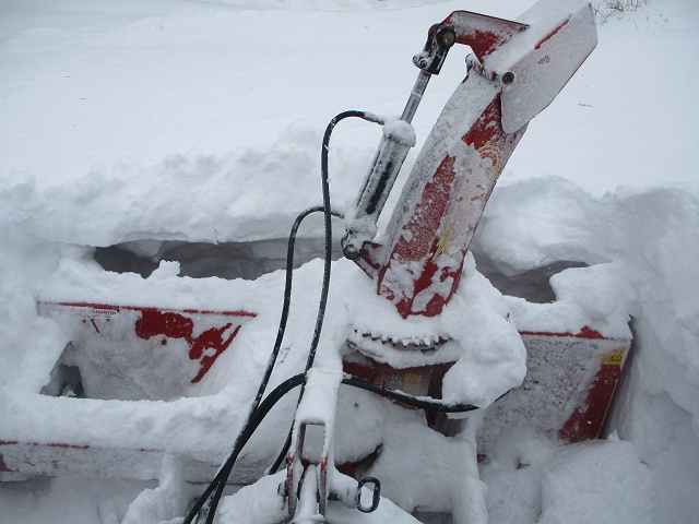

I ran 78" rear push on 42 PTO HP and was ok power wise. I have same size on 64 PTO HP now and have power to spare, but gear drive so can only so slow.
I will assume you are hydrostat, so less concern on width as you can go as slow as you want, having said that, you likely will want to be moving at a decent speed to allow momentum to keep you moving. As long as it's width of the tractor or wider it's decent, I'd likely pick the 78"
I'd think the WEIGHT of a 90" might be a concern.
Also, if you get deep snow you can't drive through, the rear pull might simply be a nice counterweight for loader use.
