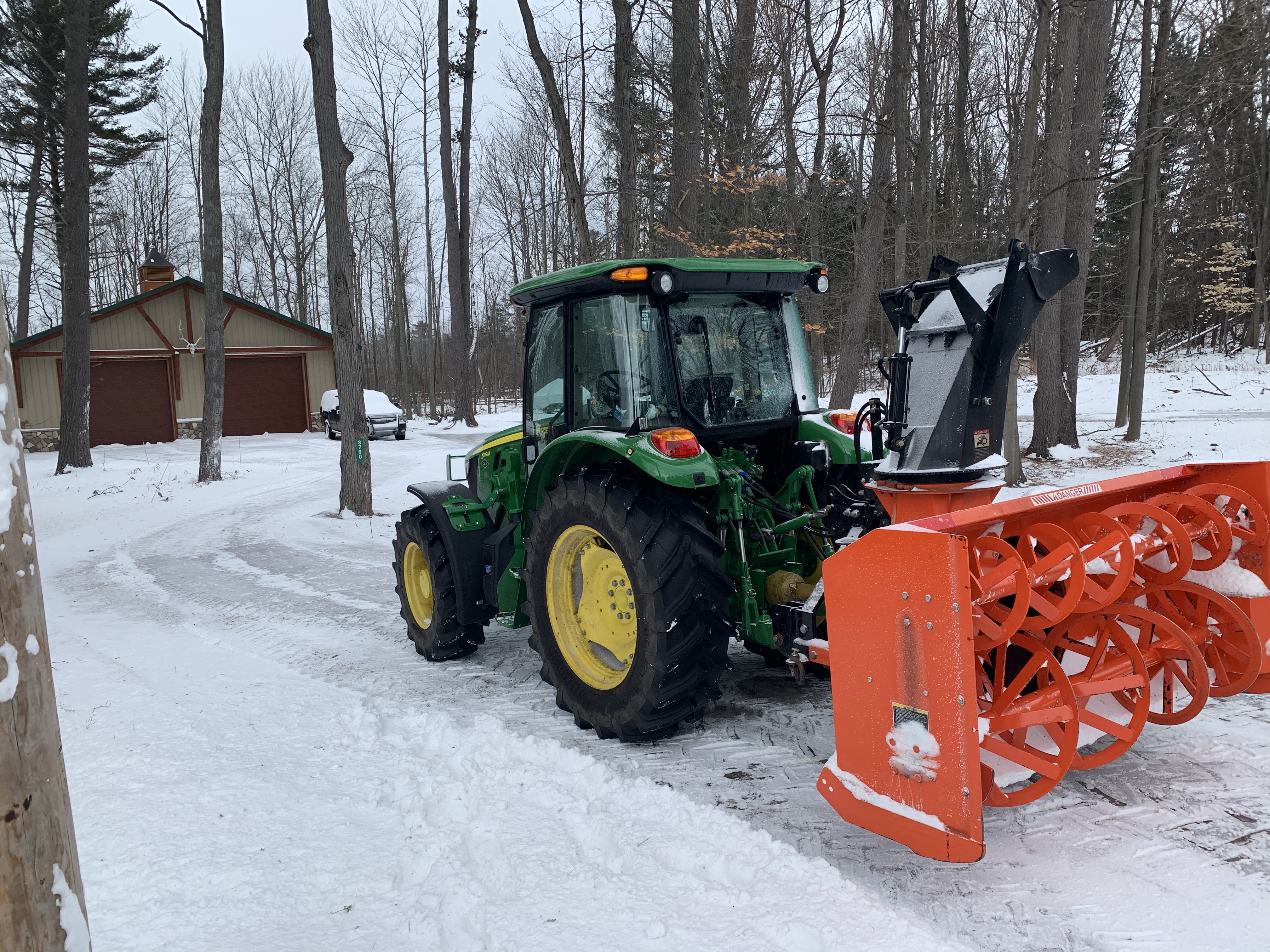

I’m in Northern Michigan so similar winter conditions and have been using 3pt snow blowers since 1985. I take the shoes off , never use them . Most drives I do are asphalt , some are road gravel. I personally wouldn’t want a pipe covering the cutting edge as it’s going to inhibit feeding of snow into the augers especially on wet heavy snow, you’ll end up pushing a growing pile.
Early in the season before the road gravel drives have frozen up solid I’ll shorten the top link slightly to help keep the cutting edge from digging then use the 3pt control to keep the cutting edge a inch or two above the gravel as I go . With a little practice it’s not to difficult, once winter sets in and ground freezes I let the top link out and run the cutting edge directly on frozen road gravel.
Not sure what trap rock is but if there’s no binder it may not ever freeze up solid , if that’s the case I’d get rid of it and replace ASAP. Pea gravel drives up here are terrible, can’t freeze up with no binder, all you can do is keep blower elevated above them all winter.
Here’s a pic of a buddies drive I occasionally do that’s road gravel early in the winter I believe.

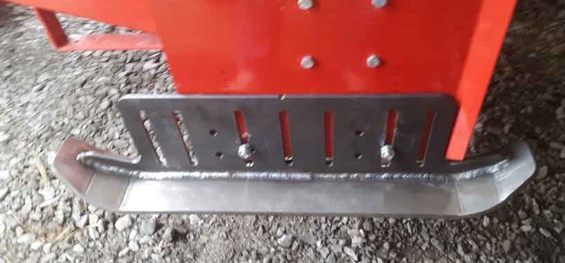

I have the exact same blower. I put bolt on Edge Tamers on mine. One on each end and one in the middle. Zero problems or issues. I have a gravel driveway and never pick up rocks. Works well on the grass approach to my shed also.

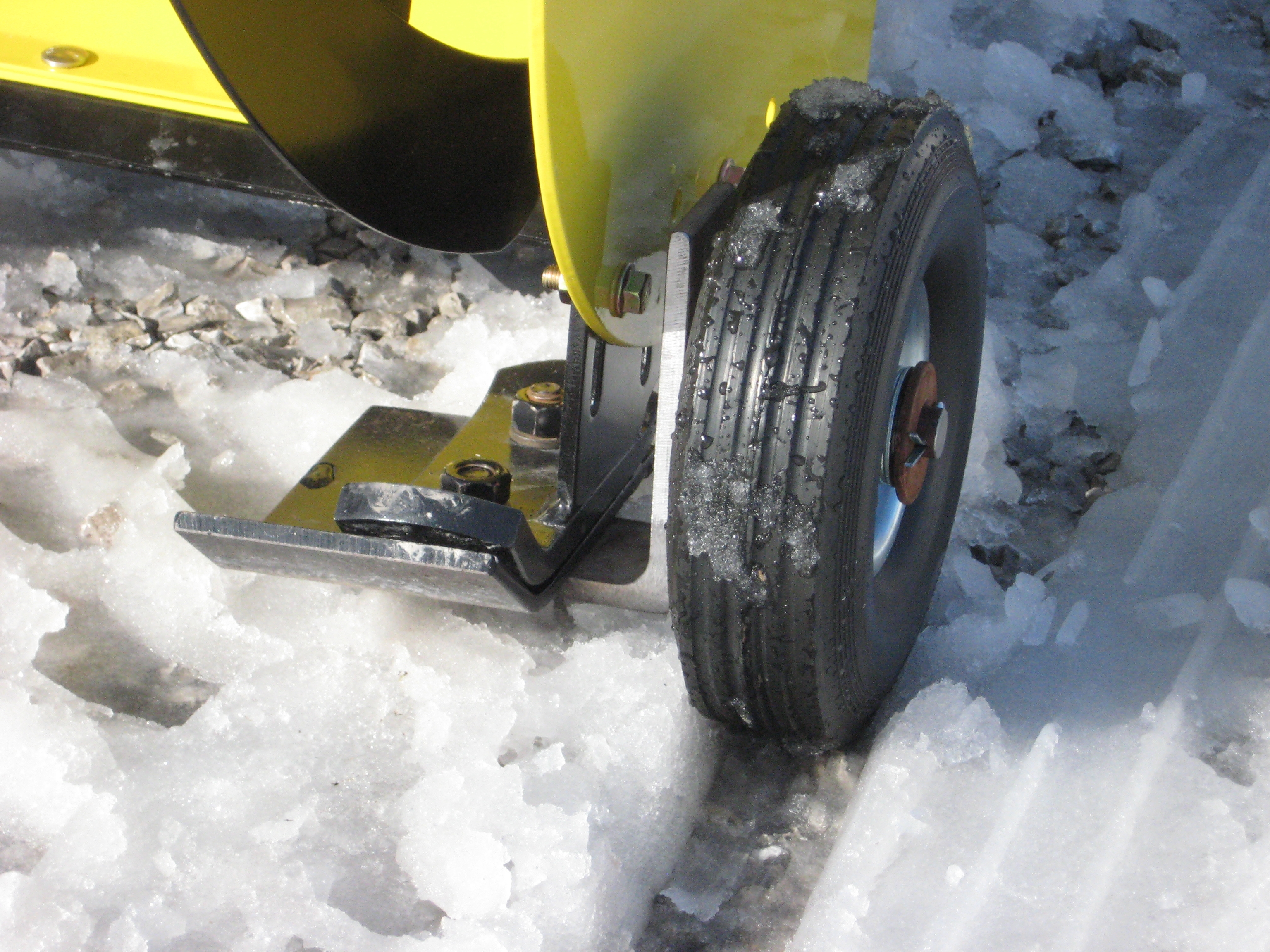

You can also add gauge wheels to the blower.

Thanks for the responses guys. I think I'm going to go the homemade edge tamer route. I would think those shouldn't be hard to make.
I don't think the trap rock will be long for this world, especially after the asphalt drive gets replaced. It will most likely just get mixed in. It does look nice in the summer though. Before getting the blower, I would use the 3pt blade on the trap rock and then just be sure to keep the snow pile in the parking lot. In the spring I would rake it all back to where it belongs.
