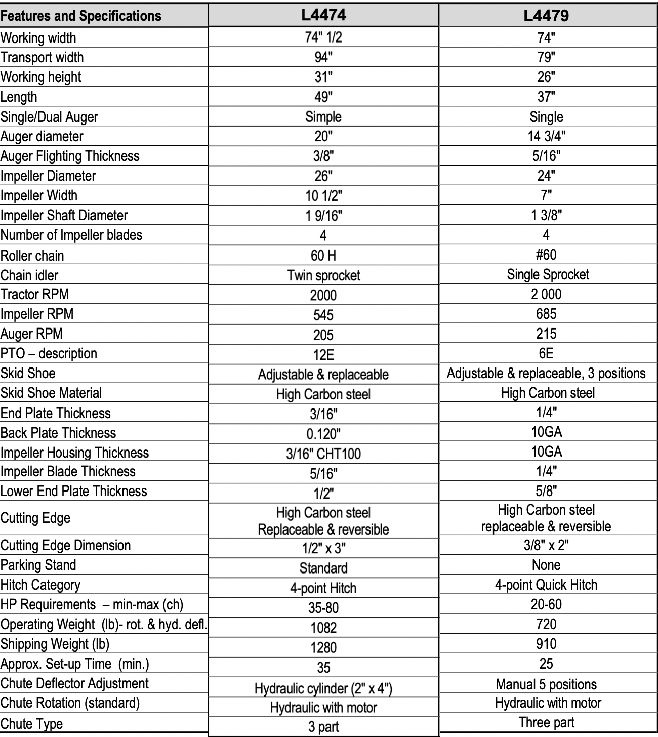

Hello
if you have a 62hp tractor (L6060) with 53hp at the pto would you rather operate a utility snowblower rated for 20-60hp at the PTO or a larger, heavier commercial snowblower rated for 35-80p at the PTO?
cut widths are the same but the commercial has a bigger fan and auger and several hundred more pounds.

larger, your only 7 short of the max HP, the commercial puts you in the middle and far enough from the bottom where you should be ok, just make sure the weight is not going to push you around.

A bigger fan clears/blows more snow.

The cutting widths may be the same, but it's very likely the commercial blower will process snow faster with a larger fan and number of blades.
I have a heavy duty commercial blower for my L4060 and it works when I need it.

I recommend the commercial blower. It should work better in deeper snow and last longer with fewer repairs.

Here are the two model specs side by side:

I think Kubota snowblowers are made by RAD in Quebec. They are good blowers from what I have seen.
The L4474 blower has the heavier duty gearbox and a bigger auger.
I am not sure what your winters are like but if there is much snow I would defenatly go for the heaver built one.

I'm confused. Didn't your question revolve around your PTO limitations?
Aren't these two snowblowers front-end-loader mounted front units? (I'm not sure . . . )
I thought you were looking for rear-mounted PTO driven units.
