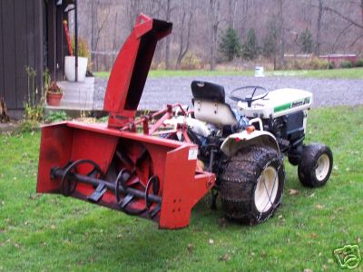

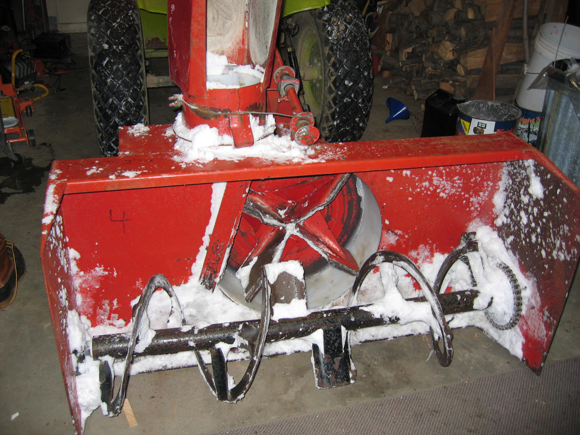

I finally got to try out my blower last night on about 5" of lake effect snow. Admittedly, I'm a little dissapointed with the results... It didn't throw very far (about 6-10 feet) and it plugged up after about 5 minutes. After that it plugged up again very easily. The rest of the driveway was cleaned by using the FEL.
The snow was wet and packable and the conditions were such that the ground is warm enough that after making a pass, the blacktop is wet and bare yet the air temperature was mid twenties. The blower is a 51" Meteor brand several years old. I bought it used on ebay. The picture attached is the ebay picture because I haven't taken a photo of it. I got it for $570 so I'm not really complaining. Perhaps it will work better on a drier mid winter type snow. (What a strange year this is!) My previous experience with snowblowers is a single stage on the front of the wheelhorse which I think would have handled yesterdays snow much better.

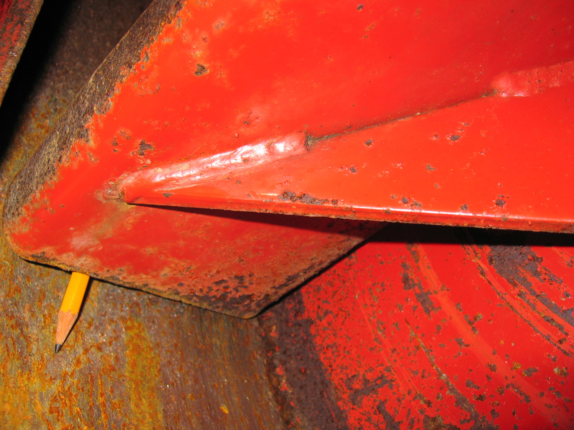

I'm curious, what is typical for the clearance from the impeller to the wall? Mine is about .200" which may explain some of the limited throwing distance. Also, I'm wondering if any of you have treated the blower inside surfaces with an antistick treatment. Pam spray or graphite paint? It's clear the former owner had a gravel drive and the inside is a bit rusty.
Let me know your thoughts.

If you are running at PTO speed that unit should be throwing 5" of snow at least 25-35 ft, if not more. Blowers are designed to run at PTO speed. Any speed less will give sub-par performance.
In addition, the design of the fan, the fan shroud, and the chute will also deterime performance. About 2 years ago we had a long discussion here regarding this and the general consensus was that the fan clearance between the shroud and the angles of the chute as it comes from the shroud can have a striking effect on performance. A 1/8" clearance between the fan and shroud is plenty. Any more and it will effect performance. At almost 1/4" you are approaching what I would consider maximum. But still you should be throwing farther at PTO speed.
In any case, if you blower cannot throw 5" of snow at PTO speed then something is not right.

Getting rid of any rust first is imperative. I had a Ford blower with a little rust and everything stuck to it. I sanded it very smooth, painted it and then sprayed it with silicon wax and virtually nothing stuck to it.

If you've got rust in your chute (sounds painful) you need to either paint it (Leave some rust and use "rust killer" like 3M "Rust Avenger" or "Rust Reformer") and then enamel paint
Since it's too cold to paint now you might just sand all the rust then wax with car stuff (turtle wax) and/or get a skier friend to give you some warm weather wax--usually pink or yellow and rub it on then heat it in with a propane torch or heat gun. Then spray some Pledge furniture wax on top of it. Wouldn't hurt to clean and spray wax the business side of the impeller paddles, too. It's all about velocity.
Running PTO speed you should shoot snow an EASY 25 feet
De-wax this summer and paint it.
