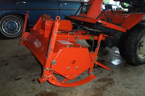

Do you know the rpm and direction of rotation of the Ariens? If not, I'm sure other TBNers can help out. If both are the same as your BX, then no problem. If only one of them is different, then big problems. If both are different, then maybe fewer problems. I converted a Kubota K420 tiller from 3ph to front mount. The tiller was designed for 540 rpm and the low range pto speed on my F2400 is 1100 rpm. Also the direction of rotations were opposite. I overcame this by putting a 2:1 reversing gear reducer (cost about $50 used) on the drive of the tiller. This corrected both the rpm and direction of rotation. The atached picture shows the added transfer case at the tiller end of the drive shaft. It works great. I hope you have the same luck! /forums/images/graemlins/smile.gif
   / Snowblower modification front to rear? #3
That tiller is interesting. Do you drive backwards to till?
A more overall pic would be great.
Good design and pic of the gearbox addition.

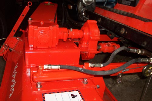

The orientation of the tiller hasn't changed so I use forward motion for most of the tilling. However this does leave tire marks on the tilled area, so for the final pass I often do a pass in reverse. One modification that may be a little different is that I mounted a hydraulic cylinder on the top of the tiller body to control the angle of the rear flap via a cable. Attached is a larger picture of the unit. /forums/images/graemlins/smile.gif
