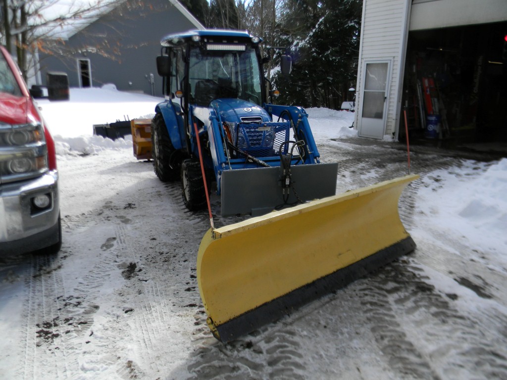

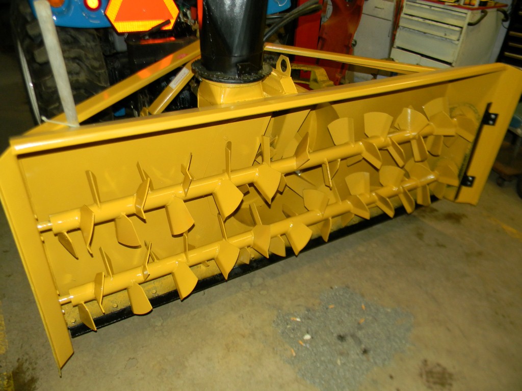

I would have liked a front blower but the price was too cost prohibitive for just doing a handful of driveways I do. I am happy using an old 7 1/2' truck plow I adapted to a QA plate on the front. Then I found a used 84" Lorenz double auger 3 pt. blower at a great price on CL. I refurbed and painted that and now use both where needed.

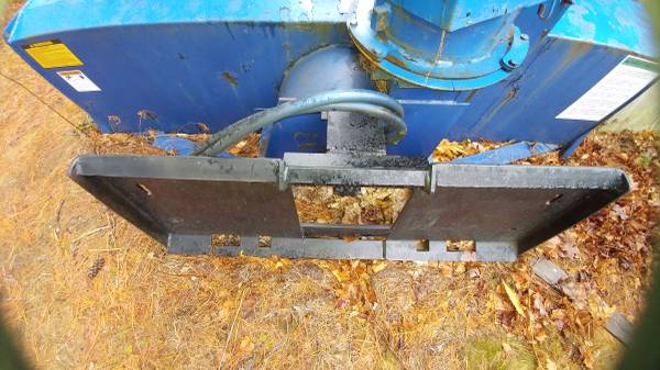

I have about one mile of gravel roads that cut through the woods that have to be kept open, We have been using a pick up with a plow but as the snow banks get higher you just run out of room.I am hoping to get a snowblower to blow all the snow into the woods.We just got another 2' from yesterdays nor'easter and when the snow really piles up and snow banks get to high we have to hire someone with larger equipment to push back the snow banks.I know the rears are less expensive ,but I hate the thought of turning around looking back the whole time I am using the snow blower.I did find this on craigslist I do not know if it would work on my tractor.7' snow blower skid steer bob cat tractor attachment high flow trades
In short, NO.
The long version is a bit more nuanced. You could mount it on a SSQA loader & hook it up to your hydraulics. It would even spin. But tractors don't have nearly enough hydraulics to run one. That answer goes for a low flow impliment & that one is even worse needing high flow. You could buy or make a PTO powered hydraulic system to run it but that would cost several grand extra & be less efficient than PTO.
