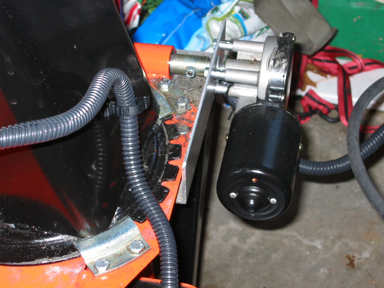

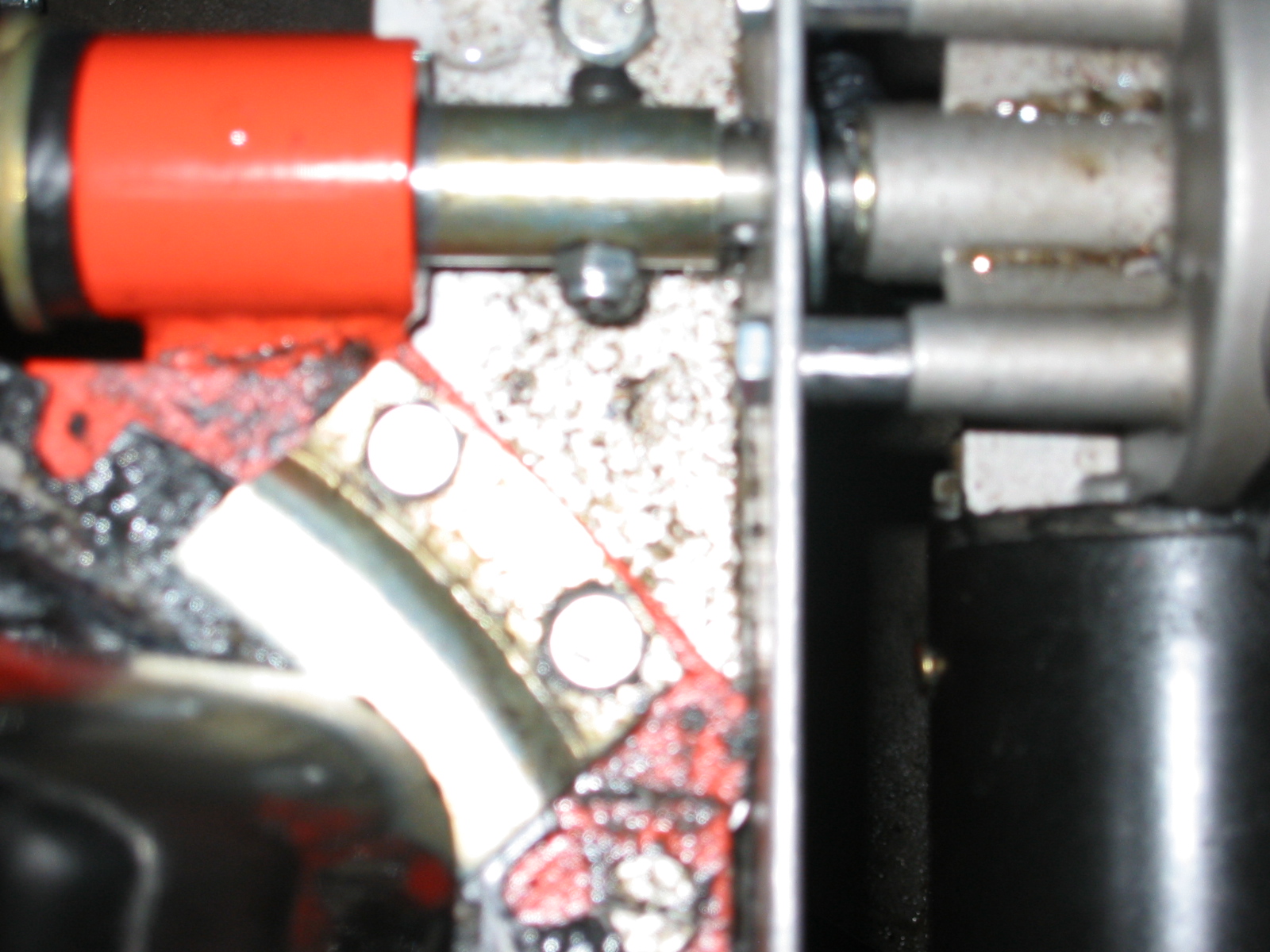

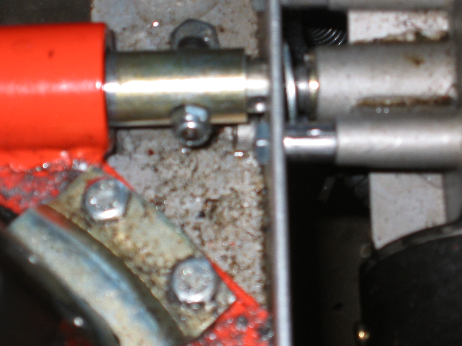

Hello JWATT
how did you hook the motor up to the chute rotator rod ?
maybe you could post a photo of that connection
thank you
   / Snowblower electric chute rotator motor resource. #6
Here's some close-up pictures and hope they help.
   / Snowblower electric chute rotator motor resource. #7
Thanks for the photo
that is what i needed to see to make mine work right
now its just waiting for everything to show up
thank you again
