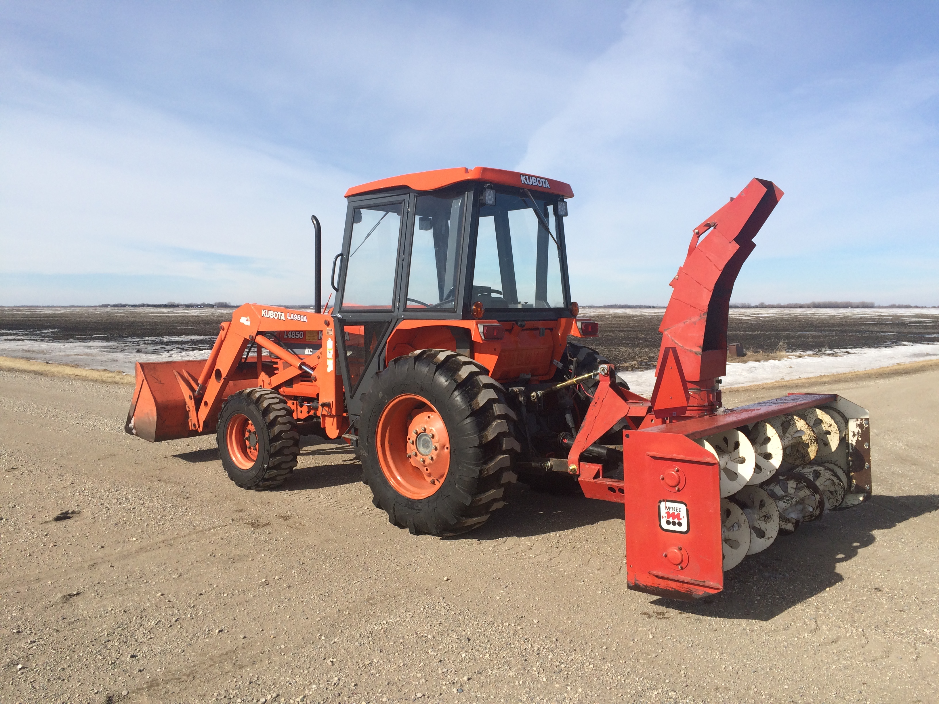

I am really pleased with the way my rig moves snow. But I made an observation and got to wondering about a possible improvement. Most use so far has been on pretty deep stuff and I was done in 1st or 2nd gear and the 7 ft blower was running full. Today was different in that there wasn't much snow and I was running in 4th a lot of the time and even then the blower was no where near capacity. There also was very little wind to blow away the snow. This resulted in a constant snow fog around the tractor from snow that came out the bottom 1/2 of the chute. IMG_2782.JPG I got to thinking....what if the chute was enclosed a little higher than it is? Would this cause more of the snow to be in the stream and less to slow down and fall out of the stream?

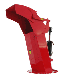

Has anyone ever modified their snowblower chute by covering up some of the bottom part? I am thinking of making it look more like this:

On the red chute you have a picture of that is a Pronovost semi-industrial chute. I understand they are quite a good chute. The lower inside panel is removable with a catch.
From what I have seen having a door or inside panel on a chute will reduce the amount of fine snow that falls off of the rest of the snow. With a door there is still a fair bit of fines in addition to the main snow that gets blown out because the fan is blowing a lot of air and that still has to go somewhere and there will still end up being a bit of the fines blown around no matter what. The chutes with a door also will plug up more easily in wet snow or if the RPM is to low and the snow feed to high.

I think the source of the problem is the amount of clearance the fan has within the shroud. With fine, dry snow in small amounts the fan doesn't throw the snow as much as blowing it: there simply isn't enough snow to make it work.
I have the same issue with my 3pt blower, it works great with larger snowfalls; but with only a couple inches it creates a dust storm of snow.
I have thought about adding some type of heavy rubber or plastic to the fan blades to somewhat close the gap between the fan and the shroud, but haven't got around to it yet.

When I had a snowblower, I had the same experience as Rustywreck. Small amounts of snow would created a snow storm/snow fog. The chute on my blower was enclosed as you show in the "red chute" picture. This snow fog probably "clouds" your rear window - on a open station tractor like mine was it was a very unpleasant, freezing situation. I would come in the house wet as a hound dog - I finally quit using the blower unless there was at least six inches of snow. I used the rear blade for anything less than 6". The blower was for 6" or more or if I had to move the berms back.

I have the chute you pictured i notice a somel difference with with the door closed versus open- i have noticed that when you are blowing small amounts of snow closing the diverter down makes a big difference

It is a serious snowblower!! 7 ft seems well matched to my ~50 HP tractor. I needed at least 6 ft to clear my tires, and I am glad I got a 7 ft. I only have to clutch occasionally. Since the blower will lift about 16" off the ground, I can always make the first pass with the blower up away and then lower it for the second pass.
