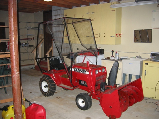

In my experience, snowblowing is fairly easy work for a tractor.
I've used a 36" 2-stage snowblower for a couple of years on my '87 Snapper LT16. It works very well, but the nagging problem is traction. I have about 60 pounds that I hang on the back of the tractor - seems to make a fair difference. I run chains, and it does pretty well, but does sometimes get stuck, usually due to loss of steering. Luckily, I can give it a good yank and pull the thing out by hand. Steering is the biggest problem - I don't have chains on the front, so it can be stubborn, but raising the blower a tad usually gets it going in the right direction.
You'll need a cab, or at least a good shield. It isn't a luxury, it's an absolute necessity. I made one out of sheet vinyl and electrical conduit for $29:
