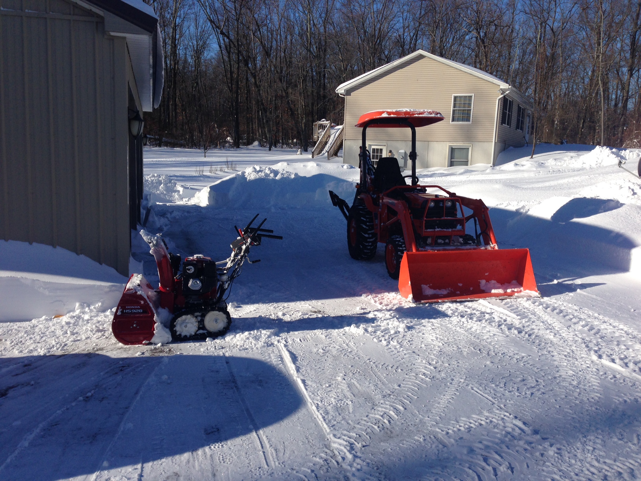

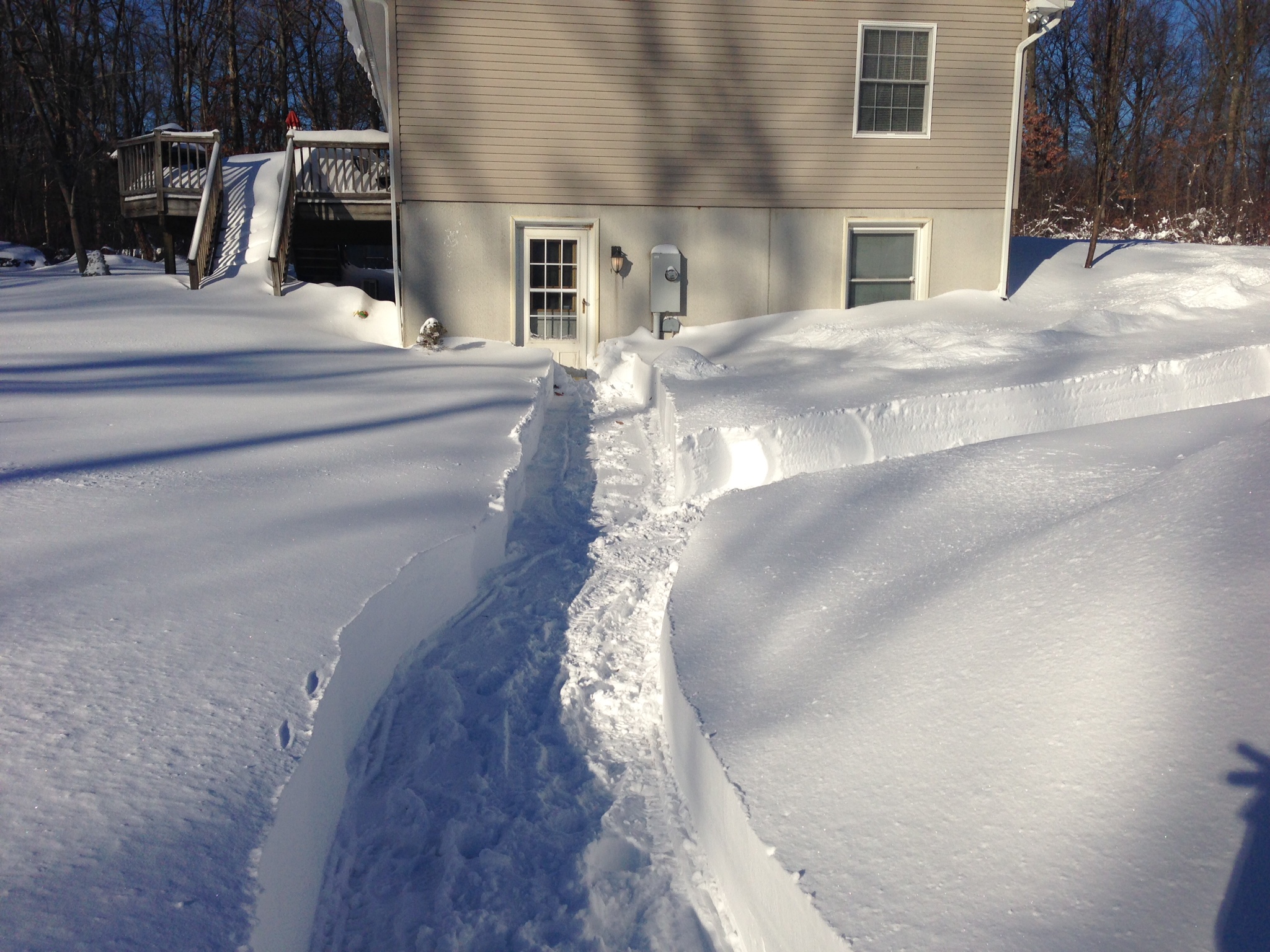

I have a 10hp Ariens that I inherited from my father that's about 10 years old now. It works good but the wheels are kind of useless if you have any sort of slope. It takes very little for them to just spin so I end up putting it in the highest speed setting and just let them spin while I push. On flat ground it would probably be fine. A friend bought a tracked Honda about 8 years ago and it's on a different level. It's like going from a 1980s Chevy to a new Mercedes. Mine is difficult to shift gears, the engine (I do believe one of the last Tecumseh) always needs minor adjustments to run well, and the chute rotation never stays where you want it. The transmission in the Ariens is just a flat round steel plate with rubber bonded to it. A wheel pushes against the plate that's on a shaft so it can slide. The further it is from the center the faster you go. To go in reverse the wheel just moves to the center then past it to push on the other side of the flat plate. When the wheel is in the center there's a piece of steel that prevents the wheel from touching the flat plate, that's neutral. When you squeeze the lever to move you tighten up a belt that makes the flat plate spin. I have a bungie cord wrapped around the crank rod for the chute to give it some resistance. It helps but isn't perfect.
The best thing (for me) about the Honda (and tracks over wheels) is tracks can drive on top of snow. With wheels you have to clear a path to get to where you want to go. For me it's to clear a path from my woodshed to my cellar door. I don't need to make a path from my garage to my woodshed or cellar door other than to get the snow blower to where I need it. That's extra snow blowing. I've never seen the Ariens track snowblowers in person with their hydrostatic drive so I can't say if I would buy the Honda. I have never had any problems with any of my Honda engines so when I do replace my Ariens I'll lean towards a Honda but I will shop around. I'm pretty much set on getting a track drive unit.
