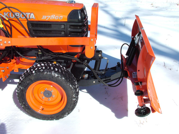

It looks like I am not the only one who has the problem of plowing on a gravel driveway. Last night I was trying to plow ~6" of wet snow. I think I plowed more 3/4" gravel than snow! I had the spacers set so the blade would be ~ 1/2" above the gravel and I used the float position of the valve when I was using the front blade of the B7800, see the attached photo. It ended up after I made a big mess of the gravel I used the back side of the blade while using the tractor in reverse to level out the skid shoe ruts and the piles of stone. I know when the snow melts I will have a lot of raking to do..... Hey wait what a great excuse to buy a new 3 pt rake come this Spring. "Honey you know my back is bad and I just need to get our driveway raked into shape"! Sounds like a Woods or ATI rake may be in order.

If the blade shoes are digging in, that tells me the ground didn't freeze. Bummer... but all is not lost. Consider attaching a 1" diameter pipe (I used black pipe) to the blade. The round shape to the pipe will allow the blade to travel over 3/4" gravel...no shoes required and no digging into the gravel. :D

Thanks, creativity over capital! That is what I like about the members of this form.

Sounds like a good idea. How do you attach it? I would not want to weld it on. I suppose it could be welded to a plate and bolted on.

I wonder if the pipe idea makes much sense for those of us in colder climates, where the ground is usually frozen all winter, which holds the gravel in place (mostly). Seems like a good idea, though, for guys living in Virginia, where a big snowstorm falls on soft gravel, which makes it a bit easier to make a mess of a gravel driveway.
I know I am going to have to re-grade my driveway come spring, to push the gravel back into the middle. No big deal as long as I don't dig into the base. Better than blowing it 20 feet onto the grass.
