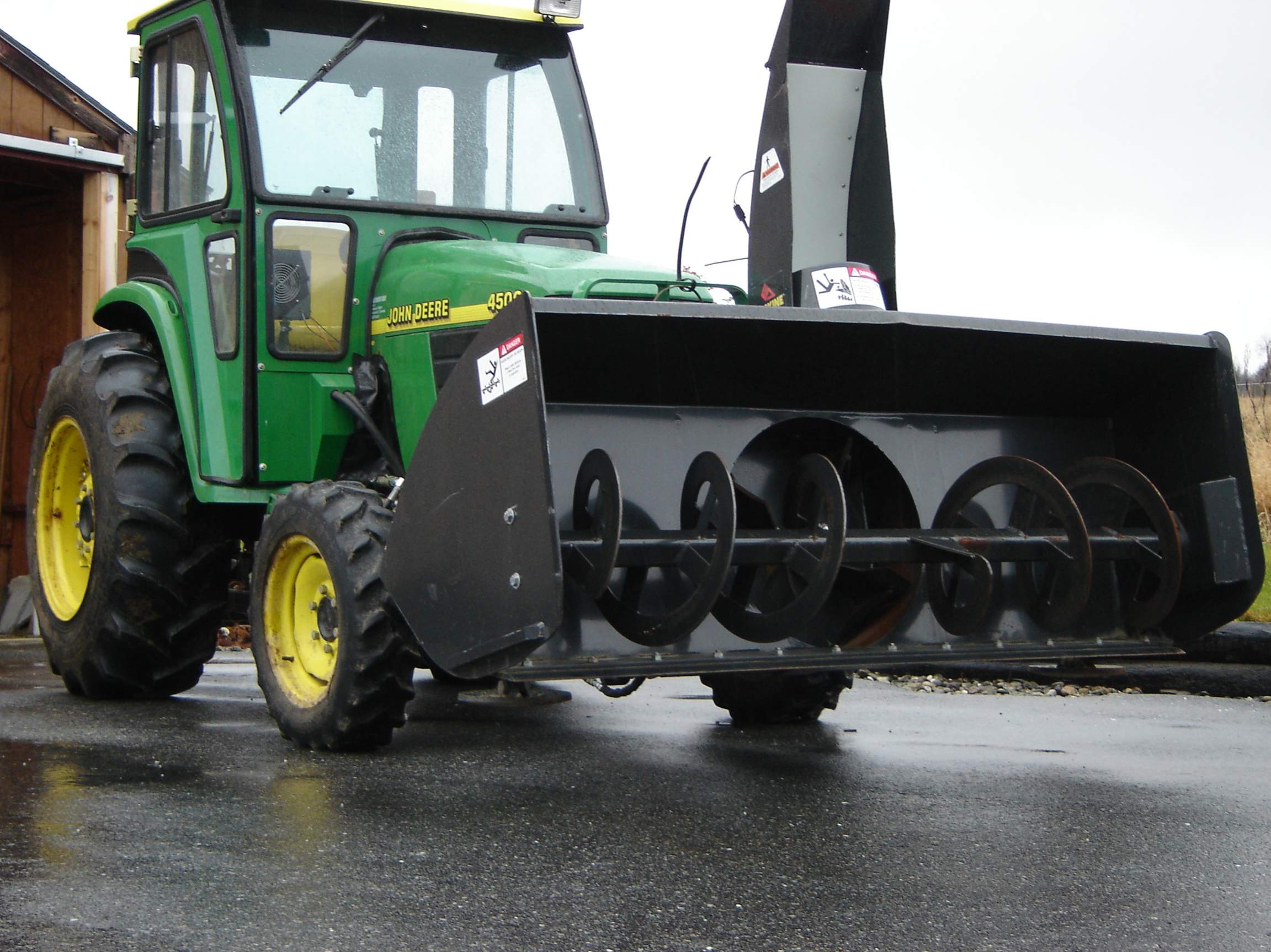

DanielVT - This is what I have on my JD4500. It's made by Erskine. It's a bit over 6ft wide and powers off the rear PTO - takes minutes to attach to the tractor and seconds to remove. Due to neck and lower back problems I can not use a rear PTO implement for anything over 30 seconds. It's pricey but IMHO it's worth it. It should work nicely with your Kabota.
