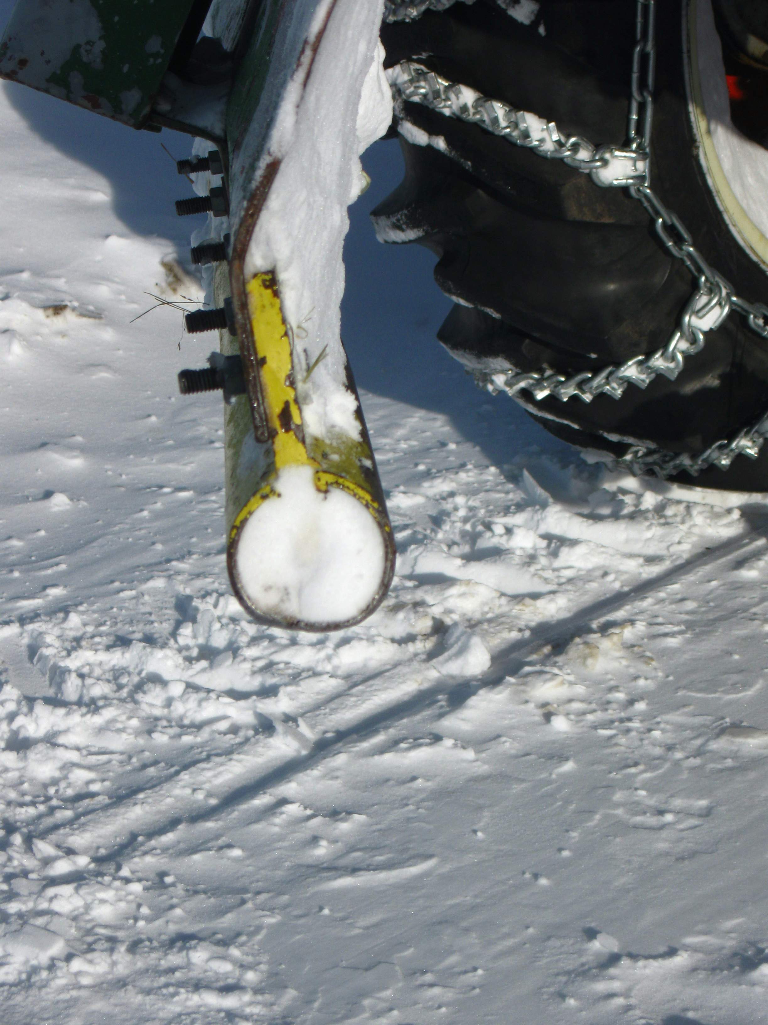

I designed this up in 1989 when I took a welding class and I have used it ever since. Works like a champ!
Slitting the pipe was the easypart. I used a torch on a track to slit it straight. Dealing with the residual stresses in the pipe that made it twist up took some work. The welding was the easy part.
