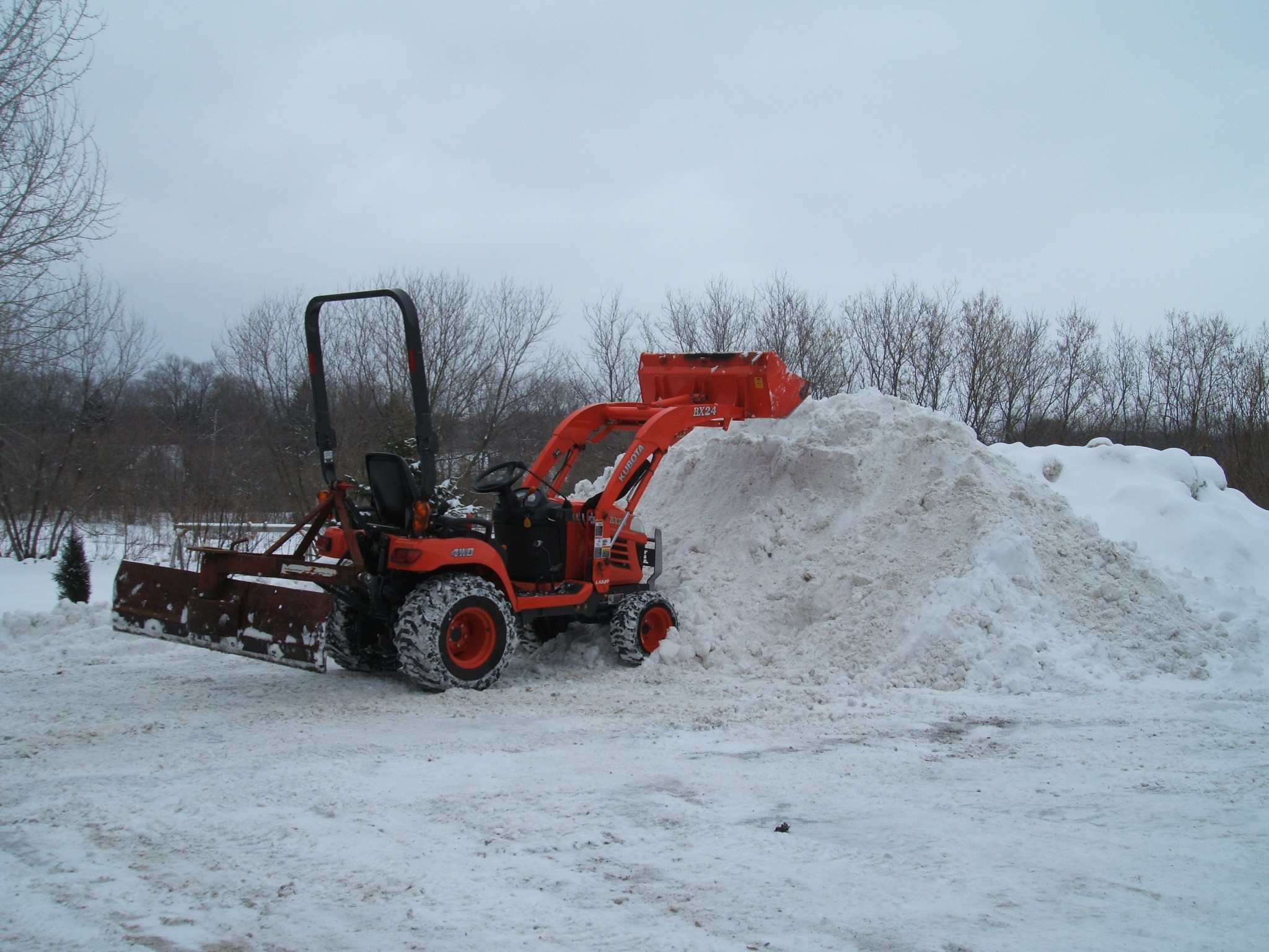

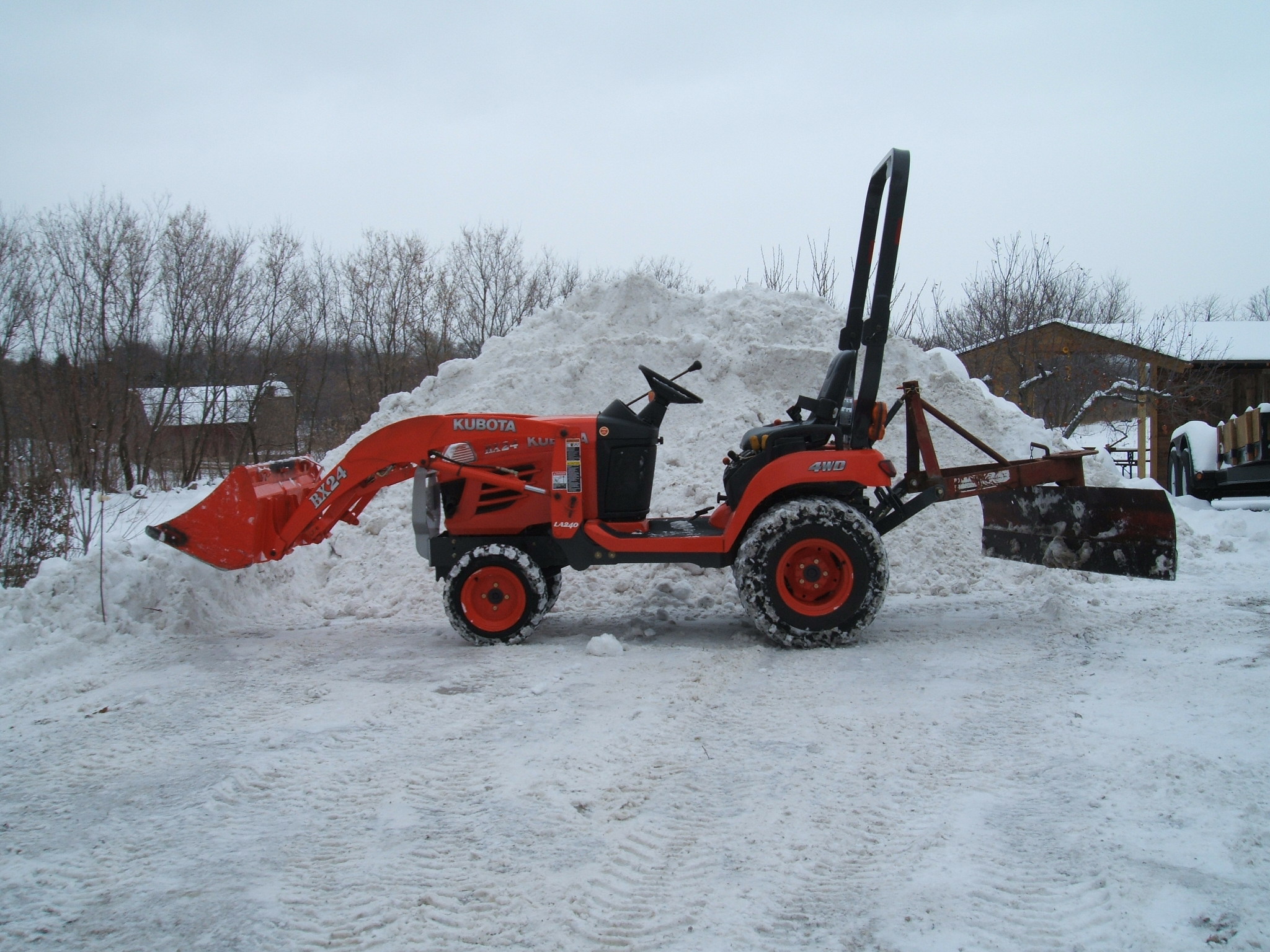

I have had no problems moving up to 12 inches of snow with my tractor. I only have a reversible rear blade and the fel. I have a gravel drive so if the ground is not frozen I pull up a lot of stone. I will pull the snow piles back onto the driveway during thaws to restore the stone.

Better get a few cans of orange spray paint and at least spray the frame of that rear blade.
Matching orange paint will net you an extra 1/2-1 hp, you know. :D

I read somewhere on TBN that guys were using a piece of PVC with a slit lengthwise to cover the bottom edge of the blade. This allows the blade to not dig into your gravel, just takes the snow. Might be worth a try. I think they were using 1 1/2" or 2" PVC for it.
My setup looks just like yours, even the same color on my BB.
