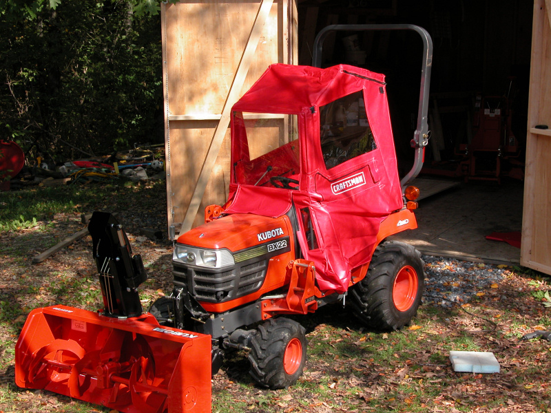

Here is the setup I have. I have 1/2 mile+ driveway, mostly level, but a blade is impractical. You will never regret a blower, although a bit expensive, but nothing stops it. I bought chains when I got the tractor in '02, but have never used them - still new in the bag. With 4WD only glaze ice would stop me.
paul
