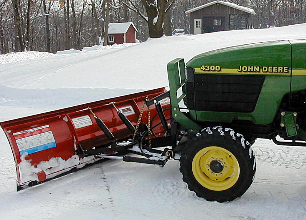

Did you see this pic of my setup? It works great, and converting quickly to the FEL is a five minute job. Both are quicktach.

beenthere,
Is that a factory available snow blade hook-up or did you rig it up to your tractor yourself? There is somebody on the forum, with a TC33 I think it was, that rigged a snowblade like yours to the front of his tractor. I'm moving snow just fine with my rear blade, but it would be nice to plow with a front blade.

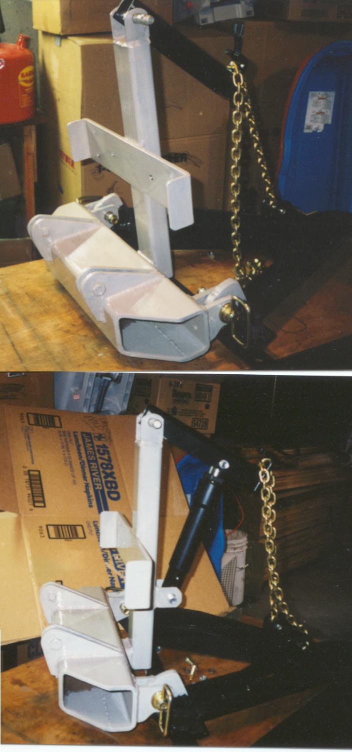

Jim That is a custom made design and fabrication that uses the belly mower plates. The quick hitch stays attached to the plow frame, and just hooks into the mower plates, tilts up and is bolted (two) to the front weight frame. Keeps the plow close to the front of the tractor for easy storage and control of the plow. Sww the pics of the hitch before painting, and with the lift bar attached.

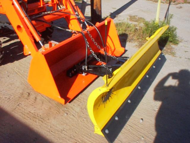

I know this is an old post and winter is almost over. I am finally getting caught up on some way over due reading and also just now getting around to becoming a member on this board, been with CTB for about a year now. Have you considered attaching a regular type snow plow blade to your front loader. I am using an old 7' fisher blade (1st year) on my 1988 JD 950 T/L/B and it works GREAT. I do have to get off and manually change the angle, but I can live with that. There are a variety of ways to attach it and for next winter I will improve on my system, but for this winter I hooked my bucket cutting edge under the plow frame ears and held it all in place with a heavy chain and a good quality chain binder. I can install it or remove it in a matter of minutes. It does work extremely well and it sure is nice Not having to rely on somebody else to plow and push my driveway back the way I like it. attached is a picture of the set up my local New Holland sets up for those who want it. It is a standard Fisher truck plow with a bracket made of angle iron that they bolt into the bucket.
