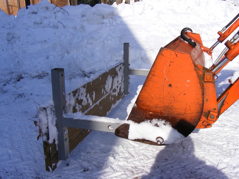

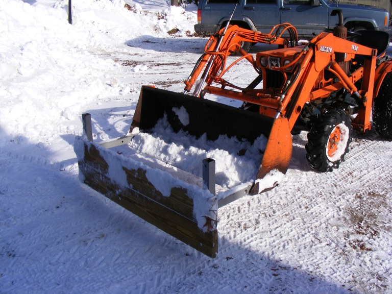

Hey guys, just wanted to add my version of a quickly built snowbank pusher that I saw on another thread. I made this out of parts from a work out bench and used 2x8 PT that I had hanging around, it took me about 90 minutes. It's about 52 inches wide and does a great job knocking down (and back) snowbanks. The 16 inch or so reach is the best. Right now it will tilt and slide right up a frozen bank with a slight tip of the bucket. This is good to push back the new snow. I may lock it down more but haven't decided yet. Works pretty well to plow the snow too.

my first thought was :eek: "what happend to the little old lady who was just sitting on that park bench??" :eek:
Looks like it works!
