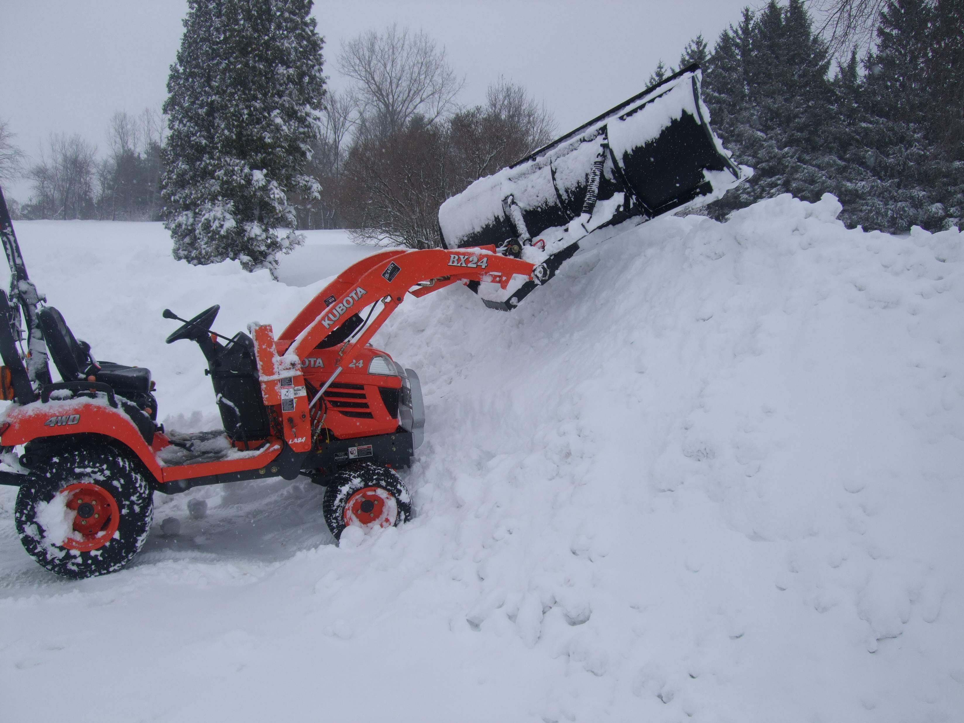

Its not that bad as you think.

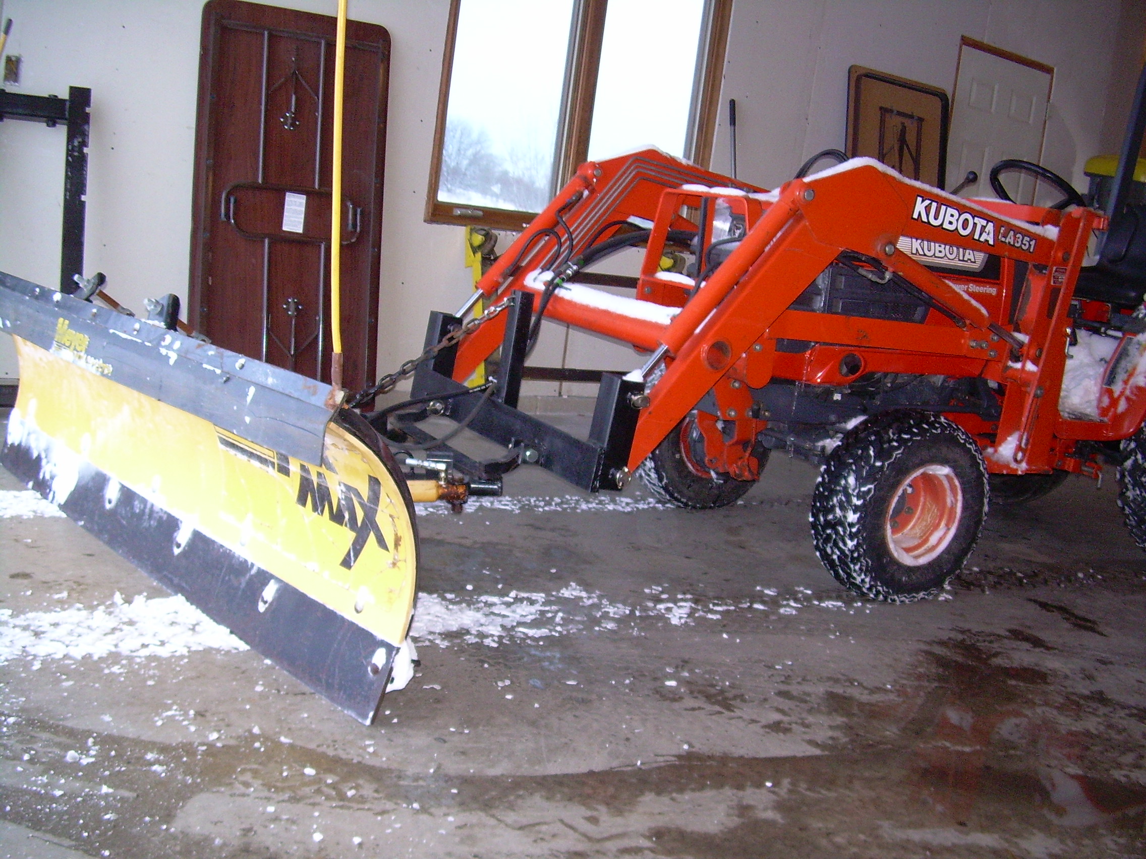

I have a CK 20 s, without chains. Would anybody recommend using a plow with this combination? My concern is that since the plow is mounted so far in front of the front wheels that it will just push the front end of the tractor all over the place.
My setup works very well, 6.5' Meyers blade with hydro-turn. Blade sticks out a bit , doesnt affect plowing ability much unless its a deep wet heavy snow, then it kicks the front over. Front tire chains can really stabilize the front end keeping it from slipping sideways.

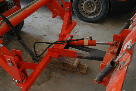

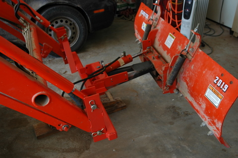

I'm thinking about a setup similar to yours. Do you have a problem with the plow digging in when it is angled? I guess what I'm asking is does your plow float laterally when angled? I currently have a similar set up but it is rigidly mounted to the FEL. When I angle the blade one side is lower than the other. Thus the plow digs in. I'm wondering if your setup solves that problem.
