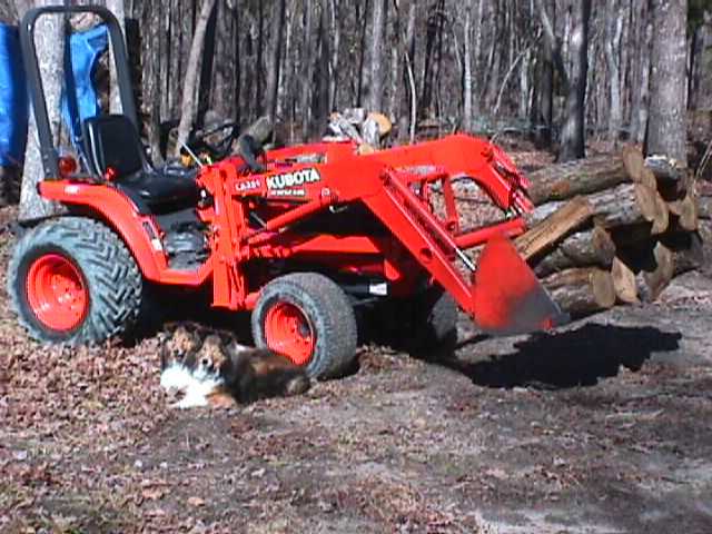

70boss, you'll love your B2400, hopefully it has a loader, that's a big plus. I've had mine for 2 years and have loved every hour(all 200). It's done everything I've asked it to do and more. We've dug gum trees out of Carolina clay, mowed 4ac fields, and front yards. Plowed 22", of our record snowfall just one year ago today, for a whole community. Turned over many piles of mulch to compost. Pulled my wife down the street on a sled, pulled 5 sleders at a time up a sleding hill(steep road).
Now, thanks to my birthday present from my wife, I'm looking to upgrade, with some regrets, to a little larger one. I've got it posted in the classifieds. I will regret to see it go.
Enjoy
gary

You sure kept the Kubota in great shape.
I bet your little buddies keep an eye on you. ]wink]
