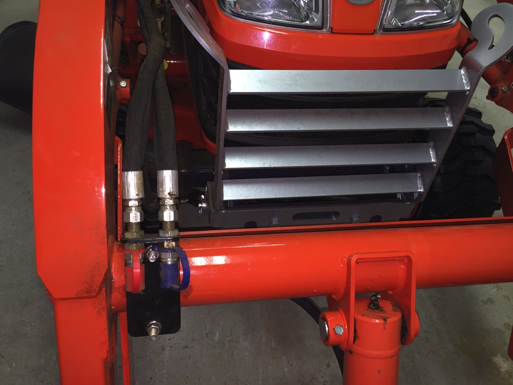

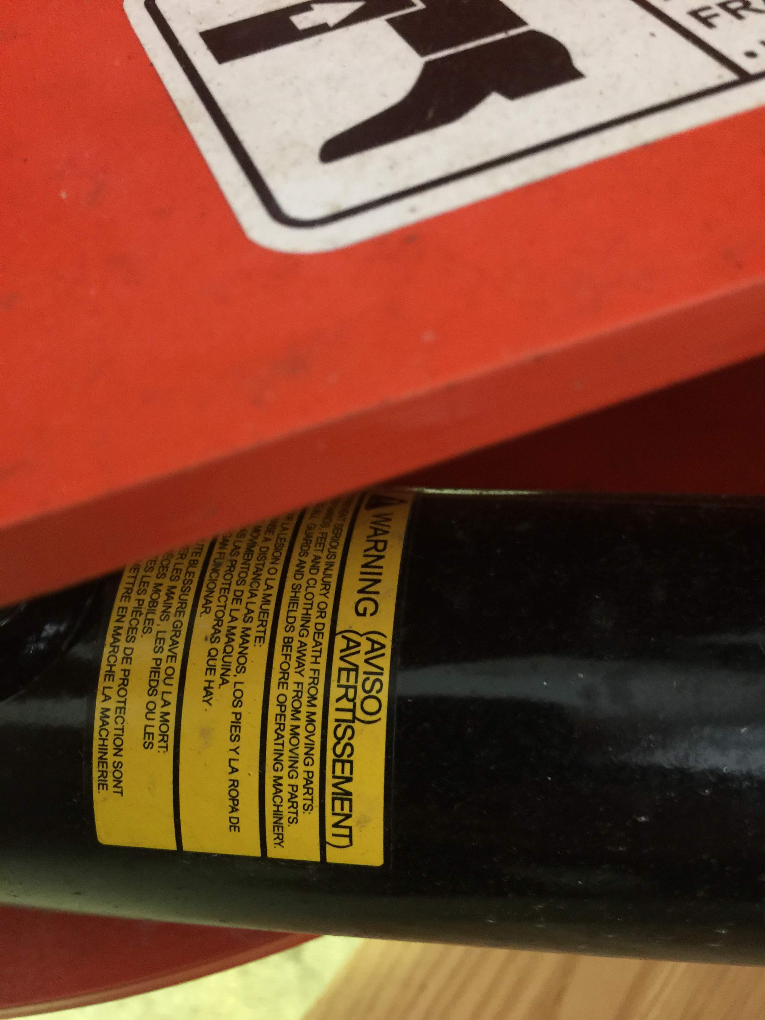

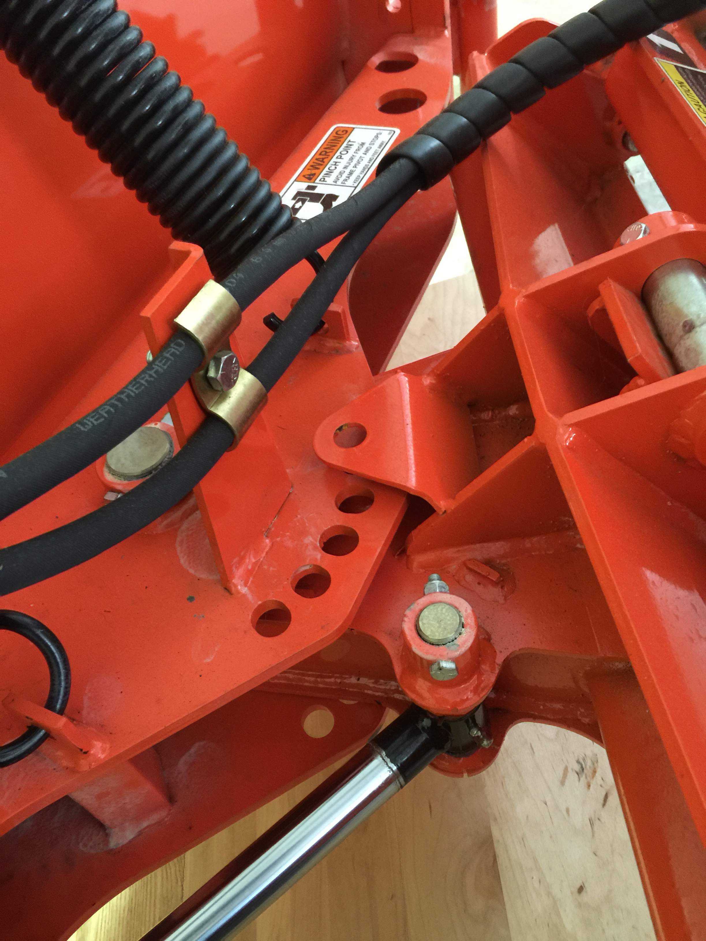

Hi all,
I had a request from Code54 so I thought I would post this here for all to see and hopefully find.
My dealer installed all of this for me at time of purchase on my BX2370-1.
I have the quick hitch with loader and plow for the quick hitch, the other plow is different and hooks up different (it requires removal of loader arms and that is not what I wanted to do), so since mine is quick to swap between the two, I use the loader arms all the time, so I we have up, down, tilt back, tilt forward.
So I wanted tilt left and right, a 3rd hydraulic option, not standard on Kubota bx, so my dealer installed the 3rd option and added a Kubota hydraulic cylinder to the plow.
So now I have up, down, tilt back, tilt forward, tilt left, tilt right.
Here are the parts breakdown
BX Third Function Valve Kit from Land Pride 380-137A
3rd Function Valve Kit please enter the part # 380-137A
I don't think you can buy this from Land Pride without being a dealer so
A google link for you or contact your dealer
Messicks.com link
I have the quick Hitch part # BX6315
The BX2767 60" Blade
Qty. 2 Kubota: GV 1/4"" PLUG, D Blue
Qty. 2 Kubota: GV 1/4"" CAP, DU Blue
Qty. 2 Kubota: GV 1/4"" PLUG, D Red
Qty. 2 Kubota: GV 1/4"" CAP, DU Red
If you take your loader off you will need 4 each of the caps
The Hydraulic Angling kit part # B2671 , this is a call to your dealer, I can not find any reference to it online.
B2671 Hydraulic Manual
3rd function manual
Pictures

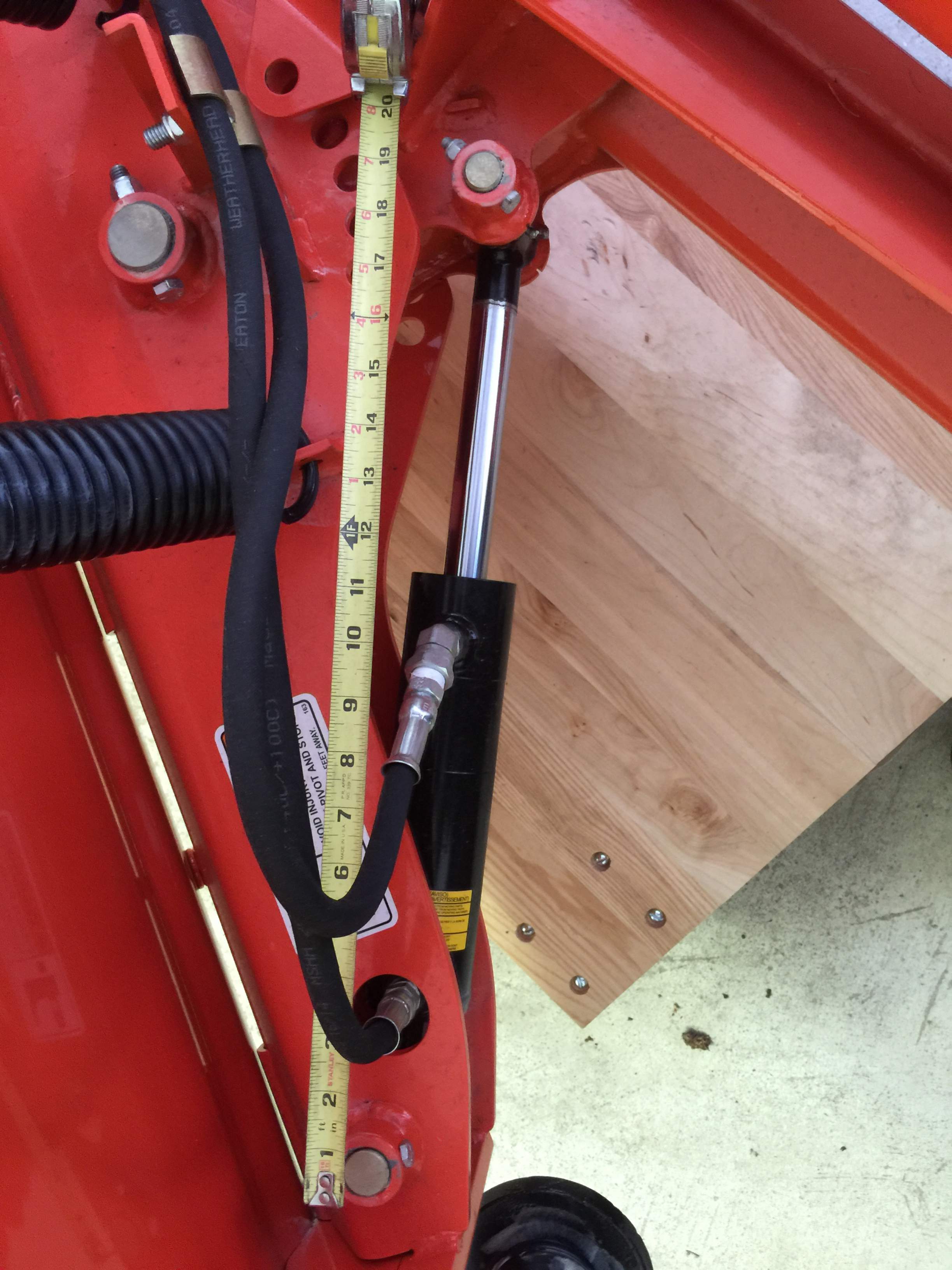

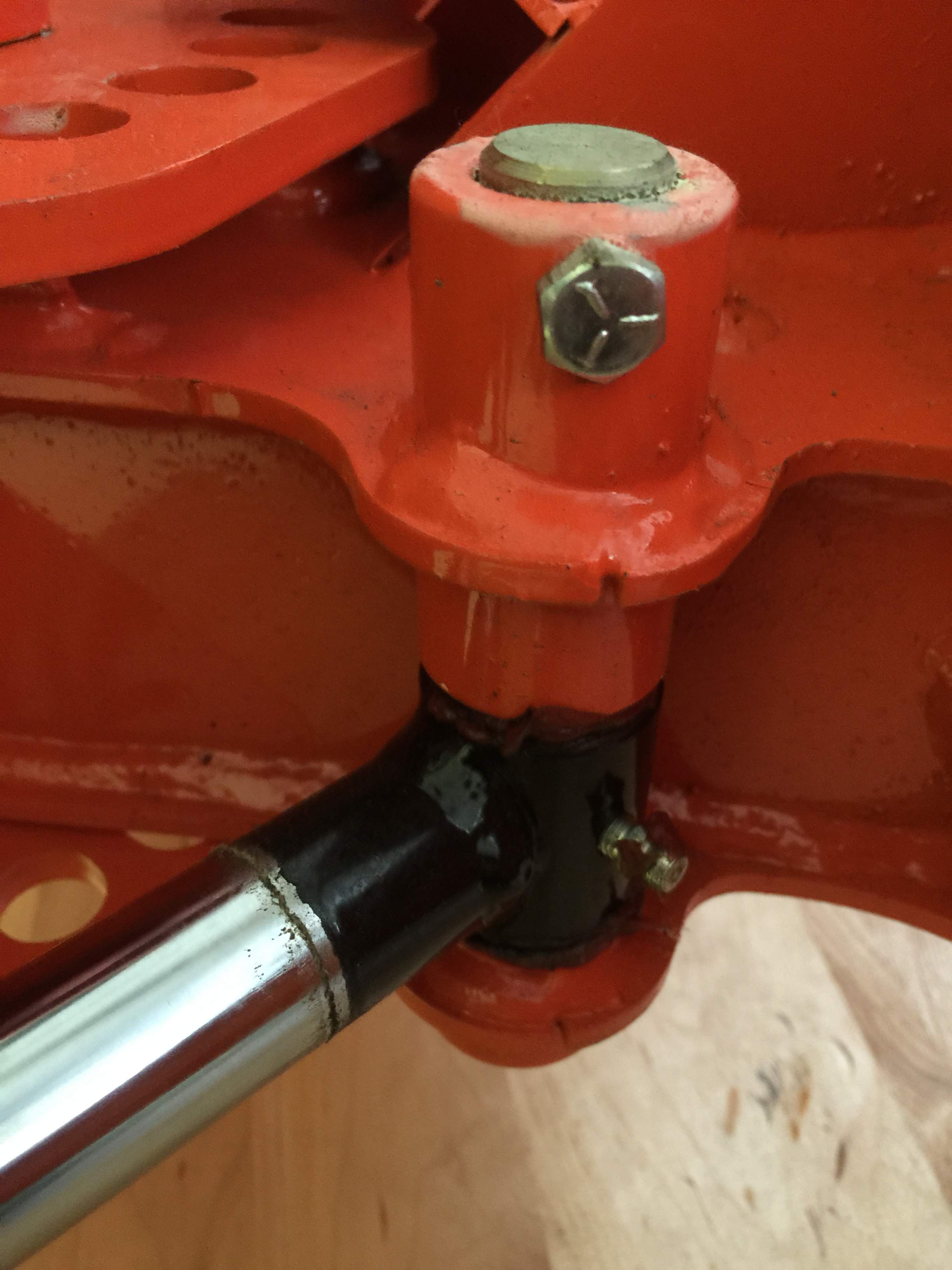

I'd like to add this to my blade (I already have the diverter for my grapple) so I am looking for just the 2x6-1-2 cylinder. Kubota wants somewhere close to $500 for the B2671 kit (even more than that for just the cylinder!)
Anyone find a 2x6-1/2 cylinder?
2x6 seem to be widely available. If I go with a 2x6 how much would it limit the L-R movement?

I can put my blade on and take measurements at left and right if needed, just let me know. I don't know much about cylinders.
   / Snow Plow with 3rd Attachment BX2370-1 #8
Yes, please. Any dimensions you could provide would be helpful. Thanks.
#9
Here are some pictures, the measurements in the picture are deceiving a little, must be due to camera, iPhone 6+ or even any camera due to the angle.
from center of piston holder to center of the opposite side
closed is 13"
open is 19"
2015-09-13 10.13.15.jpg2015-09-13 10.15.01.jpg2015-09-13 10.16.29.jpg2015-09-13 10.16.57.jpg2015-09-13 10.17.17.jpg2015-09-13 10.17.33.jpg2015-09-13 10.17.47.jpg
Anything else please ask.
