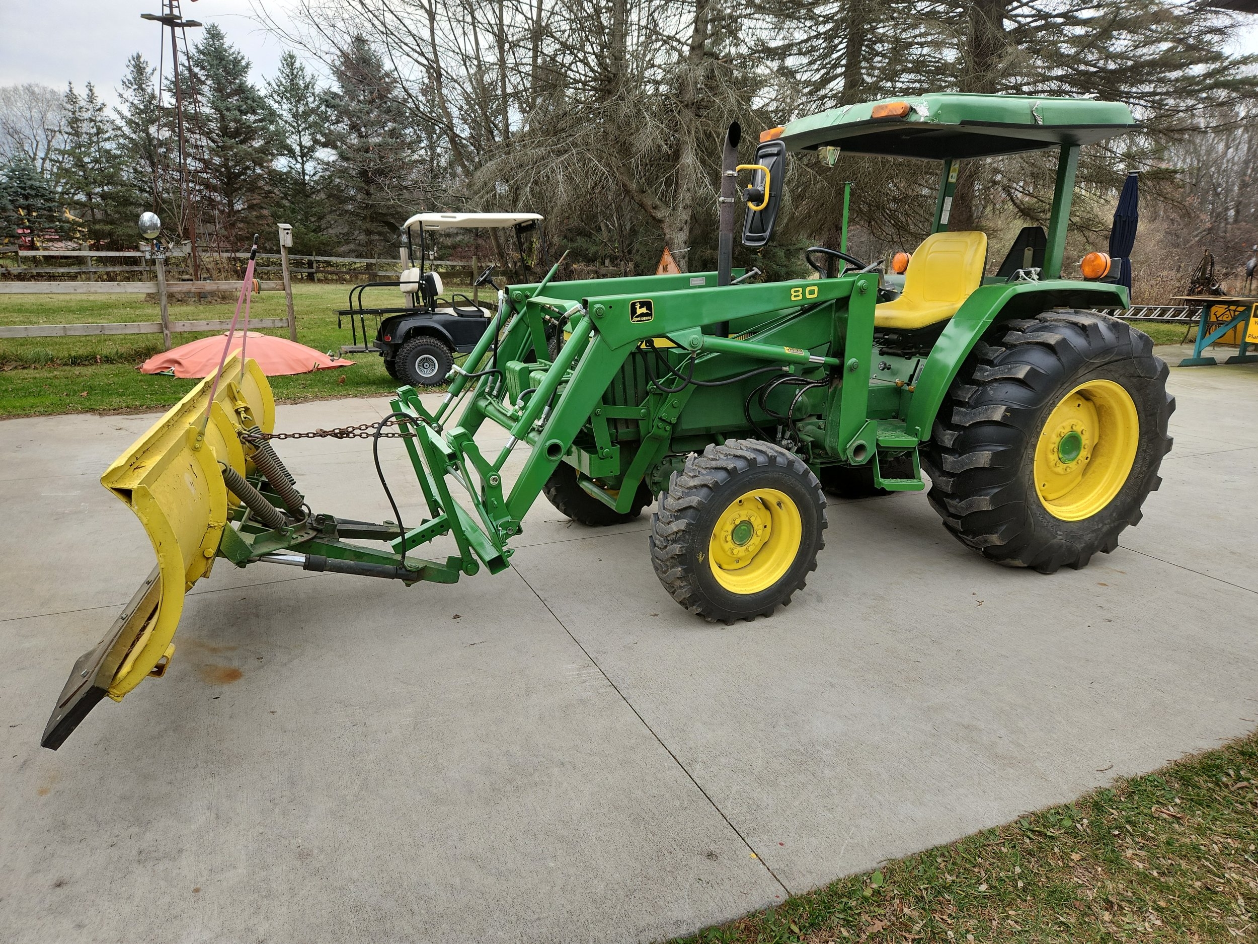

Plow a long driveway if you have room to accumulate the snowbanks for the amount of snow you expect over the season, and drifting across those snowbanks will not be a problem. Blow the snow if you don't have room for banks, or drifting will be a problem. Pushing snow with a bucket assures banks, and is a poor idea for a long driveway.
Some front end loader frames are suited for pushing a blade, others not so much. Don't wreck a less "pushworthy" loader using it other than the manufacturer intended. If you decide to push with a loader, make sure it's got a good float setting, and the blade is correctly angled and has shoes to float well. Buckets are poor for this, as it is not an intended design feature. If the bucket digs in (or blade set wrong, and digs in) it may buckle the loader frame enough to lift the front wheels, and steering is difficult.
My ideal set up, having been doing it various ways for 30 years for a 700 foot sheltered driveway in central Ontario, is now a quick attach blade on the front end loader (which is designed for it), which I can swap quickly to a bucket, and a rear mount blower on a hydrostat tractor.
I can quickly plow, blow the banks or windrows, and change to a bucket if I need to scoop out.
Neck strain notwithstanding, rear blowers are fine with a hi/low hydrostatic transmission. They are not so great with manual transmission; you usually cannot blow in reverse hi, so you're limited to reverse low, which is slow for blowing - 'works, just takes time... When I had the previous manual transmission tractor, I adapted my blower to the front end loader, in place of the bucket (but a slow changeover). Easy on my neck, and eight possible forward speeds, rather than two possible rear speeds. It was complex, and slow to change, but worked well, but with my new hydrostat tractor, front blade, rear blower works best.
