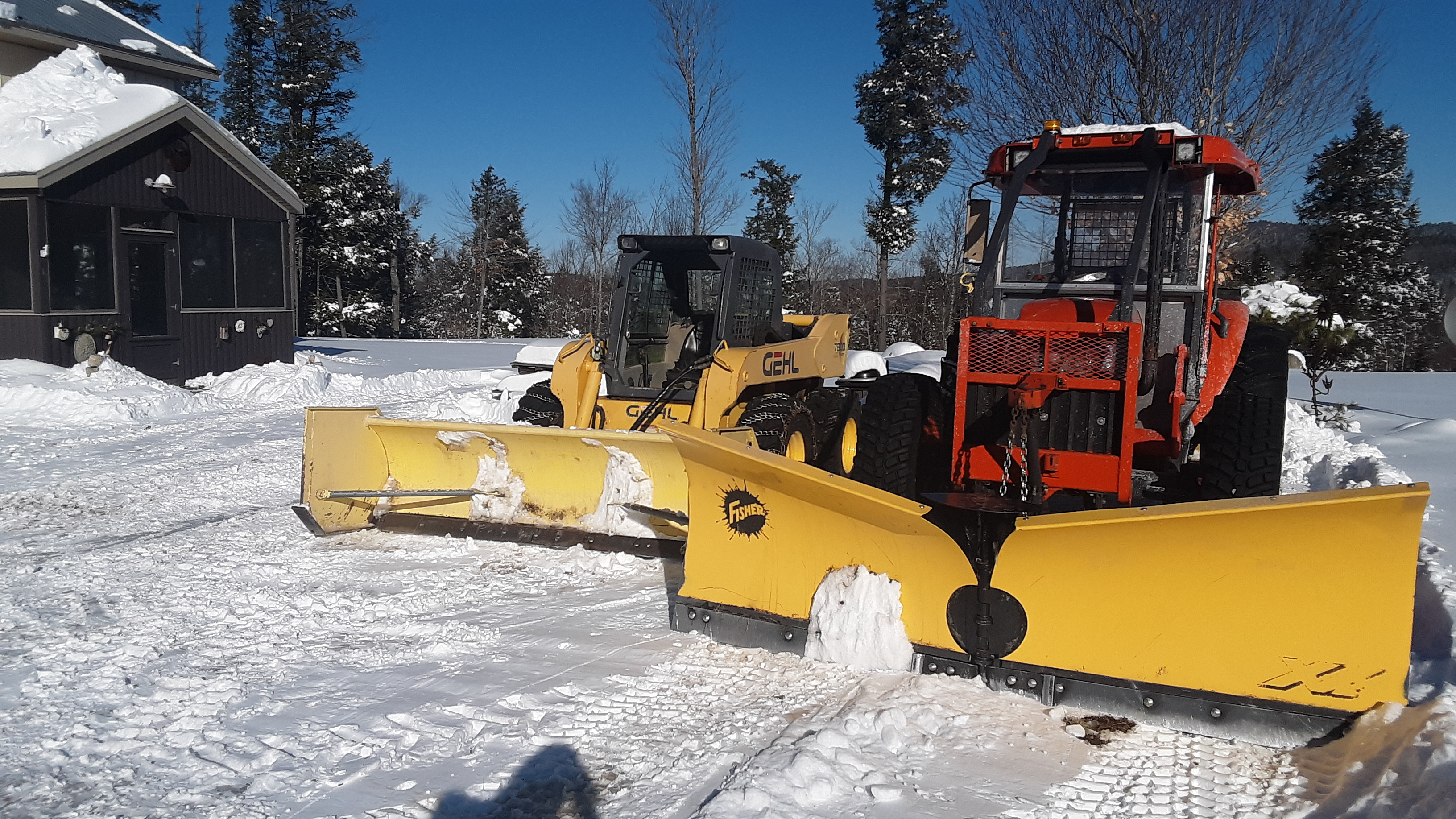

I run an 8 foot Fisher on an SSQA mount. It is power angling by using the third function. It is floated with chains. That keeps the weight of the loader arms on the front wheels. The rear tires are loaded and this year I hung a 50 gallon drum poured full of concrete on the three point. Tested it last week with heavy snow and it worked well.
