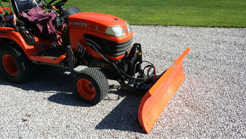

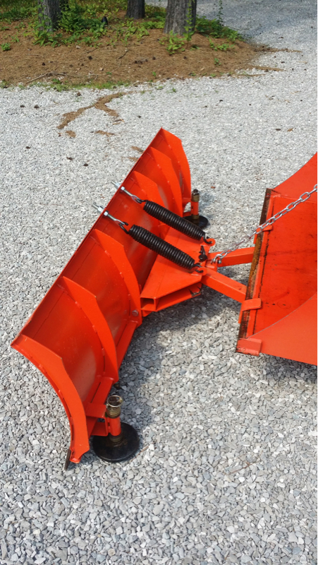

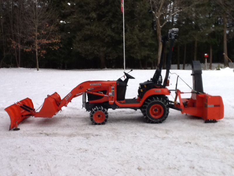

I have a BX25 and had a BXpanded 60" front blade that clamps on the front bucket. It's very well made and costs considerably less. I used it for two winters and found it to work great as long as you are plowing in a straight line. The downfall is the blade is a long way out in front of the tractor and makes it very difficult to plow and turn at the same time. It's great though if you want to push the snow into a high pile or need to use your bucket, the plow comes off quickly.
I decided to sell mine and have gone for the Kubota full hydraulic plow and quick hitch system. Looking forward to using it.

Priced a BX2763 60" front blade and 2751 QuickHitch. Yeeeeow!! $2500. So, what do you all recommend? A blade that replaces the bucket? Talk me through this. You need to knock out the bucket pins? How difficult is that? Do the various plow attachment merely pin on, or do some have a hydraulic function to tilt the blade? I'm guessing that tilt function raises the cost dearly. If the cost of such a FEL arm blade pushes $2000, then I may as well bite the bullet for the frame mount Kubota version. Snow is coming and I'm pretty weary of the FEL bucket and rear blade method.
I have that exact setup, and so far I like it after one winter. Plowing my paved driveway takes only a few passes, so I don't mind manually adjusting the angle. I've tried plowing the stone road, and that works well also, until I try to go uphill...need some weight in the tires, and possibly chains.
The quick hitch pins on in 10-15 mins...very easy to do.
I thought about the belly mount, but didn't like the idea of losing my loader during the winter. While my setup isn't ideal, it allows me to quickly change from bucket to blade. Also, you can raise the blade as high as you want to push snow banks.
