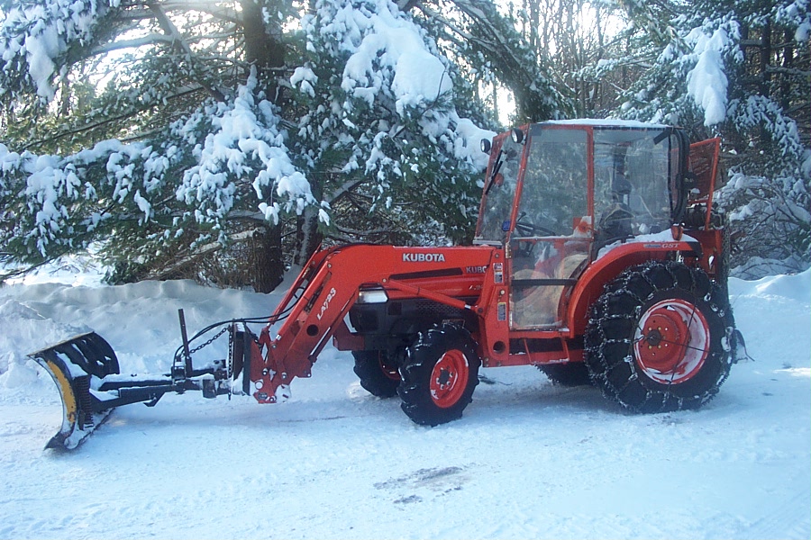

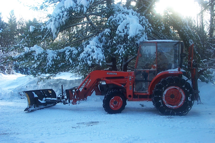

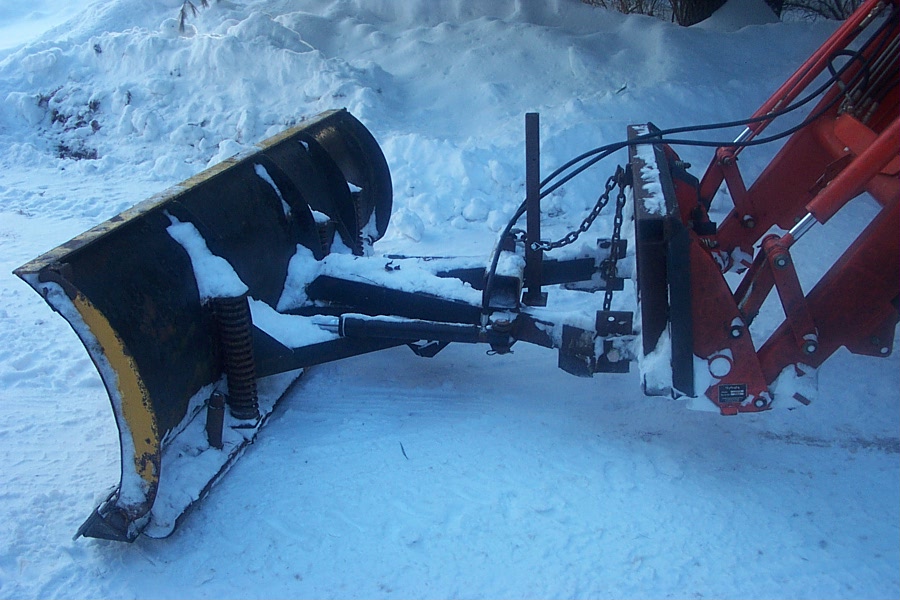

Mark, take a look at these pics. Sometimes you can find an old truck plow for almost nothing. I have the bobcat quikattach on my FEL and the plow is 7-1/2ft. Shorter plows can be found.

   / Snow plow on FEL of my Kubota for woods
Nice setup. What does a quick attach setup like that cost? What hydrauilcs are you using to angle the plow left and right? I could make up some removeable shoes to keep the edge up off the ground and let it float. Take the shoes off and do my drive.

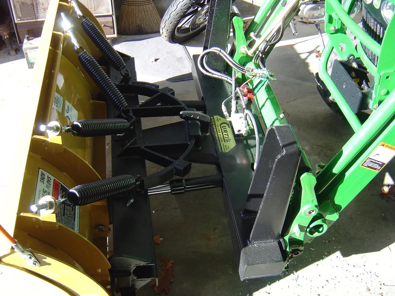

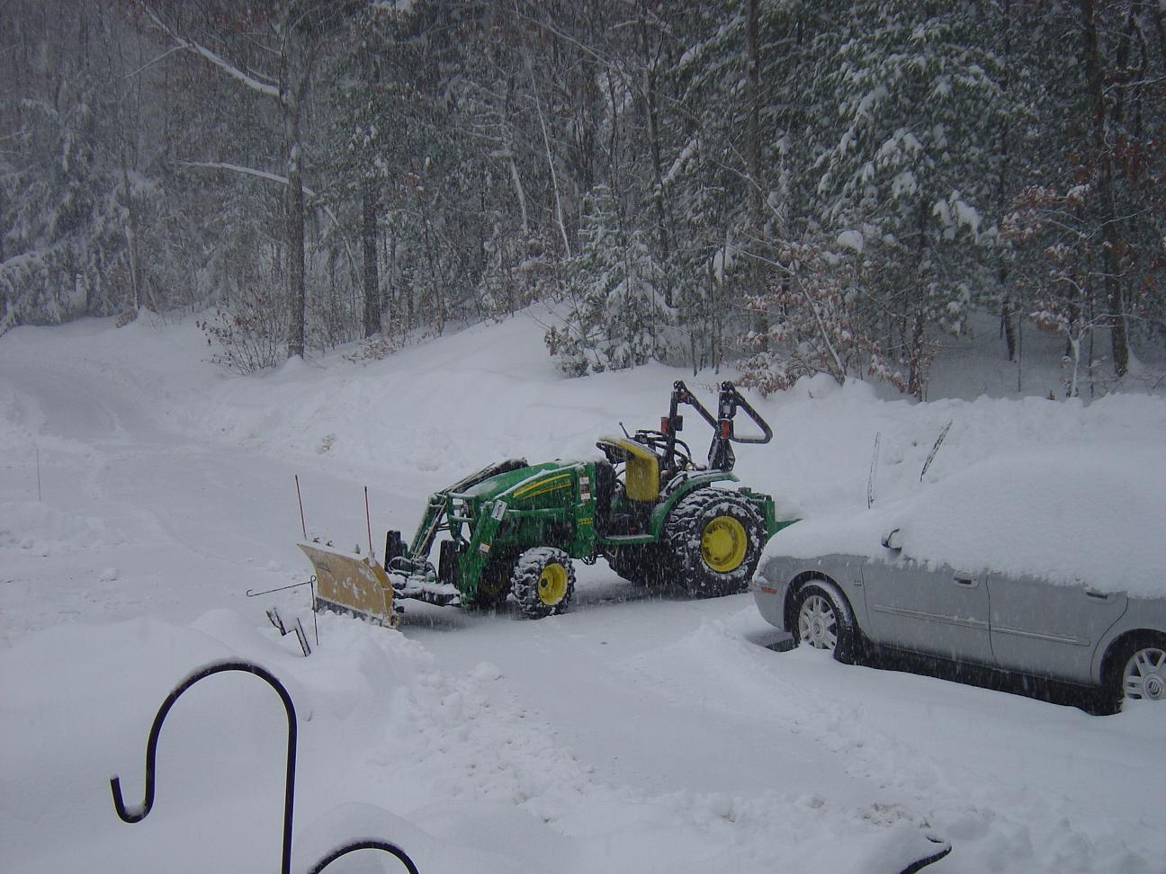

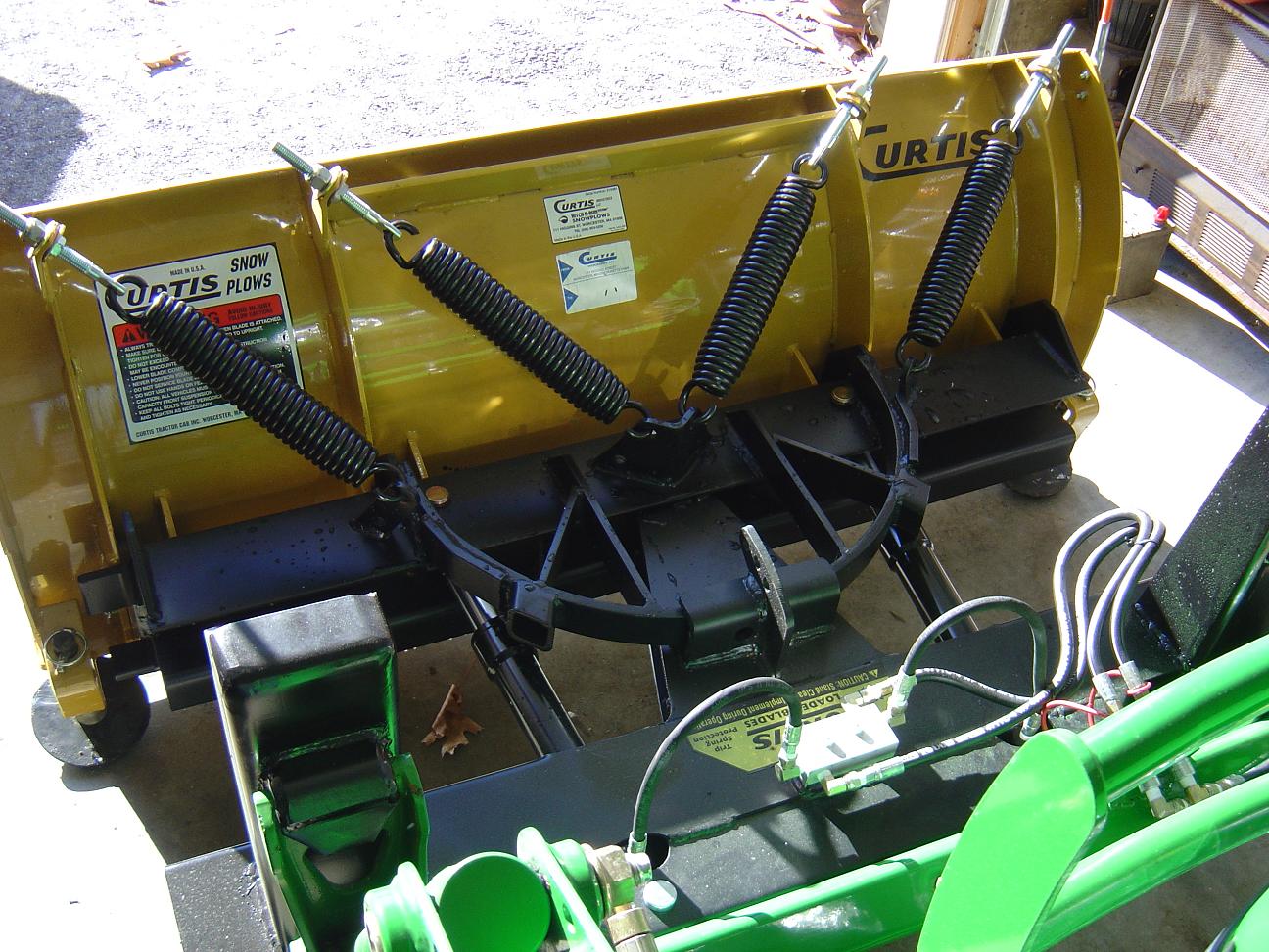

Hiya,
Here's what I use, it's a Curtis on a small JD. For the dirt road I put the skid shoes all the way down, set the loader on float and it doesn't catch on much. It's good in powder to medium weight stuff, if I get a foot or so of heavy stuff, it gets pushed around a bit. I just take it off float, load the front more and I get my steering back. A bit over 2K for my setup this past summer.
They come in different widths from 5 to 9 feet I think. It's a rugged setup, heavy and strong.
My 2 cents
Tom
