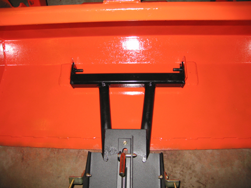

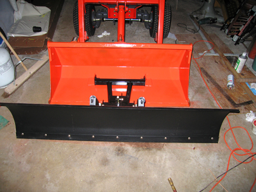

This is a 5' Cycle Country plow that I attached to the bucket of my BX2200. I cut the push tube and welded on a 2" sq tube. I then welded tabs made out of 1/4' stock to the ends of the sq tubing. The brackets in the bucket are 2.5" angle iron. It's very fast to install and remove in case I have to pile up snow with the loader. Now I just need some snow to try it!

Is that FEL 3 feet wide ? and how much $$ was that set up?
   / Snow plow on BX2200
The plow and push tube was about $325 and the steel to fabricate was around $20. The FEL is 4' wide, the picture is deceiving. When the plow is angled it is about 2" wider on either side then the FEL. I installed another light on top of the brush guard to replace the useless headlights, also. Now I'm making the framework for the golf cart cab cover like NY Yankees Fan installed on his a few years ago. I also have a thick rubber mat, that is used in horse stalls, that I am going to cut a strip out of for use as the cutting edge on the plow. I'll sandwich it between the plow and the steel cutting edge to help protct my driveway.
