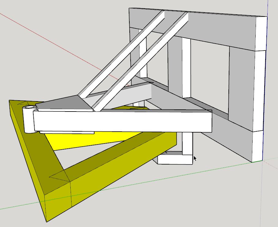

Hey there - I'm pretty sure the blade is a Fisher. It's old and very very used with no markings. It's an edge trip that compresses the springs on the back - as opposed to a full blade trip that stretches the springs.
Below is what I'm thinking I'll weld up. The yellow part already exists on the back of the blade. The rest is the a-frame to quick attach plate I'll put together. I didn't draw the hydraulics. Thoughts?

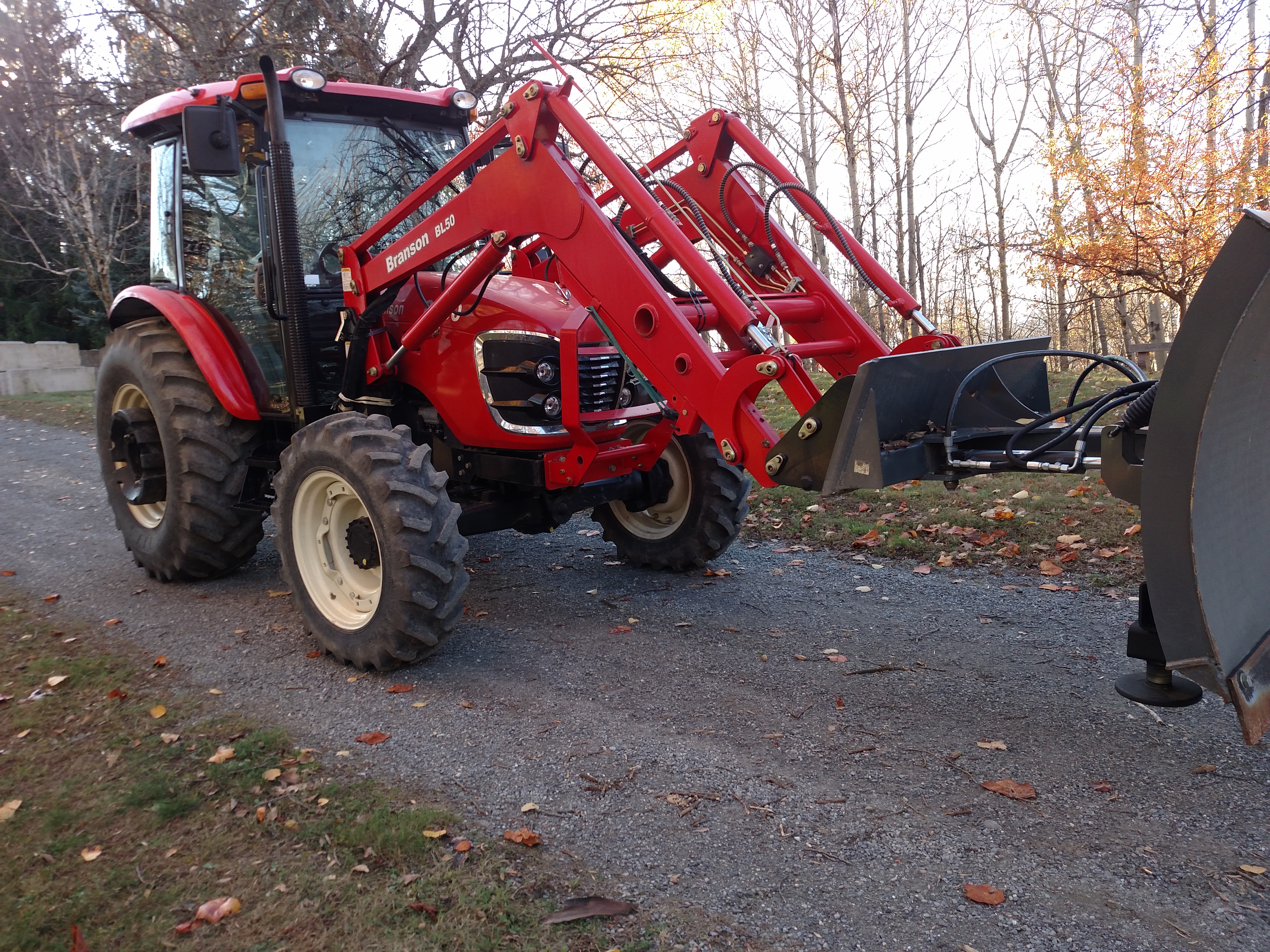

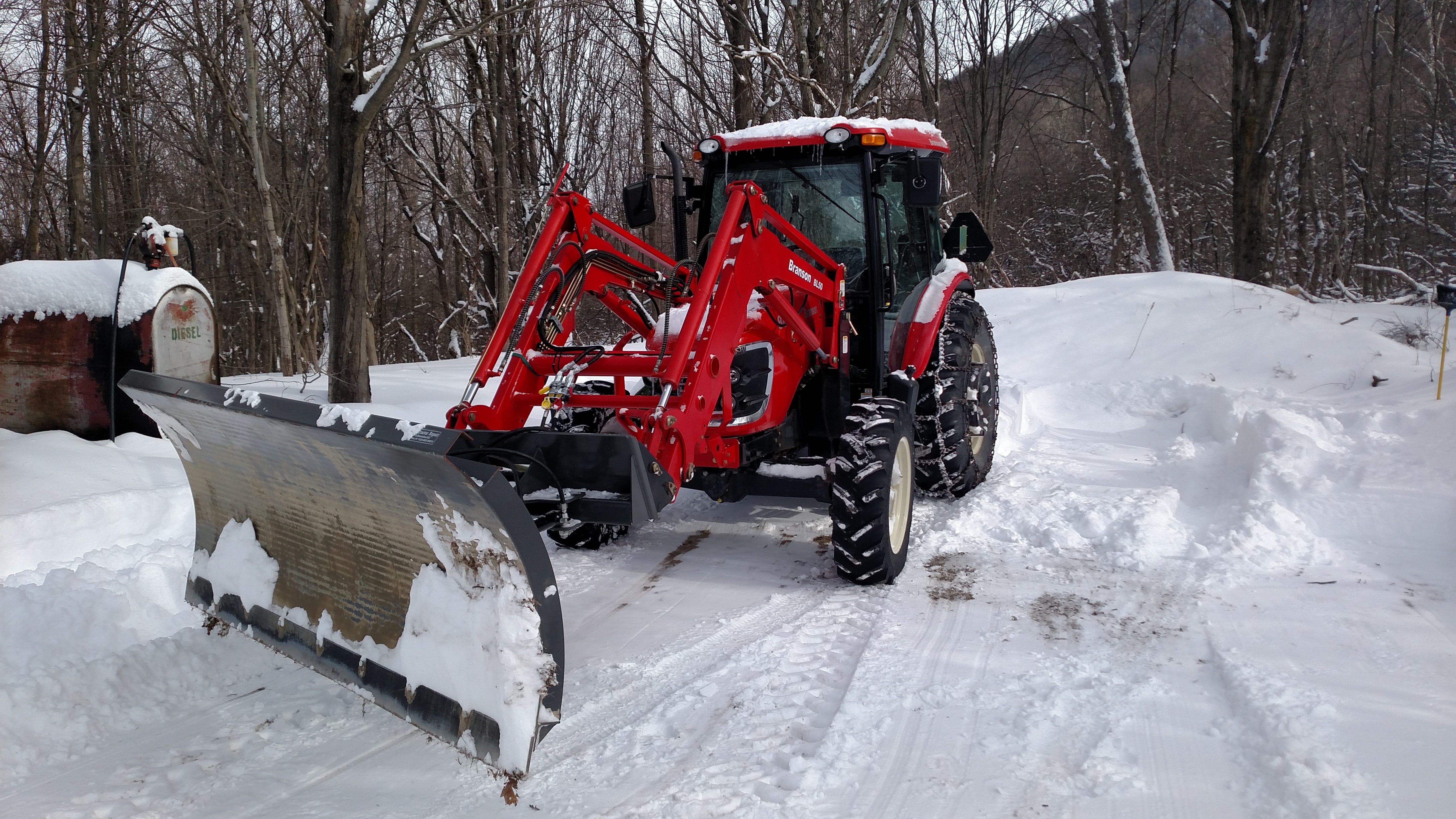

It seems that the people that have the best results are under slinging the framework to keep it as short as possible and using a chain for the top support so the blade can float, I have a commercial blade built similar to your design and I have to carry the loader and let the blade float on what little slop it has.
   / Snow plow hydraulics for tractor - questions #9
In these pics you can see how far out from the tractor the blade sits.
With it so far forward any up or down movement of the front tires really translates to a lot of blade movement.
   / Snow plow hydraulics for tractor - questions #10
Here was my snowplow build that may help you:
https://www.tractorbynet.com/forums/snow-removal/254357-ssqa-fel-snowplow-build.html?highlight=snow
All I can say is do NOT hard mount it to the FEL and think you are going to successfully float the FEL to float the blade. there is too much weight on it, so it catches and raises your front wheels off the ground a lot. It just does not work. The best way is to hang the blade from a chain like the truck plows do, and then you are just floating the blade.
I used a diverter, which worked quite well. Plumbed it into the curl/dump circuit, so I can either curl or use the third function at any one time.
