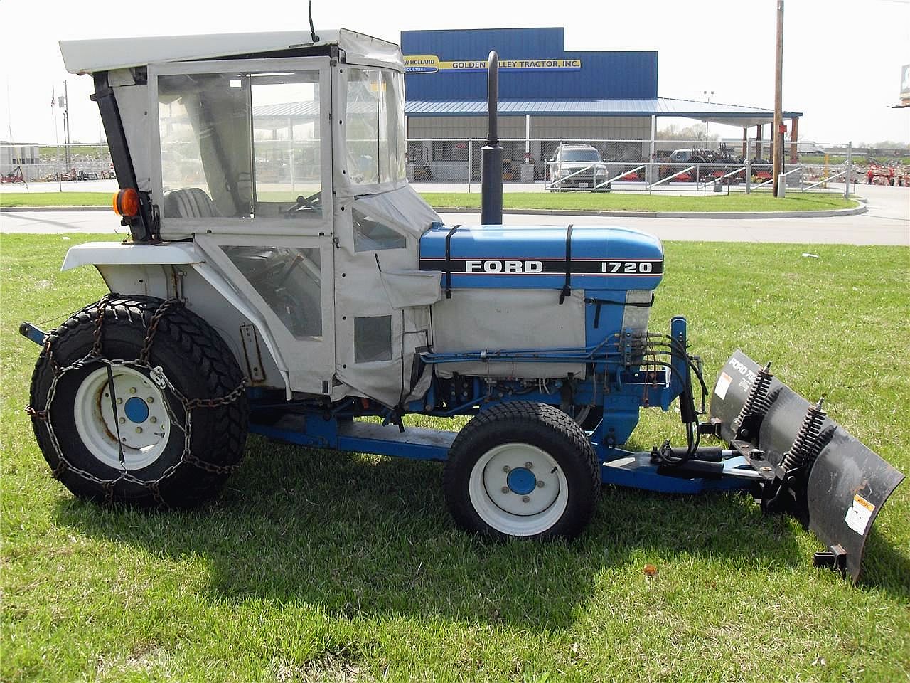

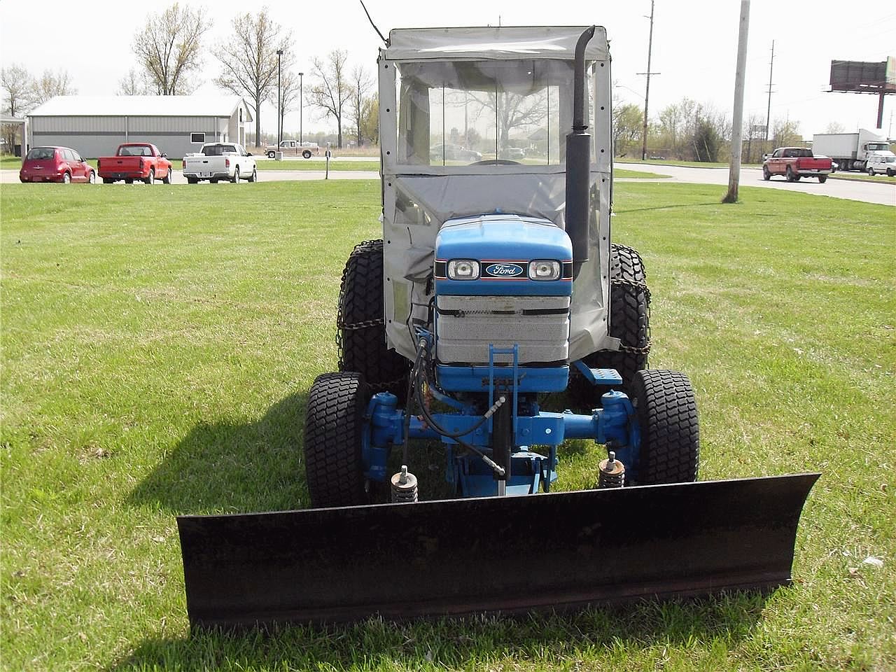

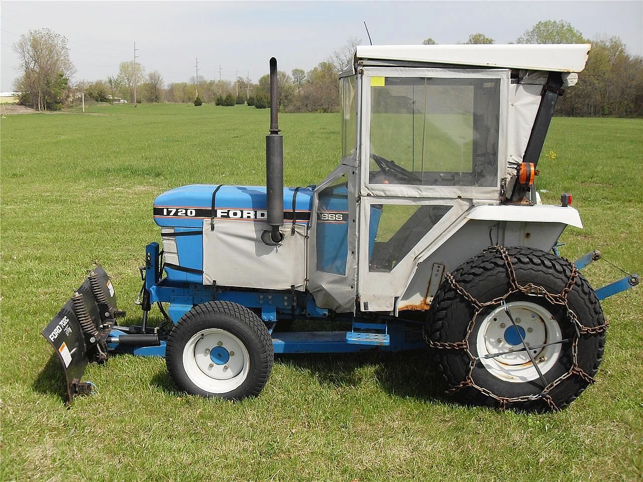

   / Snow plow for Ford 1720 #6
Ford made a front mounted plow for these tractors. They had a sub-frame underneath and hydraulics up front for raising and lowering the blade as well as pivoting the angle. Here are a couple photos of one I came across. Good luck with your project!
