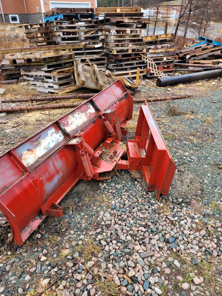

Jan 9, 2022 / Snow Plow Blade #1 S sailorman3 Bronze Member Joined Jun 21, 2014 Messages 77 Location Newfoundland Tractor Kioti CK3510 What is the widest snow plow blade to install on a CK3510?

Jan 10, 2022 / Snow Plow Blade Thread Starter #4 OP S sailorman3 Bronze Member Joined Jun 21, 2014 Messages 77 Location Newfoundland Tractor Kioti CK3510 After looking at the blade, I think it is way to bug for my application. The price was right at $800 but it will be to heavy.
