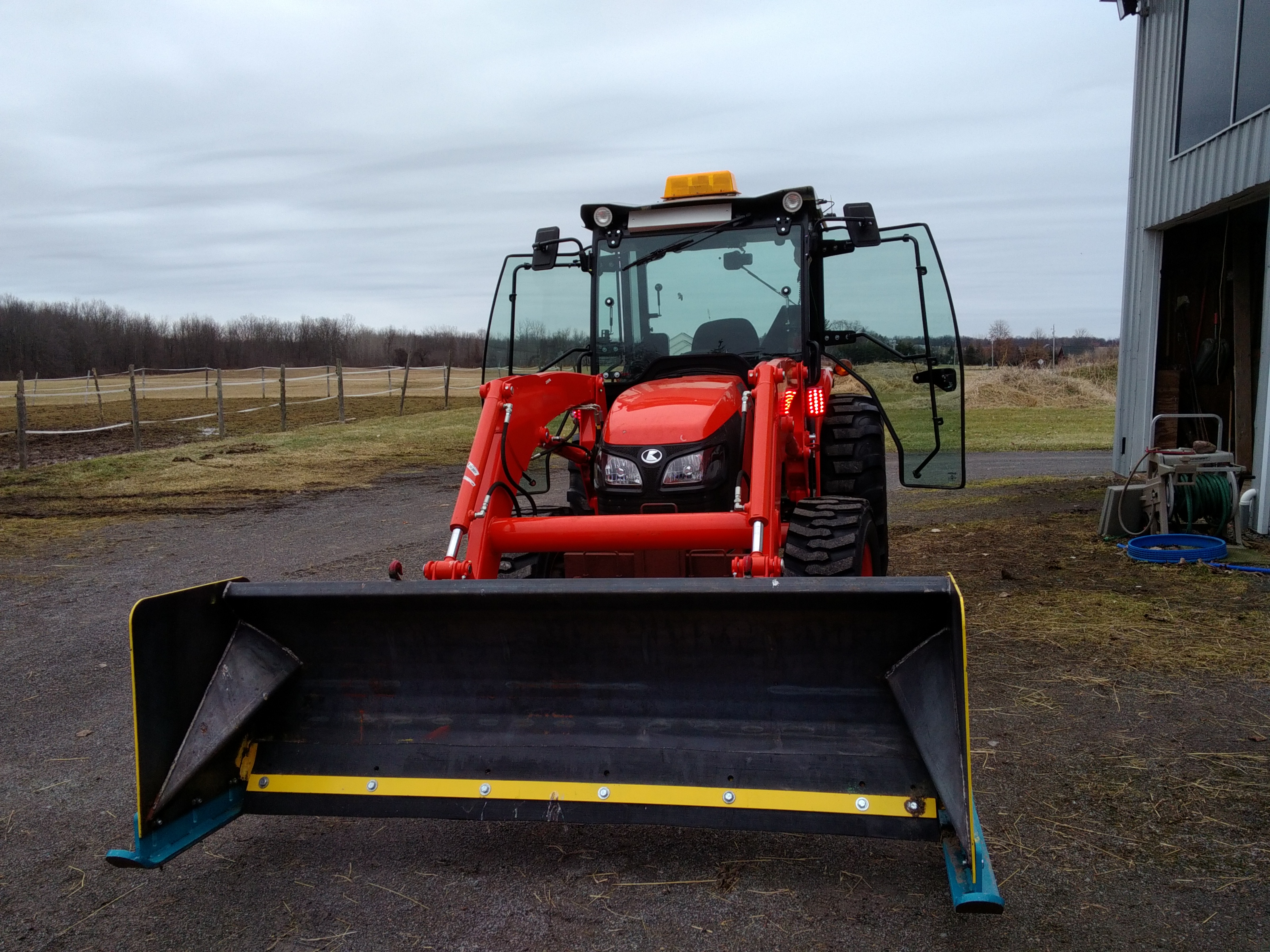

I use a snow pusher on FEL because it contains the snow instead of just pushing it to the side. Bonus, no hydraulics necessary. Rubber cutting edge easy on driveway surface. Also works better than box scraper for grading stone.
Nelson has a valid point in post below. Counteractive forces do actually attempt to rotate the tractor when blade is severely angled. That is why the straight-on motion of a snow pusher is more uniform in resistance, not much different than the typical bucket w/o a bottom.
Since there is no frame in conventional sense, on a CUT, the so called bumper may be unable to withstand the lateral force. I used this system in the 90's. Frozen side banks of snow turned to ice, snow mix, did bend the mold board, presumed the bumper would be next. Discontinued use.

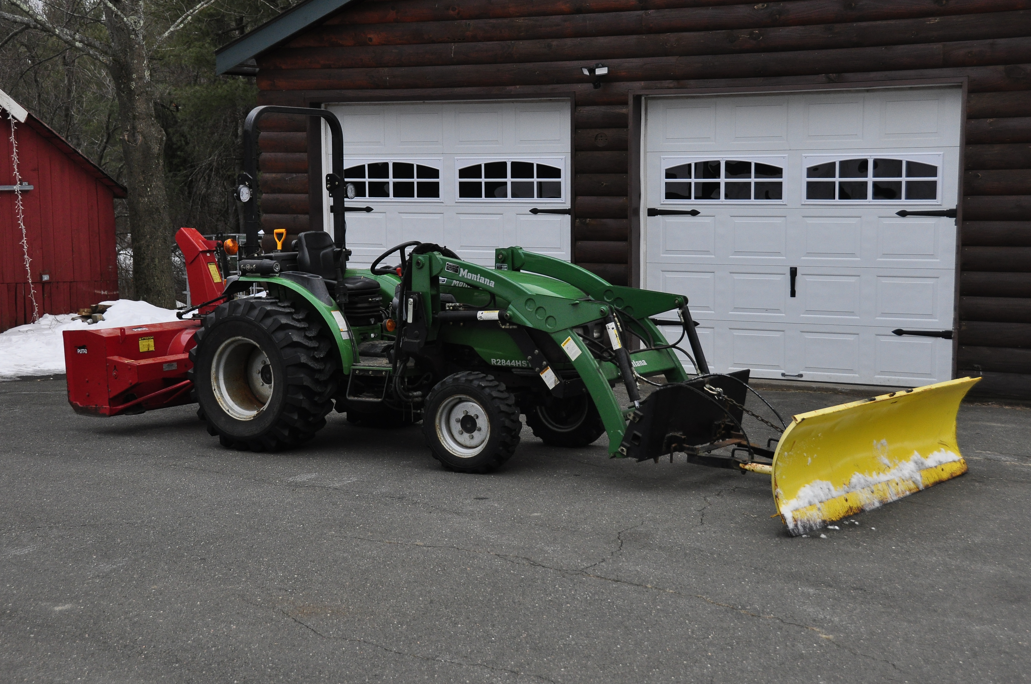

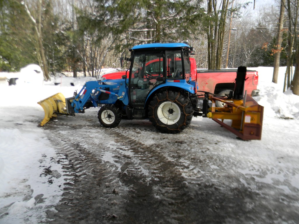

I adapted a Diamond 7 1/2' truck plow to a QA plate and use one set of rear remotes to angle it. It works fine. Also have a double auger 7' 3 pt blower when I need to blow the piles away.
