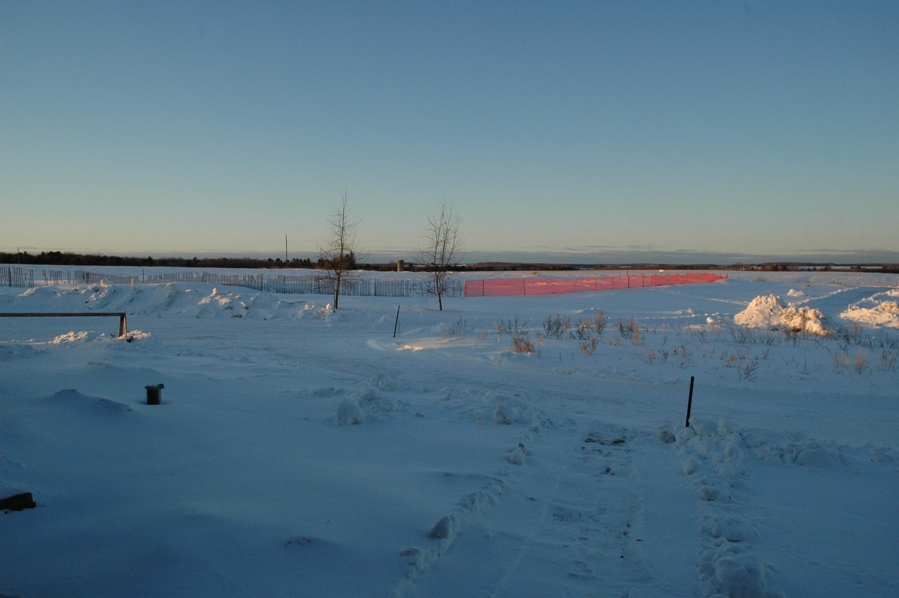

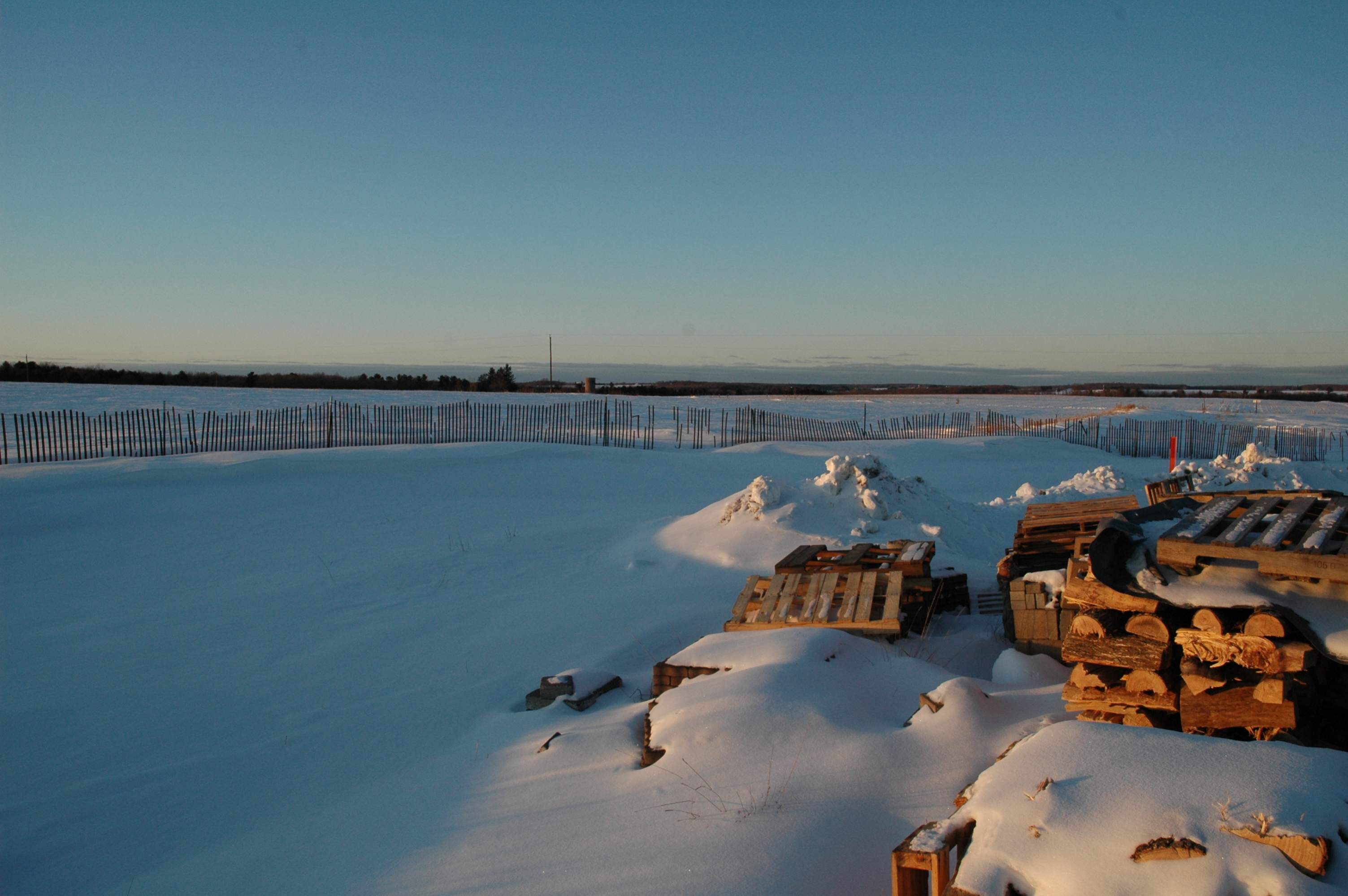

I'm currently using three different types of snow fence. I have several old rolls of the wood & wire fence that my dad no longer needs (they spend winters in Arizona) that gets the job done, but it is heavy and the wood is getting weaker every year. Each time I put it up, I probably "lose" ten or fifteen feet of fence that just isn't worth keeping and gets cut off the ends of the rolls. I also have a hundred foot roll of some fence that is basically a half-inch grid of knotted string/twine. And a hundred foot roll of the plastic stuff that is frequently used to barricade construction sites. All seem to do a decent job of making the snow drop at the fence rather than my driveway. About 60' off the driveway is close enough for me to not have "redrifting" downwind of the fence, but far enough away that the drifts won't reach the drive. By the middle of January last winter, this fence was actually completely buried in the drifts over some sections.
